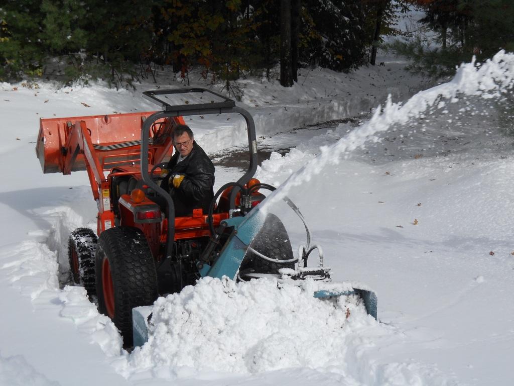

My blower rarely if ever boggs down my tractor - 6' Econor on an L4200. OTOH, I have 45HP at my disposal, and I don't think many blowers can transfer half that power before breaking shear pins. I run full PTO speed (2600 RPM) at all times when blowing snow, and adjust ground speed typically based on keeping the right amount of snow piled up in front of my blower.
Now there's something you don't see very often... chains on the front tires only. What's the scoop?
   / Lugging her down #8
THE hot lick for steering.

I also have chains on the front tires. When plowing snow, the fronst loose traction, so I put a cheap pair of lawn tractor chains on front. What a difference now in steering on hard pack snow and ice. I actually go where I want to.
