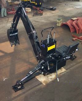

Anybody have any experience with one of these? I'm looking for a inexpensive backhoe and have seen these on a few sites. I was thinking I would fabricate a sub frame for one being that they are 3-point. If any dealers have any in stock let me know.

Jim, I have one on my TaskMaster 432 and it works like a charm. I've only dug a few holes with it, but I can tell you, it is very responsive, so much so I find I have to keep telling my self to be light on the touch. /forums/images/graemlins/grin.gif

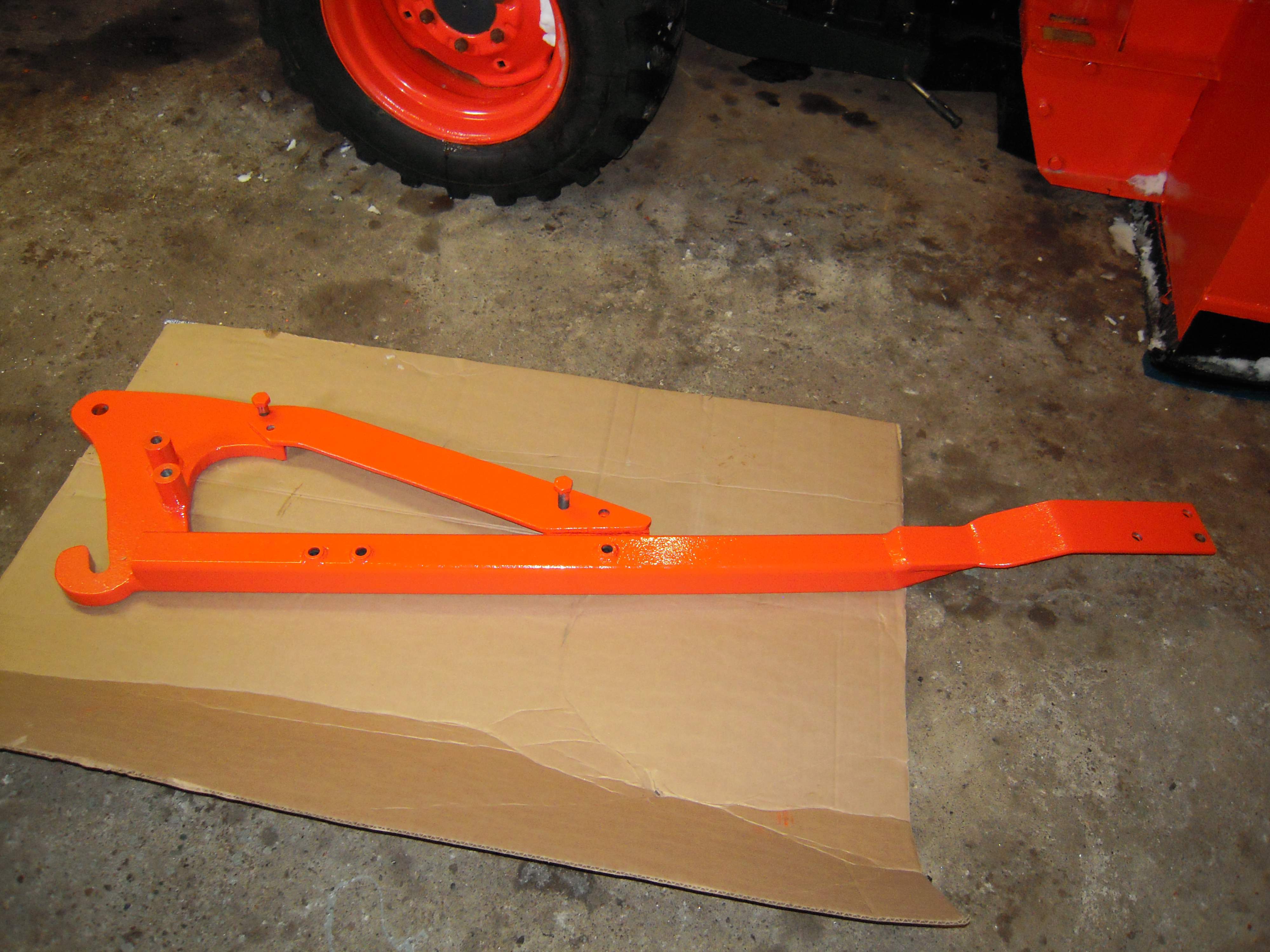

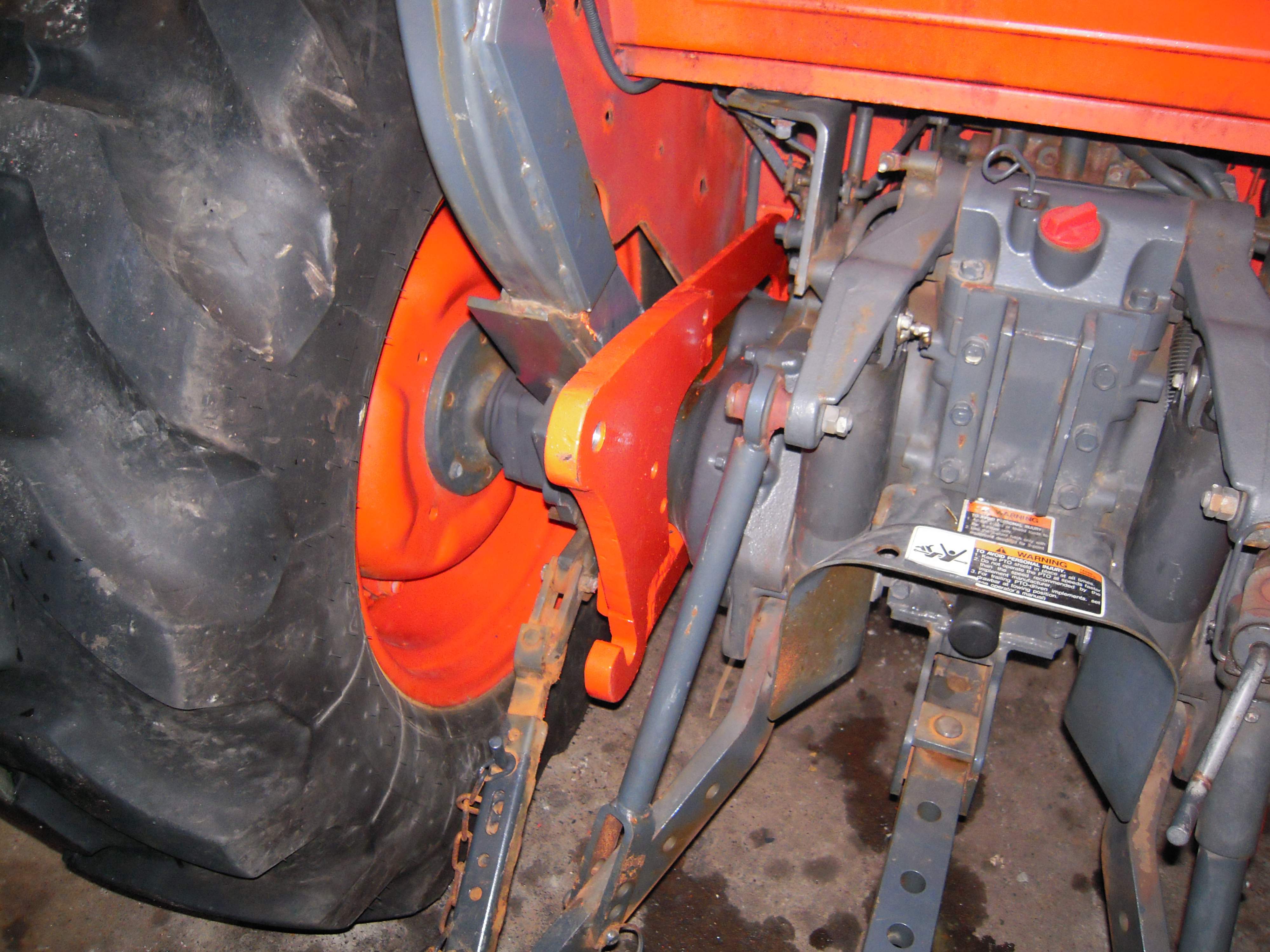

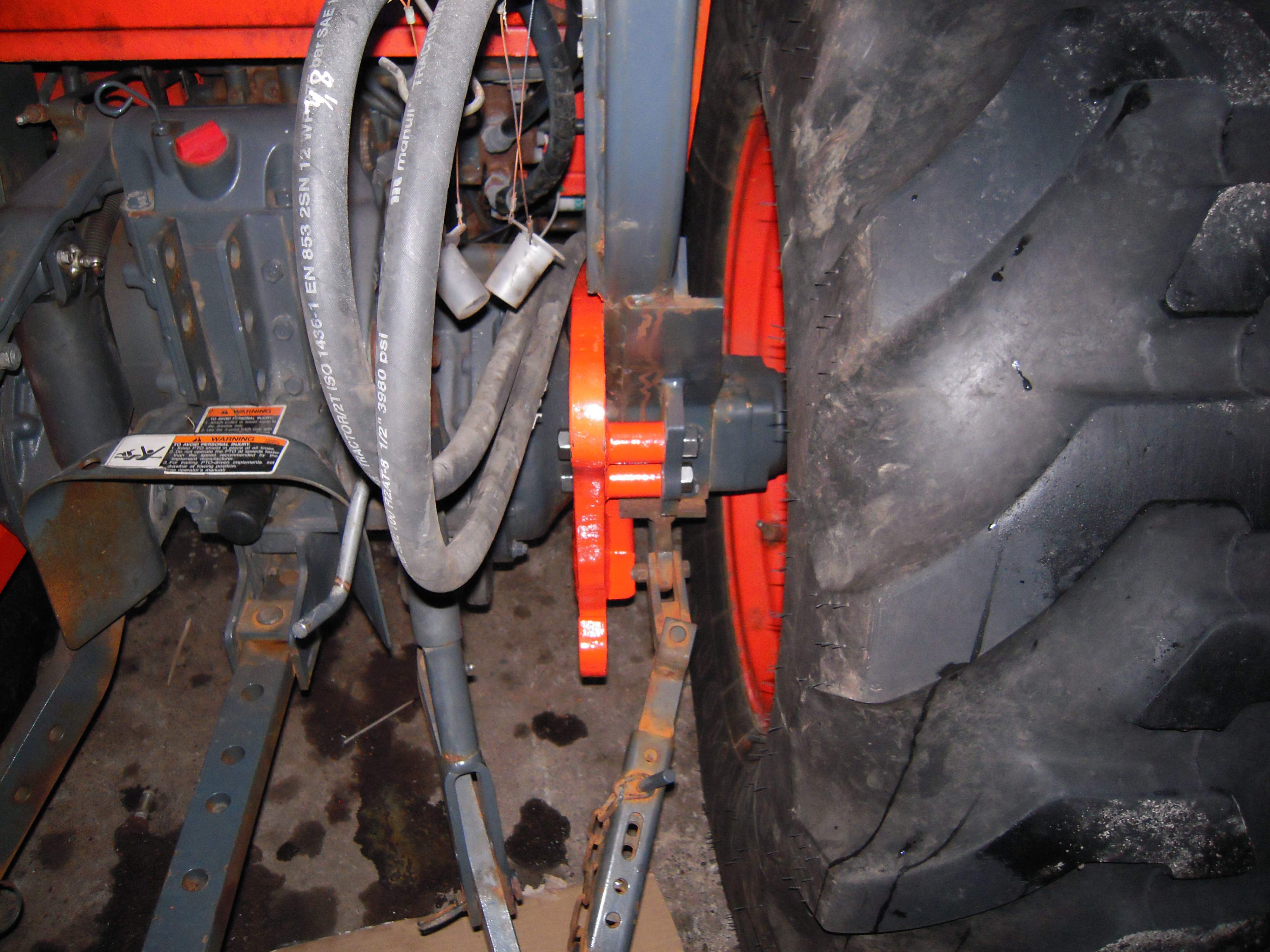

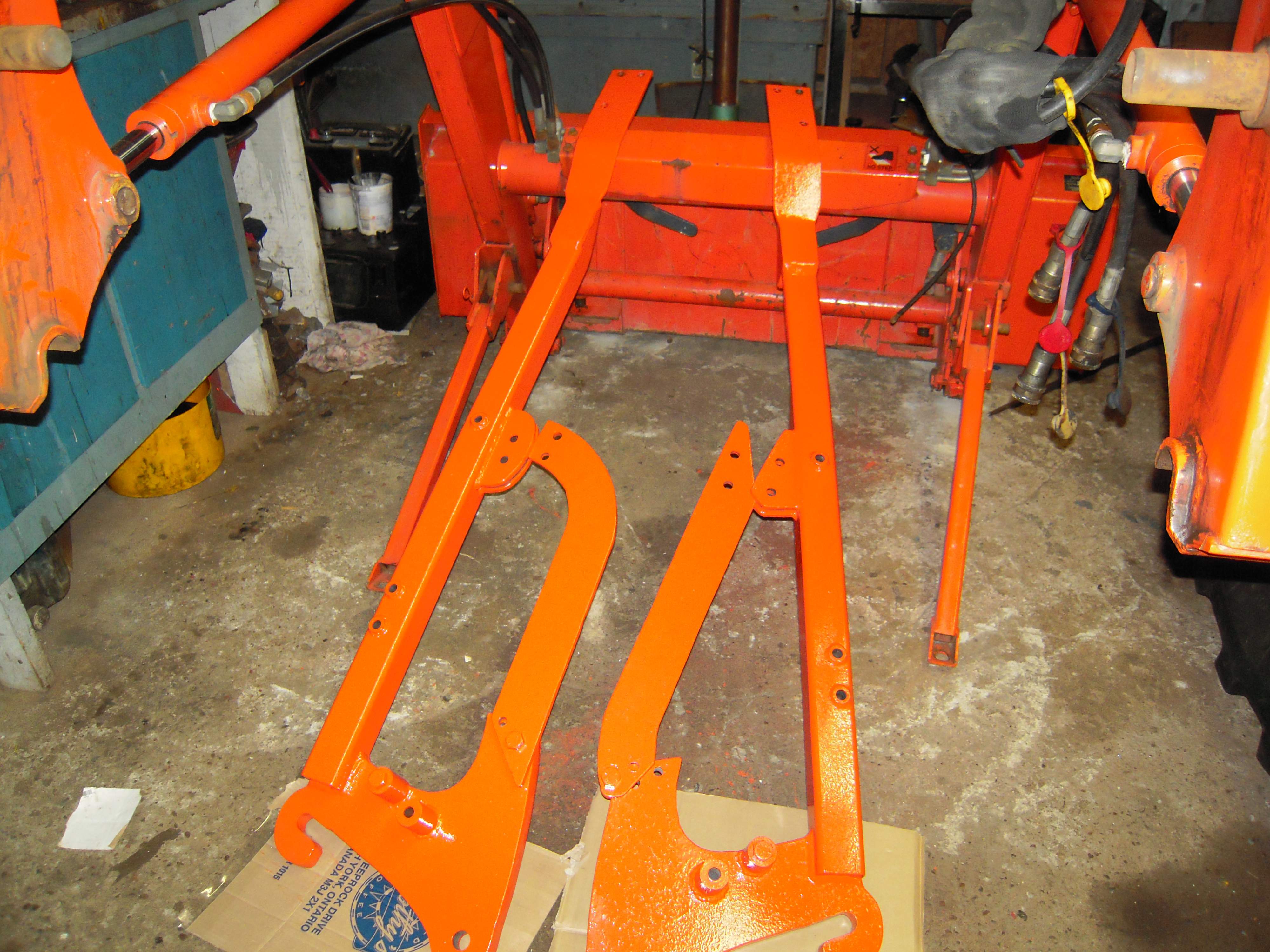

   / LW-6 or TC-6 backhoe #10
yes i have a lw 6 backhoe and iam in the process of fabricating sub frame
i have been really busy at work and haven't had much time, i have included
some pictures of the sub frame so for
Bambie
