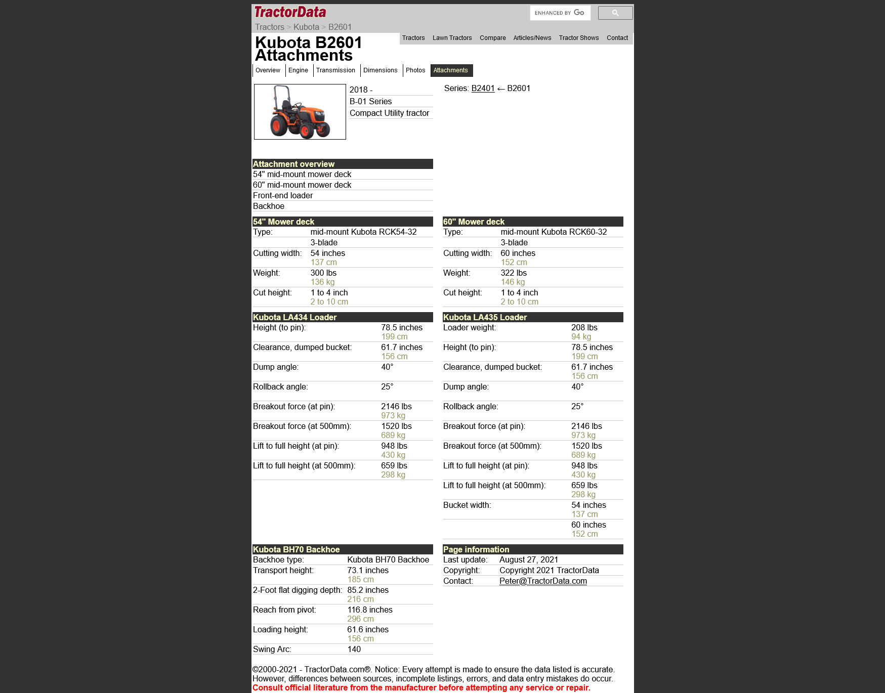

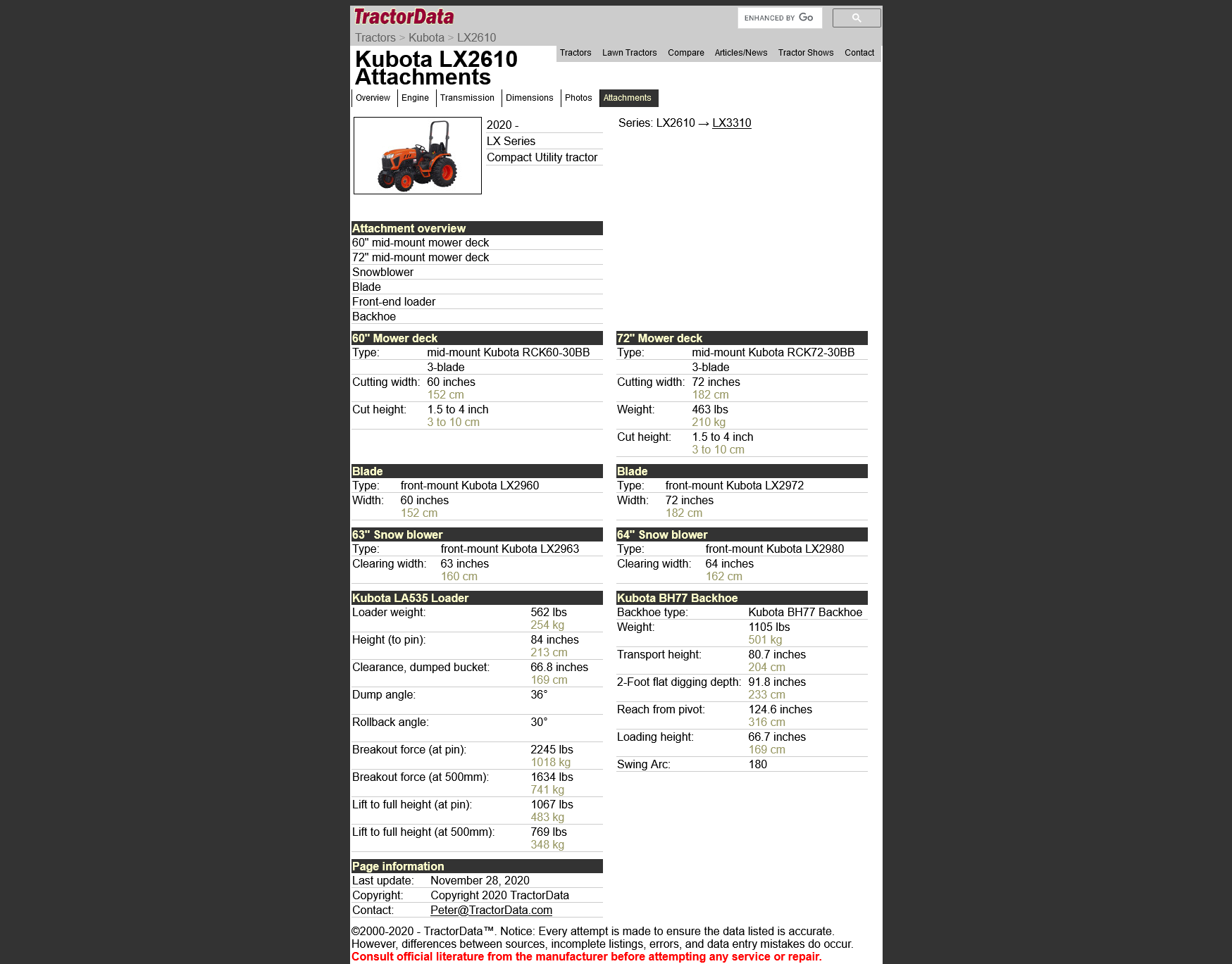

I would agree with sea2summit. Here are the specs on the lx2610. I have not used either of them. Looks like NO on the b and questionable on the lx. Also, if you have the finances, look at the 5 year interest free and the insurance offered by Kubota. And look at the B, the LX and before you buy, look at the L series. Good luck. Hope you enjoy whatever you get.
  • Screenshot 2021-09-01 at 14-25-47 TractorData com Kubota LX2610 tractor attachments information.png
  • Screenshot 2021-09-01 at 14-32-54 TractorData com Kubota B2601 tractor attachments information.png
