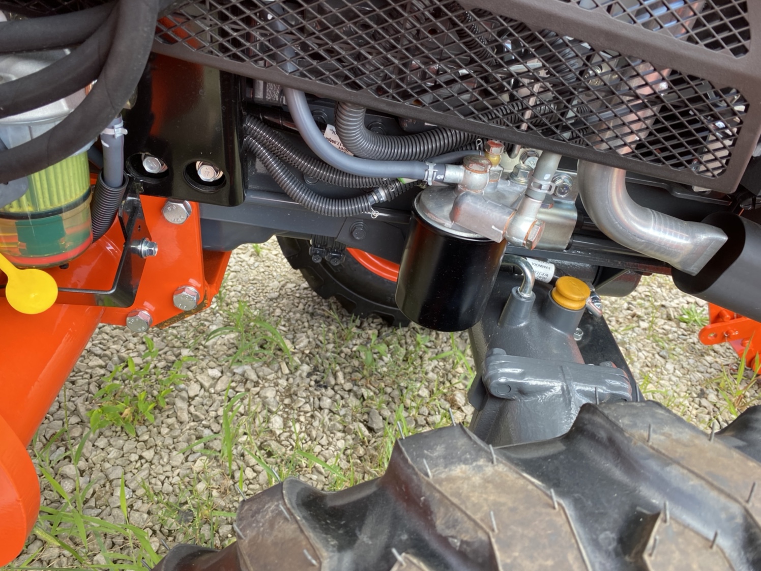

and the hydraulic filter is just behind steering axle, with a separate cooler, just in front of the transmission(?)
cooler.

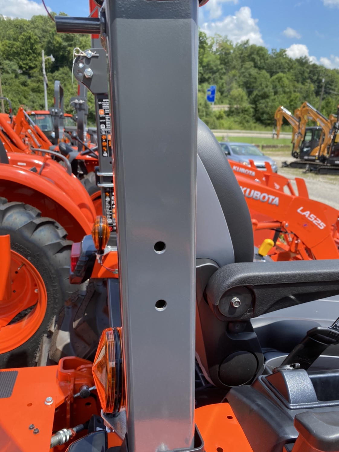

And the ROPS has 4 sets of holes to mount lights on.

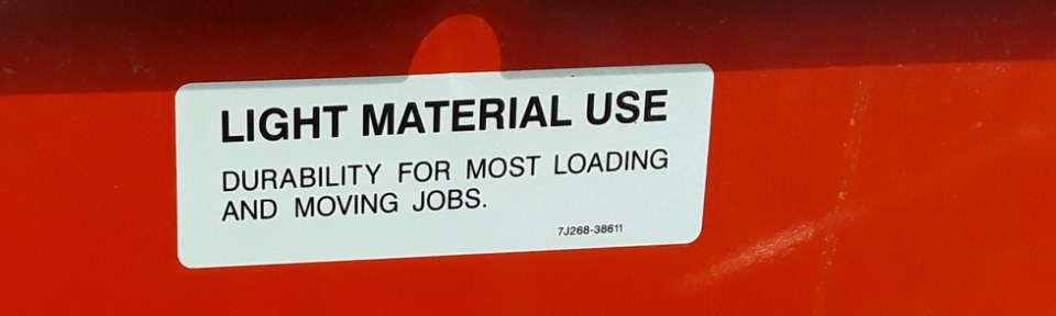

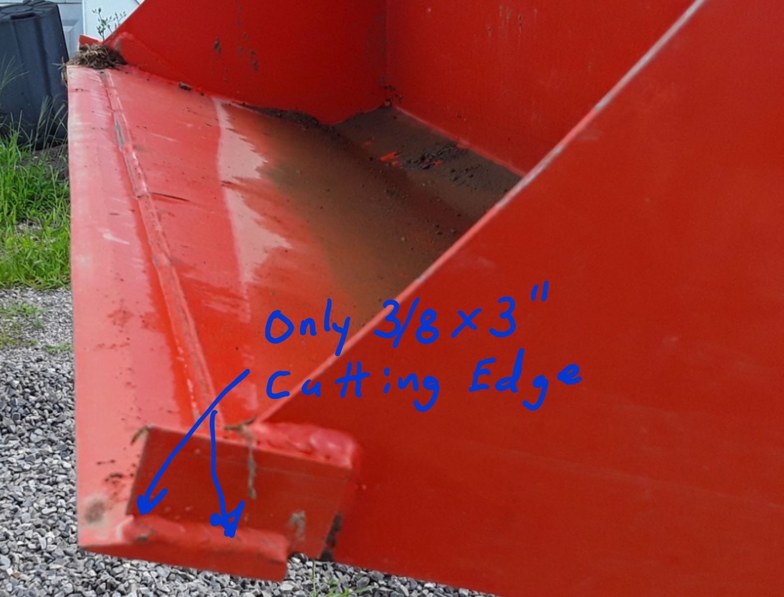

You might of been looking at a heavier bucket series. For the LX series the recommended 60 inch bucket is light material use labeled and is definitely a light build (whimp) bucket The 54 inch bucket comes pre-drilled for an optional Kubota cutting bar.
Here is the 60 inch bucket. Only a 3/8 x 3" cutting bar, label from factory light material use and not pre-drilled for cutting bar.

Are you referring to the black canister filter when you mention the Hyd. filter behind the front axle? If so that looks like a secondary fuel filter to me.
Edit: made myself curious and found out the black canister is a fuel filter, and it does have a fuel cooler.
   / LX3310 #6
Because of pollution equipment the LX3310 has 2 fuel filters and a fuel cooler. The LX2610 has no canister fuel filter or fuel cooler.
   / LX3310 #7
Its due to the 3310 having a high pressure common rail fuel system, the 2610 still uses the idi mechanical injection.
Common rail systems are very sensitive to contamination due to the small injector orifices and tight tolerances in the high pressure pump.

The fel bucket is a 54”, not 60”.
I assumed the black filter was a hydraulic filter.
