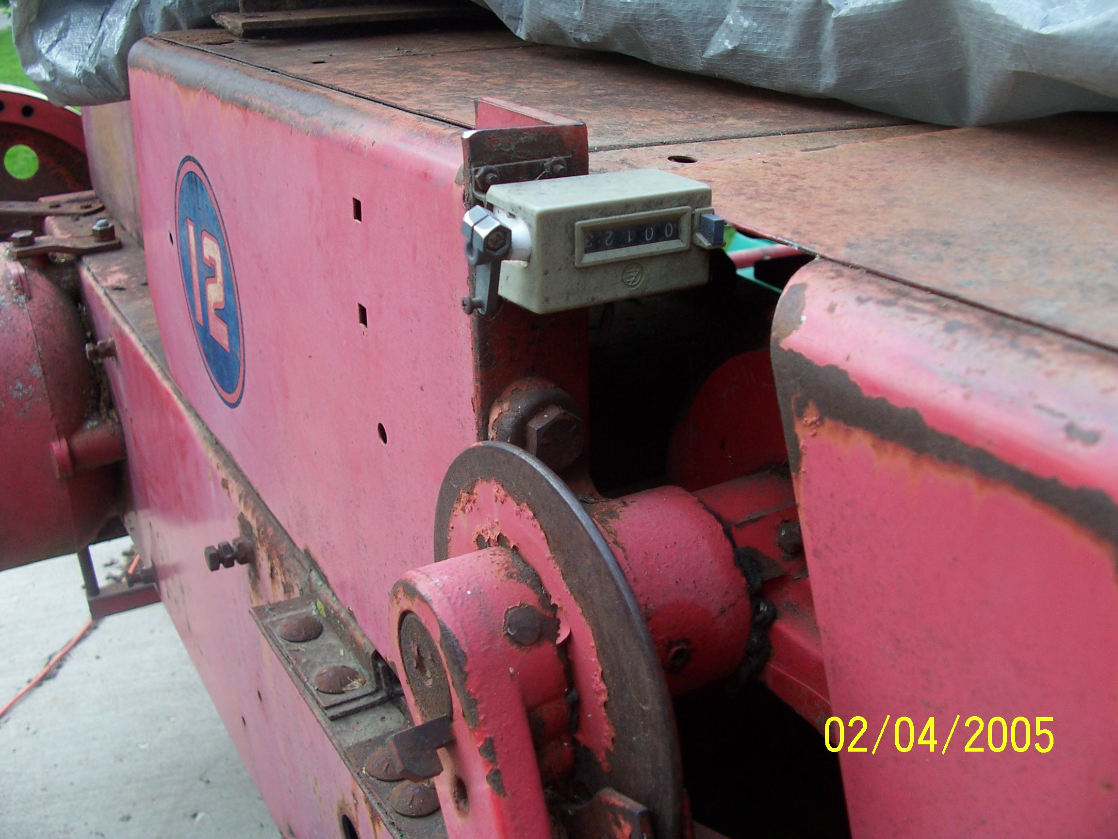

I just purchased a M F 12 baler and i am trying to figure out how to get the bale counter working. It was missing the "finger" which I purchased along with the manual, but there are no clear pictures that show how to install the "finger". Can anyone help me?

I have a mf 12 and here is the pic of the counter on it.
