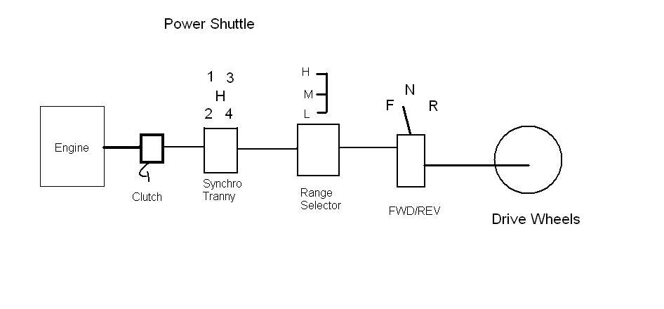

Fully synchronized transmission, 1-4. Just like a car. Clutch through the gears. Clutch through the ranges at a standstill. Shift forward/reverse without clutch. The attached diagram gives a rough equivalent schematic of the drive.

1-4 is just like a manual car. I really like it when I am cutting the field I can speed up on smooth areas and slow down on bad spots with out stopping to change gears.
