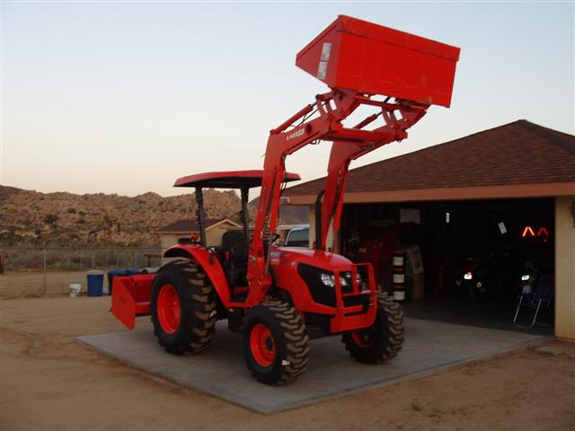

I would have to ask what your intended use for the machine will be. I have an M7040 which gives you more HP and limited slip in the front axle. I believe the M6040 and the M7040 are pretty much the same otherwise. Make sure you get hydraulic shuttle. It's a much stronger clutch design.

Wow, nice picture/ tractor. I will be using the tractor to pull up borders, discing, broadcasting, and harrowing for 20 acres. I just built a new house so lots of landscaping, and eventualy flail and Brush Hog mowing up and down the roadsides. I have been trying to keep my streets roadside cleaned up since all my neighbors don't seem to care. Whatever tractor I get it will stay pretty busy for a while.
I would like to save the $2k and go with the M5040 if it will be enough tractor. But if $28k for the M6040 is an awesome deal then I will it buy it instead. I hope this makes sence. What do you think?
