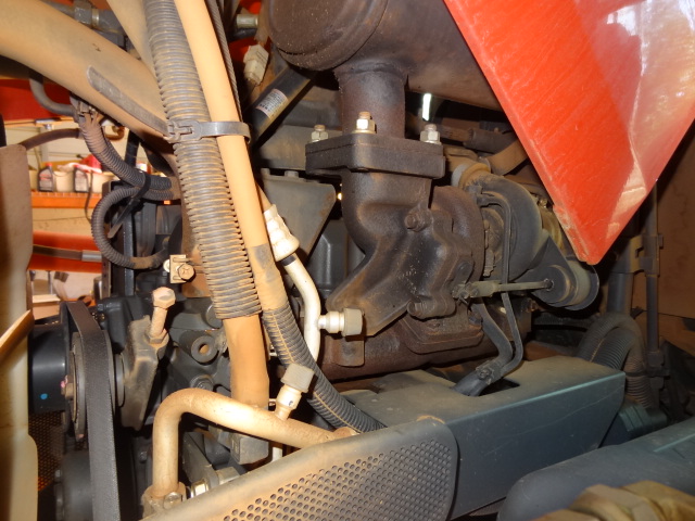

I have an M5040 Cab tractor that develops a loud brief squeal coming from the area of the turbo when the machine is hot. It takes about an hour of running at PTO speed before the onset of the condition. The squeal lasts about 1/2 second and repeats randomly every few minutes. At first I thought it was a chassis squeak, but I finally noticed that it did it on level ground when the chassis was not stressed. The cab muffles it greatly, but when I open the left door it is a loud brief scream.
Any ideas? Oil level was good and 100 hours since change Delo400 LE 10W-30 in the engine. I changed it today for good measure and am sending a sample to Blackstone. I"m hoping I don't have a journal bearing going out, but logic tells me that is most likely what I am hearing. The tractor only has 400 hours since I bought it new.
Any help appreciated - Lee

have you discussed this w/reliable service manager @ your dealership? or better yet, talk to a mechanic w/service manager where you purchased. although warranty is probably expired on that model, still worth their take before investing in replacement parts. imho
also, ensure all belts are tight on the engine.

So is it the air conditioning belt squealing when the compressor starts up?
Edited to add: I don't think it's the turbo as any squeal from there is usually catastrophic.

My 2010 M5040 indeed has a turbo and a three cylinder engine vs. a 4 cylinder normally aspirated engine.

More likely either a belt or the alternator. Do you have AC? Could also be the belt squeal as the AC engages which would cycle every few minutes.
That is what I thought as well, but that is where the sound seems to be coming from. The belts are on the front. I am well familiar with belt squeals, and this one is much more intense and briefer than that. My local dealer is not very good. There is an independent mechanic nearby and I may get him to give it a listen. This is made more difficult by the fact that the noise doesn't start until it has been running under load at PTO speed for an hour or more. I may try to get an onsite visit scheduled for him at a time where I can give the machine an hour of work before he arrives. Consistent with the statement (which I agree with) that a squeal from a turbo is usually catastrophic, I don't want to run it much until it is identified and fixed. I don't want shrapnel down the intake.
