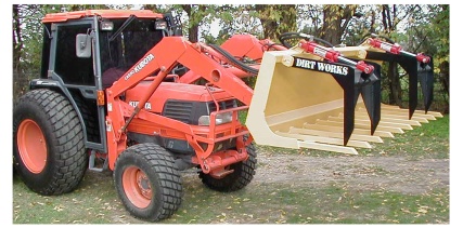

Start with tint you will love it... see attached picture...
Don't move battery, I know it looks like it is in the way but it is not blocking any significant part of the air flow... Do make sure that the hot water is fully off, like RickB said, install a mechanical ball valve if your not completely off on the heater hose feed.
After the bubble insulation in my roof I usually have to run my A/C on low, it gets COLD in there... KennyV.
