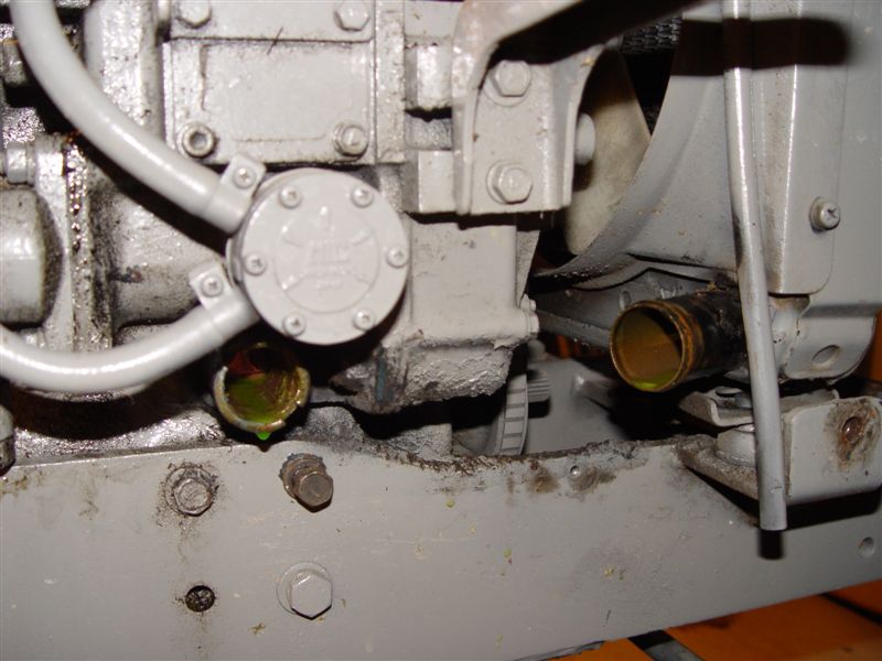

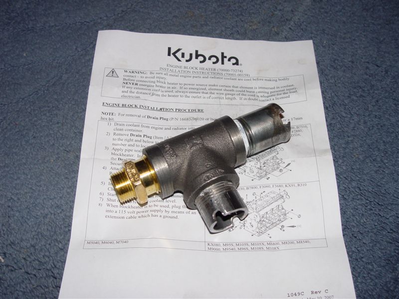

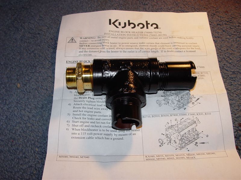

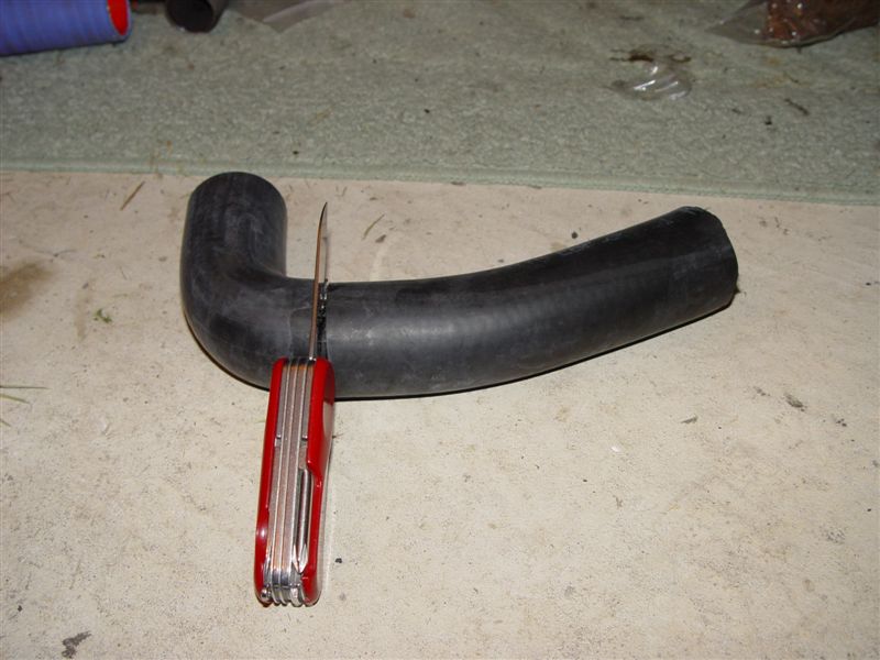

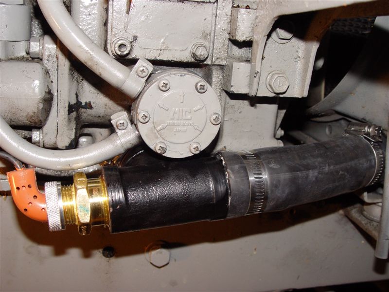

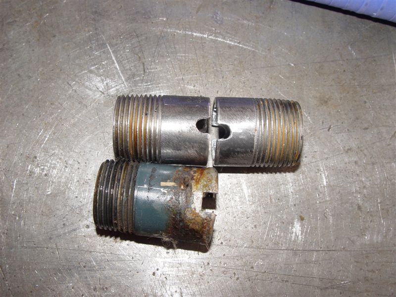

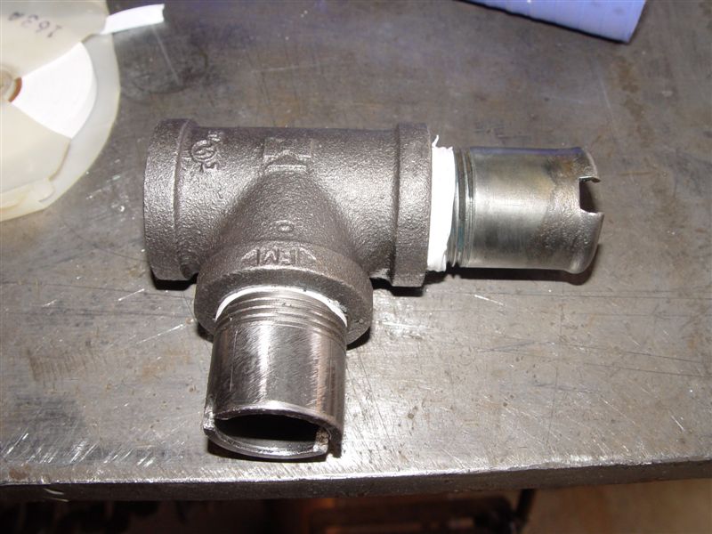

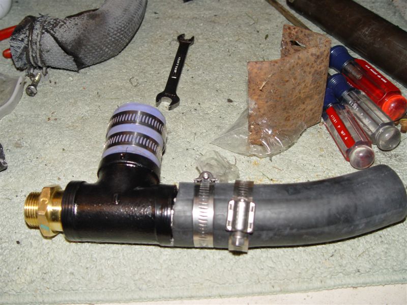

I just added a Kubota block heater to the lower hose in my B6100. It's based around a 1" pipe thread. I bought standard 1" black pipe parts including a Tee. I made the little nipples to form a union. Here are some photos.

After machining the parts, I painted them black and installed the brass block heater I got from Messicks. There is no actual kit available, so I made it myself (with my Dad's help of course). I purchased a new lower hose, which I cut shorter. Good decision as the old hose was original and nasty. After the install, I tried it out. After about ten minutes it sounded like I was making coffee in my tractor. That's a good sound when it's cold out :)
