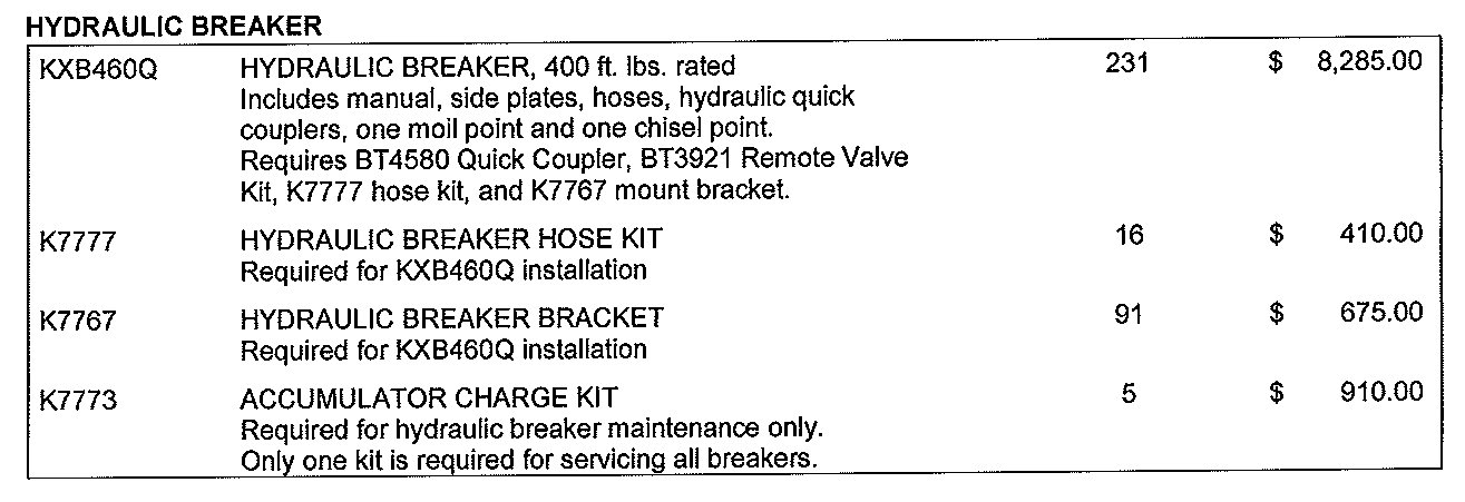

The 2009 Whole Goods pdf that I found on line only list a hydraulic breaker for the L48 not the M59. It is listed as part number KXB450F. There is a used one listed at Zimmer Kubota.
Kubota KXB500 Hammer / Breaker Attachments from Zimmerer Kubota & Equipment Fort Worth TX
Further info relative to the KXB450F is not in the pdf document.
If you have the M59 quick coupler on the hoe I believe you will need to remove it to mount an L48 compatible breaker. The L48 and M59 are pin mount compatible. The L48 quick coupler is compatible with KX quick coupler buckets. The L48 BH quick coupler will mount on the M59. The M59 quick coupler will not work with KX quick coupler buckets.

You can add a hydraulic breaker when you build an M59 on the Kubota website. It's at the bottom of the attachments page...$9370 "Hydraulic Hammer - Quick attach type."

The Jan 2010 WG pdf has the information for the M59 added. The BT4580 listed as required is the M59 quick coupler. The used one from Zimmer looks like a pin on. The price in the list is obviously old based the Kubota site. Thought the part numbers might be useful in searching for used equipment.
