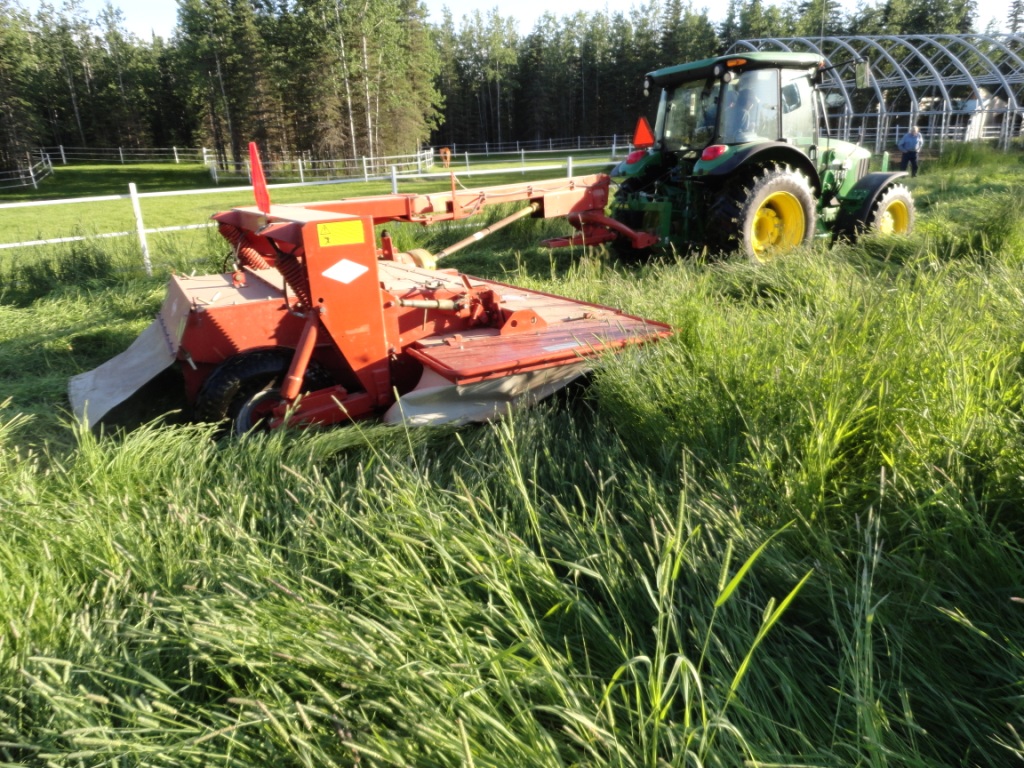

I pull a Kuhn 8'2" cutter with flail conditioner and a JD5075M and no problem at all. Grass hay and flail/finger conditioner and a 9' cut wouldn't seem to be that hard a pull. Alfalfa and a roll crimp conditioner is another story - IMO.
AKfish
