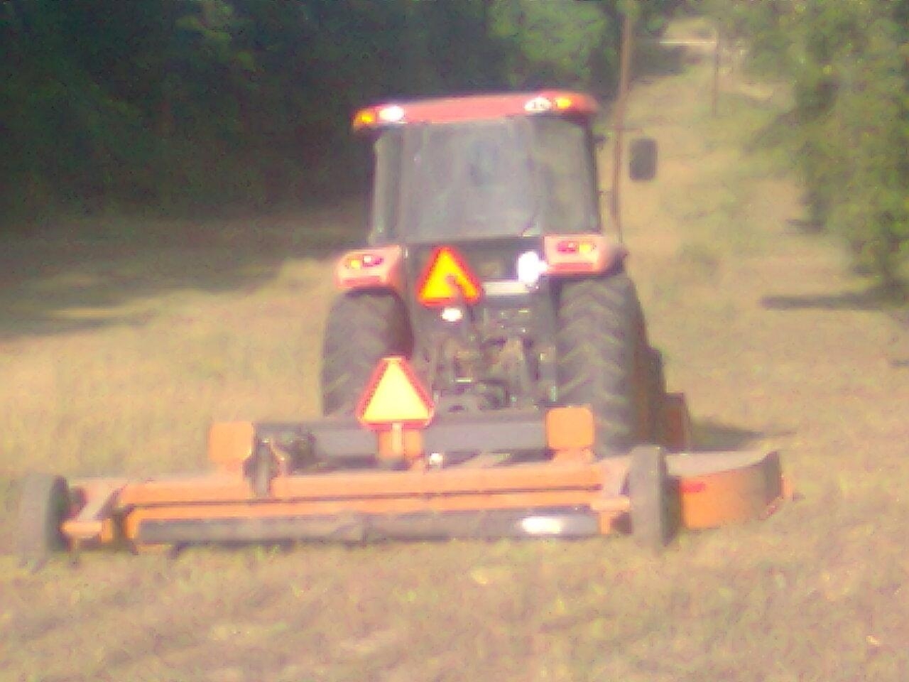

I managed to snap a couple pics the other day.
This pic is in a 40 acre block that I planted in rye grass last fall. The rye grass did well, but I've been fighting some tallow trees popping up. I spot treated with Pasture Gard last month, and now hitting it with the mower.

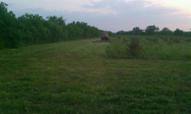

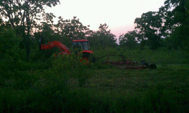

This pic is in a 60 acre block that has been left untouched for several years by the previous lease holder. My plan is to mow down the tallow trees, then when they leaf out again, go over it with spray rig and cover the entire block. Right now, as you get a couple hundred feet into the pasture, most of the tallow trees are too tall to get a spray rig through, and I don't want to basal treat 10,000 trees... hoping my plan works.

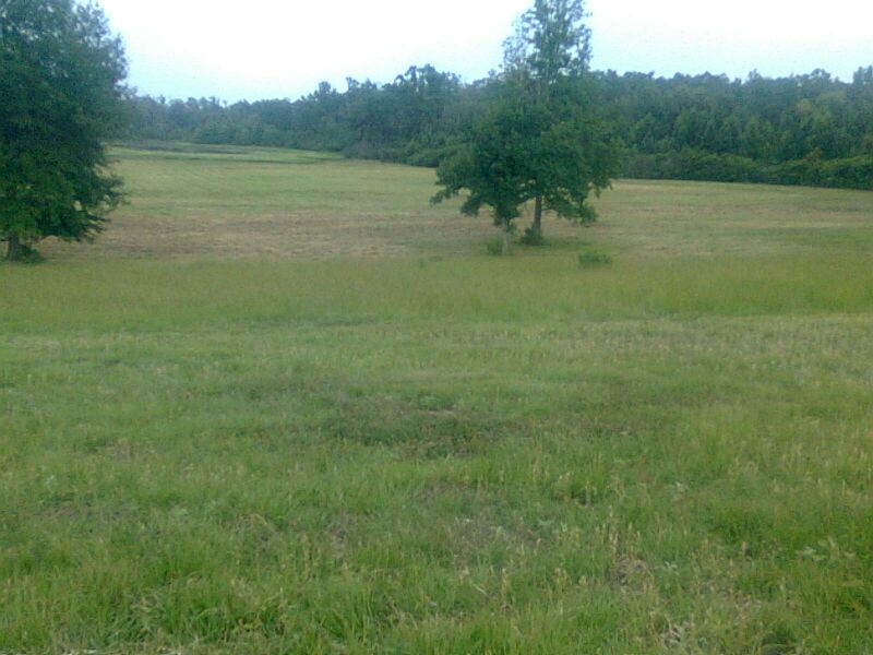

This last pic is the small field with the 3-4' tall johnson grass. I was pleased to see the mower is mowing pretty level without my having to make adjustments.

Looks good:thumbsup: Glad to see the batwing working out for you,you'll be searching were you left that dang 6footer in the weeds at:laughing:

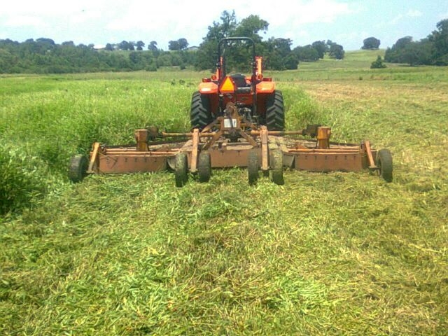

I cut alittle this weekend 5040&15ft mowing bottum1.JPGmowing bottum 4.JPGmwing bottum 3.JPGbottum finished.JPG
