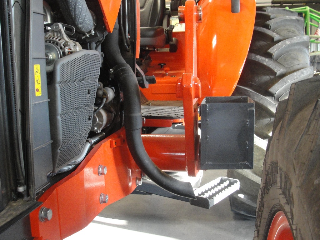

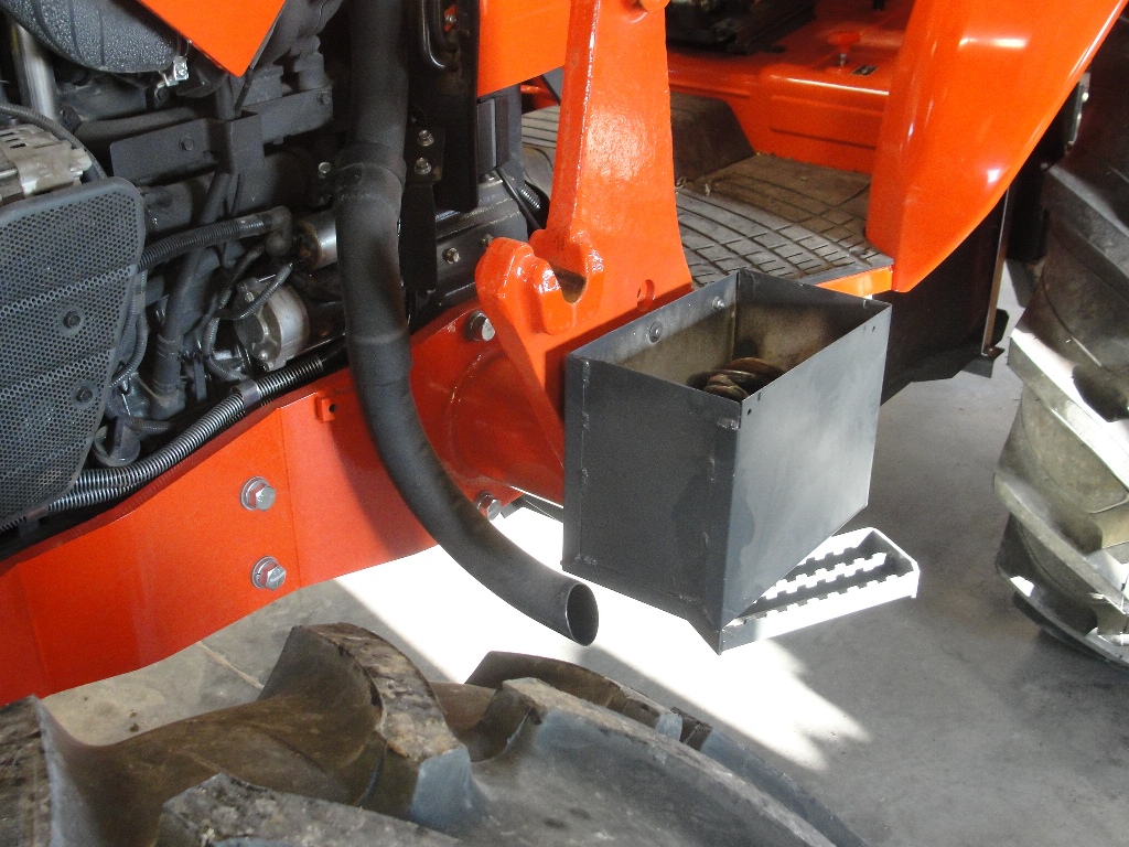

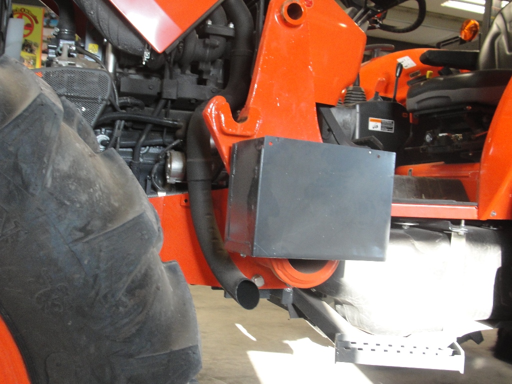

Like Derek, I'm not sure this will help you. I modified my vertical stack to the down mode. I used the parts from the upright stack to build what I needed to make it a horizontal or lower.

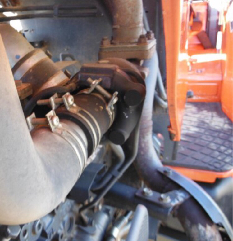

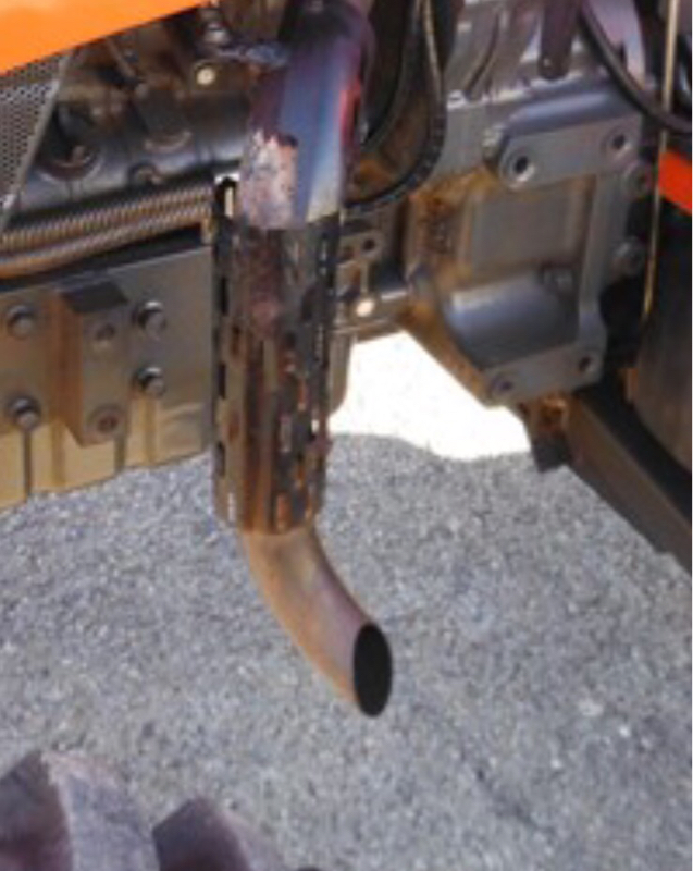

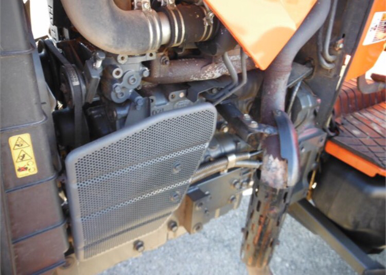

Found these pics on Tractorhouse of a m7040d. Not sure if there is a difference between the "d" and "su" exhaust wise.
*For some reason the tbn app crashes if I try to add more than one pic at a time so I'll have to make a few separate posts.
