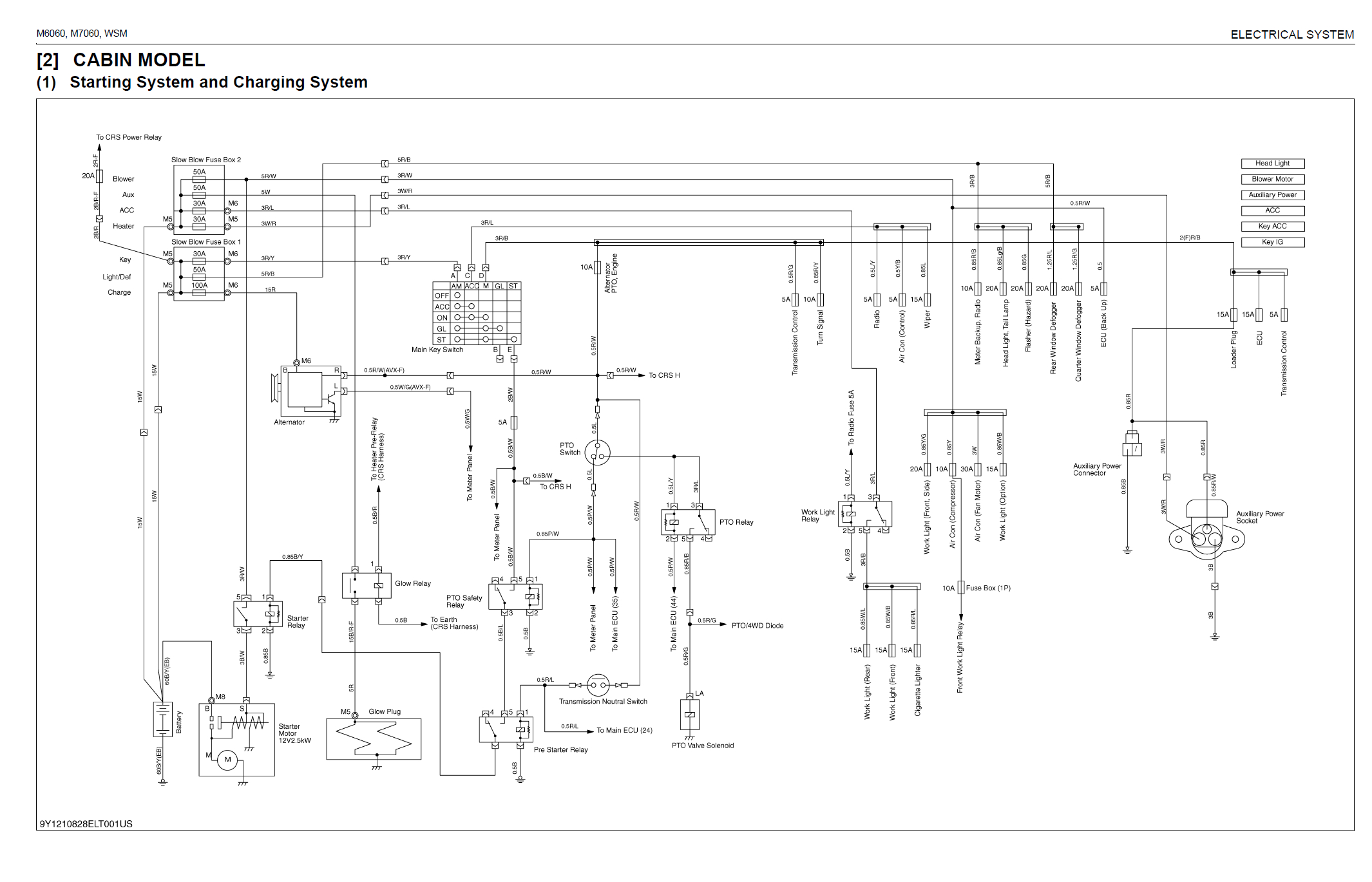

Mar 24, 2019 / m7060 cab model Air seat wiring #1 R RoyKing Platinum Member Joined Nov 4, 2017 Messages 839 Location Gainesville Florida Tractor M7060HSC/18, RTV-X1100C My WSM shows no wiring for the compressor, or any mention of the air seat, any body know?

Mar 27, 2019 / m7060 cab model Air seat wiring Thread Starter #4 OP R RoyKing Platinum Member Joined Nov 4, 2017 Messages 839 Location Gainesville Florida Tractor M7060HSC/18, RTV-X1100C Dealer responded, white plug behind seat and below rear window, looks like aux power connector has two circuits in it a 15amp fuse 5 and 25amp fuse 10. Right side of wire diagram Attachments AUX-PWR.jpg 556.9 KB · Views: 458
