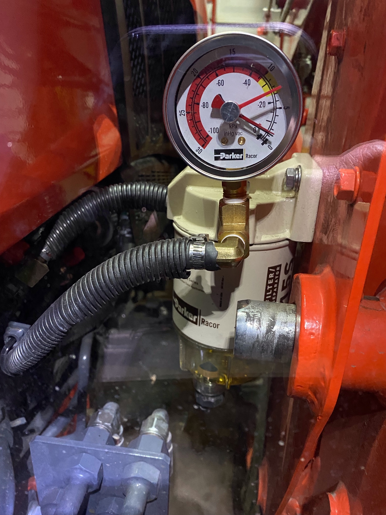

On my L4060 I replaced the OEM strainer / water separator with a Racor 215 R2 filter / separator. It's a 2 micron filter in the primary position (not ideal), but it has a large capacity. I also installed a Racor vacuum gauge on the filter to keep an eye on the filter condition. So far after 200 hours the vacuum hasn't significantly increased.
I left the OEM spin on final filter in place.

Got Racor clones (bases) with Racor filters on both my Kubota's. No vacuum gage, I just watch the clear sediment bowl on the bottom of the filters. Nothing ever gets past the Racor.

Probably better to leave the OEM strainer / separator in place, and add the Racor where you plan. The OEM can catch the large debris and take some unnecessary load off the Racor.
Can't remember why I removed the strainer, but worse case for me is that I go through more Racor filters, which hasn't happened yet.
Good luck with the install.
While I don't have the restriction gauge on mine (I will get it), I do have the optional bowl heater installed. Mounted both of mine on the loader upright which makes the readily accessable but out of harm's way.
/ M7060 FUEL SYSTEM PROBLEMS #14
Any pictures?
