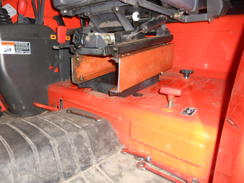

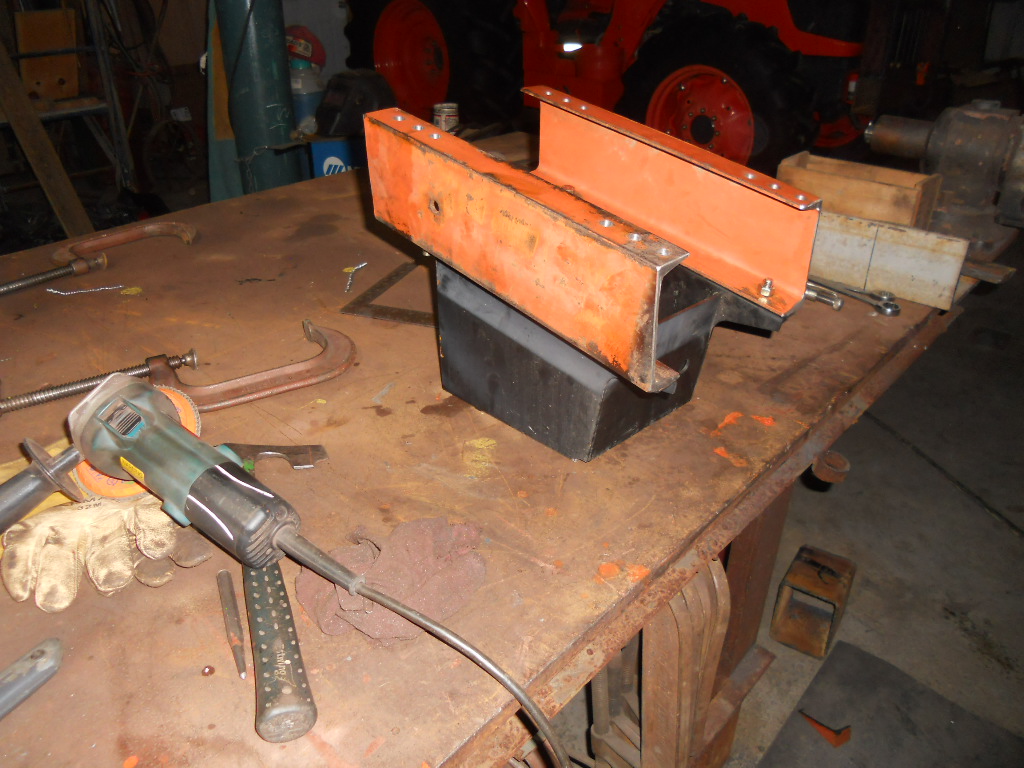

This was my fix for a non cab 9540. I pulled the surprisingly heavy seat out, then the factory "mount" and used some 4" channel to simply space the seat & seat track up. A big improvement in comfort for me.
Here's the factory seat mounting with the 4" channel added. I drilled a series of holes for a little more flexibility front to back if necessary.
Put back together. Pretty straightforward little mod. Now I'm looking for a "turntable" to swivel the seat.

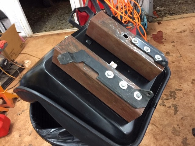

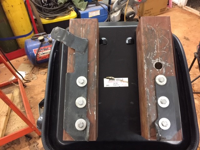

I just bought a 2008 L4400 and had the same problem. I am a big guy and the brakes sat way too high for me to be able to reach them...not to mention the treadle pedal was real uncomfortable to use. My solution was similar to the one above. I used some scrap 3x3 red iron from where I built my shop and attached it to the bottom of the seats with the factory bolts then attached the normal frame brackets to the 3x3 with 6 bolts & nuts. By using the factory brackets all the seat switchs etc still work like they are supposed to. I did paint it before putting it on the tractor but phone went dead before I got the pics of that LOL
Made 100% difference. I can now operate all the pedals comfortable and I do not have to use to steering wheel to pull myself up with :)
