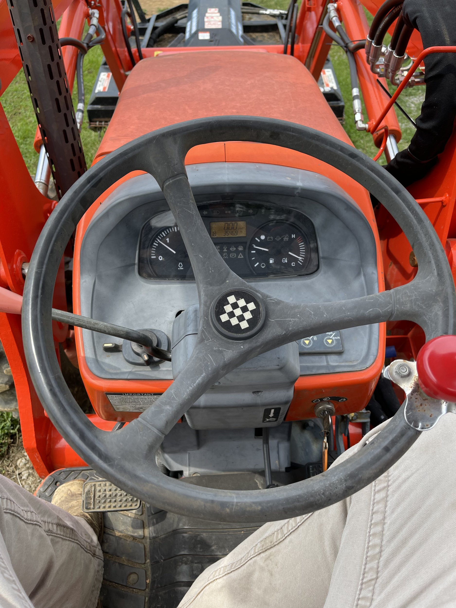

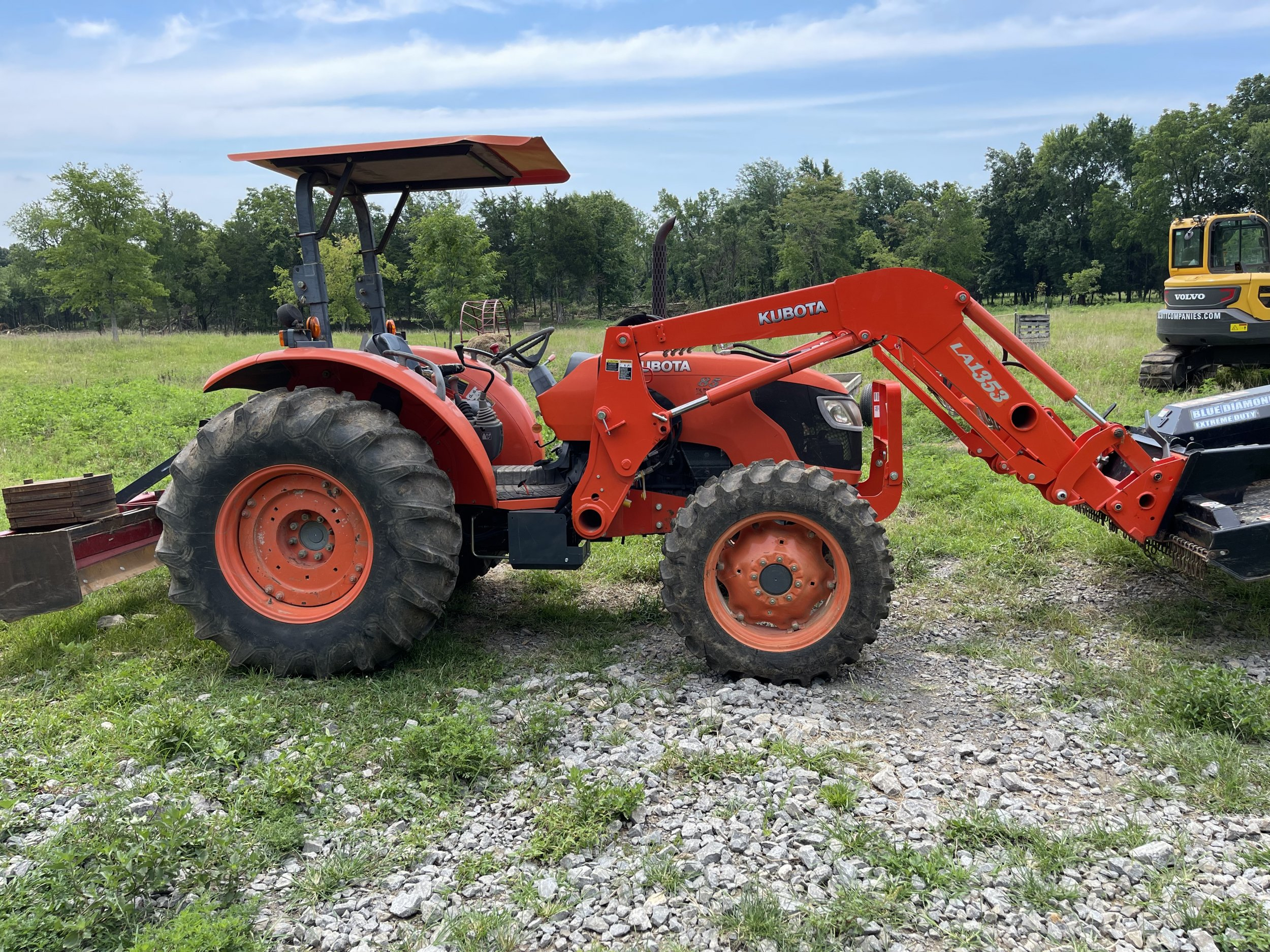

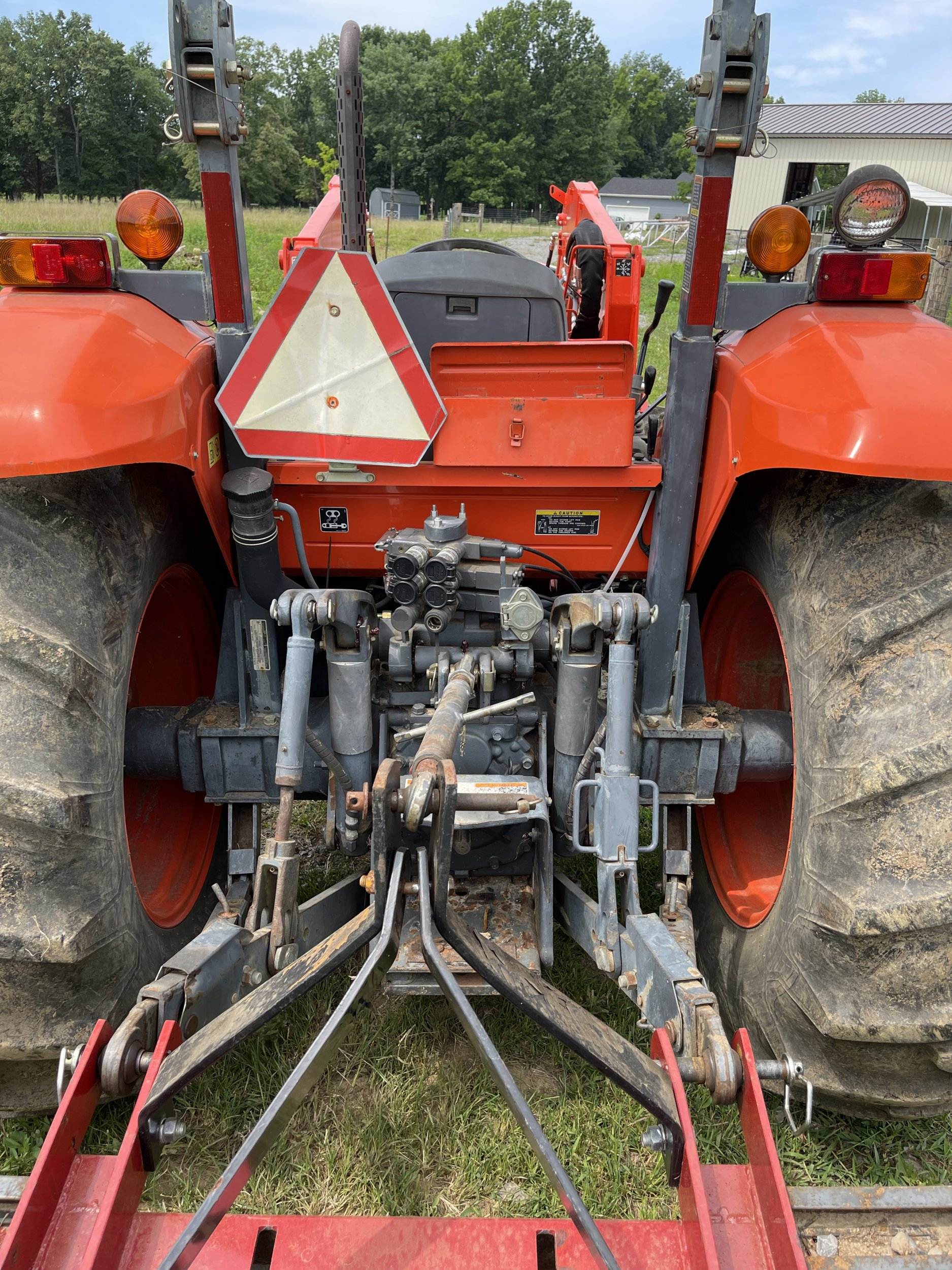

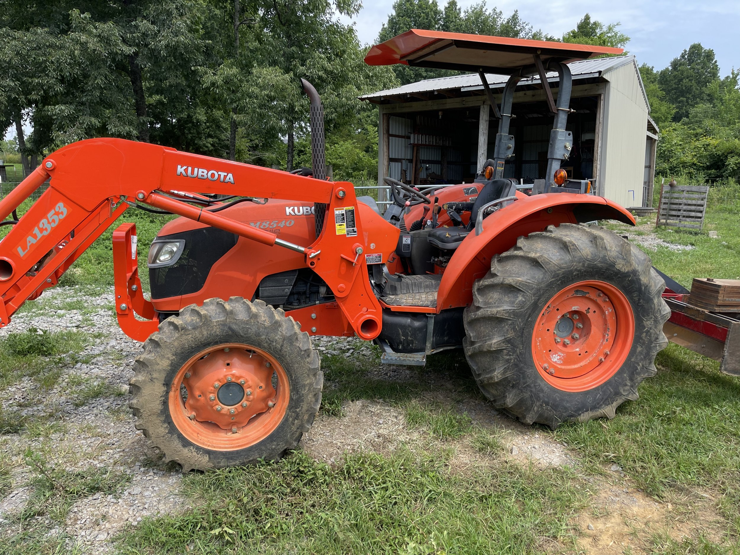

   / M8540
A few pics
   / M8540
The cable seems easy enough to access, probably have to drop the tank. I may try to lube it first.
4x4 works correctly, hi/low seems correct. PTO had a slight chatter noise when I engaged it at idle but went away, not sure if it is anything or the canopy(canopy made similar noises at other times). I did notice that the wait to start symbol and 4x4 light do not come on, have not checked fuses yet.
   / M8540 #8
Solid looking tractor, doesn't look beat up. Those are well built utility tractors that you can still actually work on. Three remotes on the back plus the loader it's "loaded out" on hydraulics which is a bonus.
That was the last you could get before all the Tier 4 crap had to be added to them. Even if you have a few repairs here and there that is a desirable tractor.
   / M8540 #9
Actually, if it's an open station, the cable is pretty easy to access, Not so with a cab model unless you have hands the size of a mouse.
what i thought too on my open station. but you have to drop tank, etc, guess i could have done but i get good support from dealership so i had it done. everything's tight & tucked away
   / M8540 #10
If I pull the left hand tire and wheel and the fender, it is very accessable. You don't have to remove the saddle tank at all.
