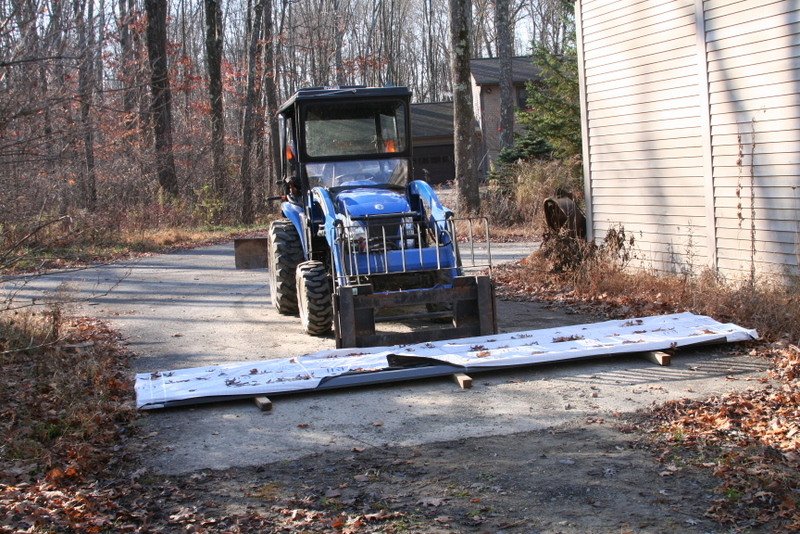

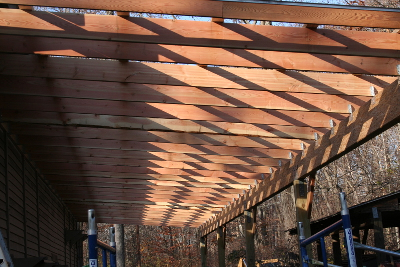

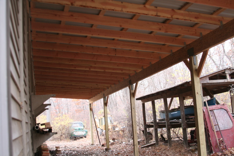

Update. Carpenters never showed up. Guess they have enough work. A friend and I started and finished the roof panels. 22 panels in 5 hours. Need to put in more screws but it will hold for now. Fel would not lift high enough and my MF hoe quit running again. Fuel delivery. It was a nice day and I worked on top and my friend handed them up. We had a scafold so we had a landing half way up. 14' long panels. 66' long roof so it was a long carry after half way.
Next time I will get a picture from up on top.
