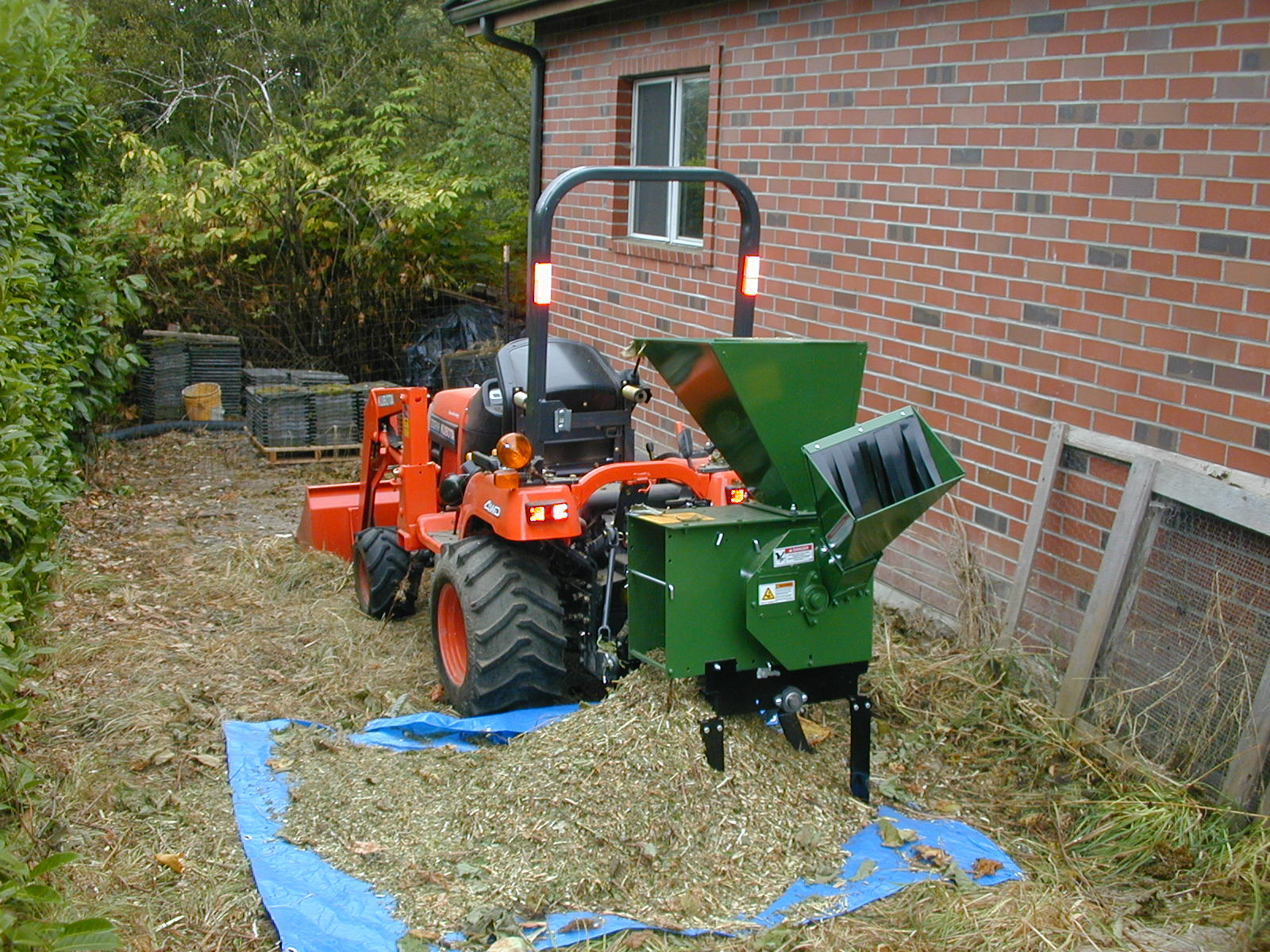

I bought the tp122 from West. Great outfit to deal with. I live in Wa state so I really made out with the free shipping. They even made sure it was on a truck with a tail lift. I've had the chipper about 18 months now. Works great even on a small tractor. I really like this chipper
