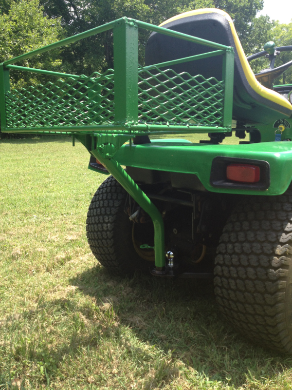

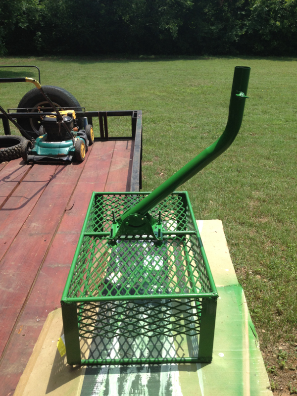

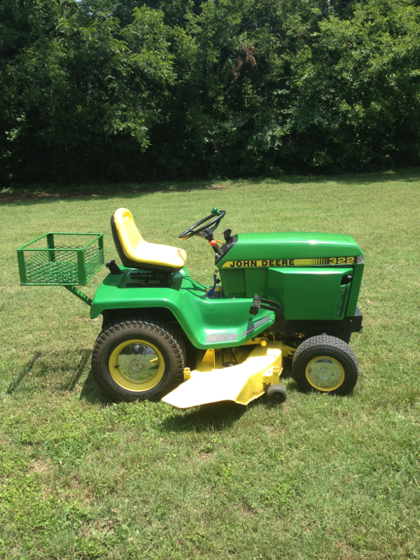

Just wanted to share my latest fished project on my 322. I Needed some more space to carry a chainsaw or whatever else I may need. So I found some metal scraps and put this together and The pipe holding up the basket is out of an extra satellite dish stand.

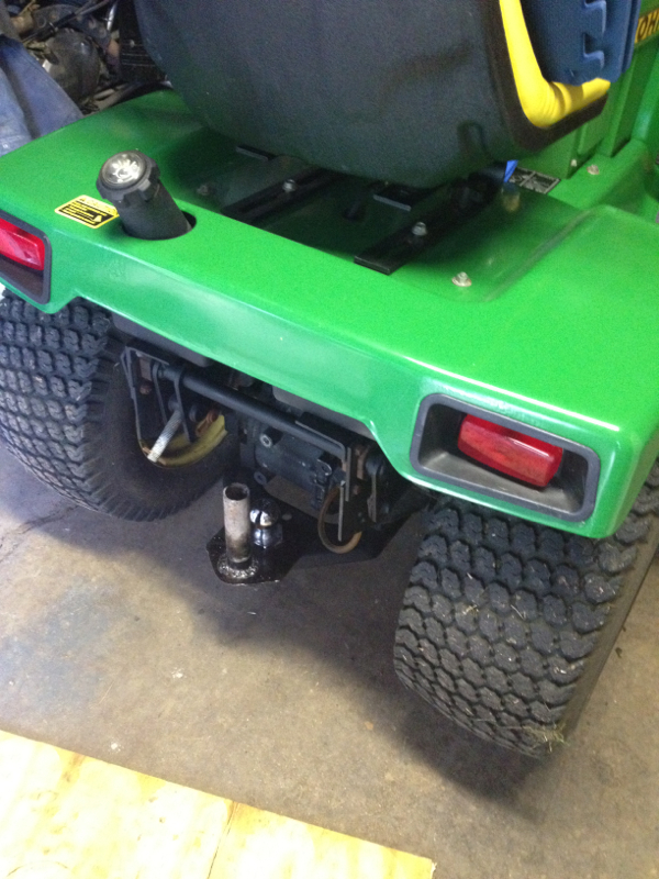

How does the pipe holder attach to the drawbar behind the trailer ball that is in the pic?
   / Made a basket for my jd322
It's a small plate that is bolted dn by the 2"ball. It's a very simple concept and like that I can quickly move bar with basket on to my other tractor. Well I will once I make another bottom bracket for that tractor.
