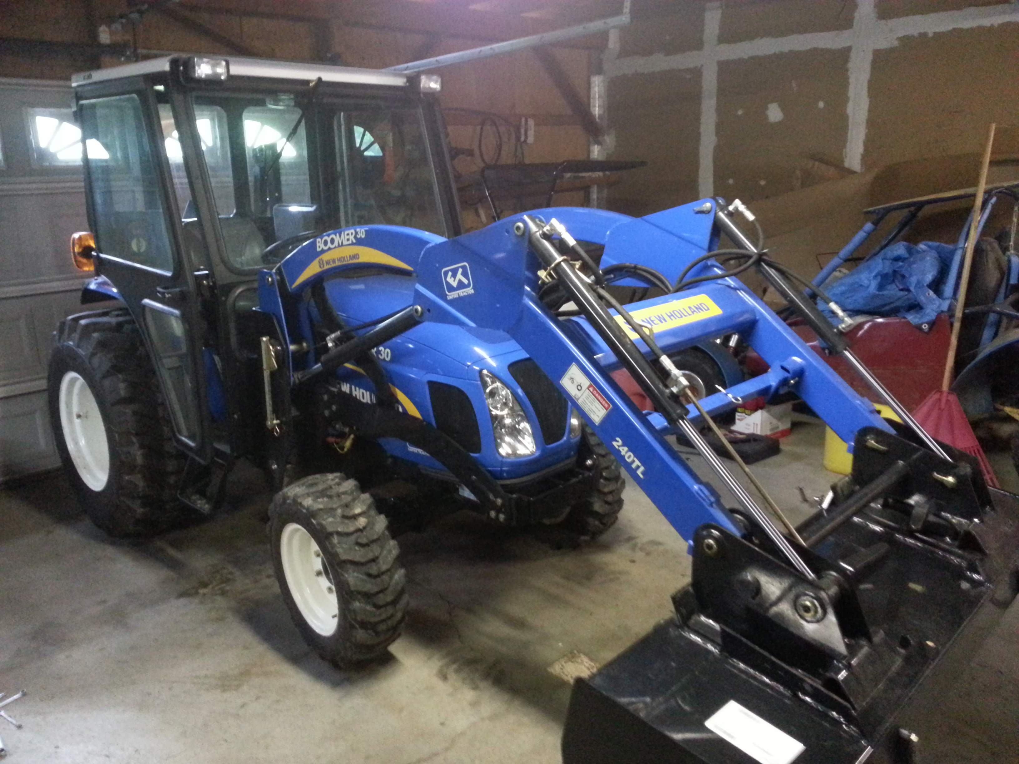

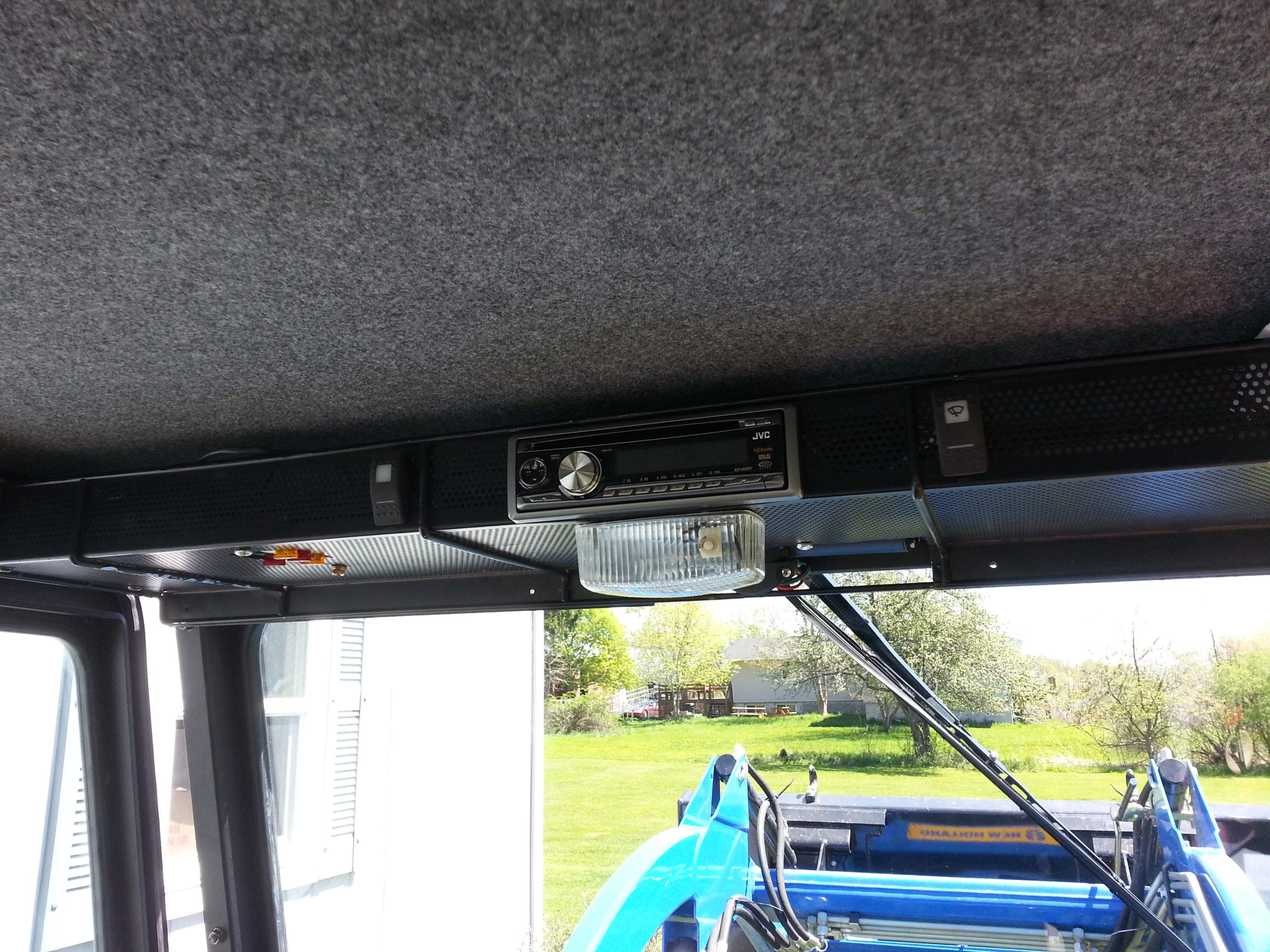

Hi I got this cozycab with the wiper kit but no headliner (optional) . I decided to make one rather than laying out $300 plus for a headliner even tho its made from sheet metal with holes cut out for fans, speakers, radio, with the fuse panel, and all the wiring. Low and behold (wife hates this when i do this and bring stuff home ha ha) another dumpster diving pays off :laughing: lol, as I got this grocery store 4 ft shelf and some wiring a few years back. So out comes my Dremel, Sawsall, drill press, with a few sparks and a puff of smoke, wala, my headliner is created. The only thing I bought was a fuse panel from my friends at Napa, think it was $8, and work lights front and back from Wally World $21 a set

Nice work! That looks factory fresh!
   / Made a headliner for radio, light, and wiper switches #4
nice job see what a little fresh thinking can do . i came up with something similar for the cab of my tractor also . thats the way to do stuff ,see what you need to do then do it
