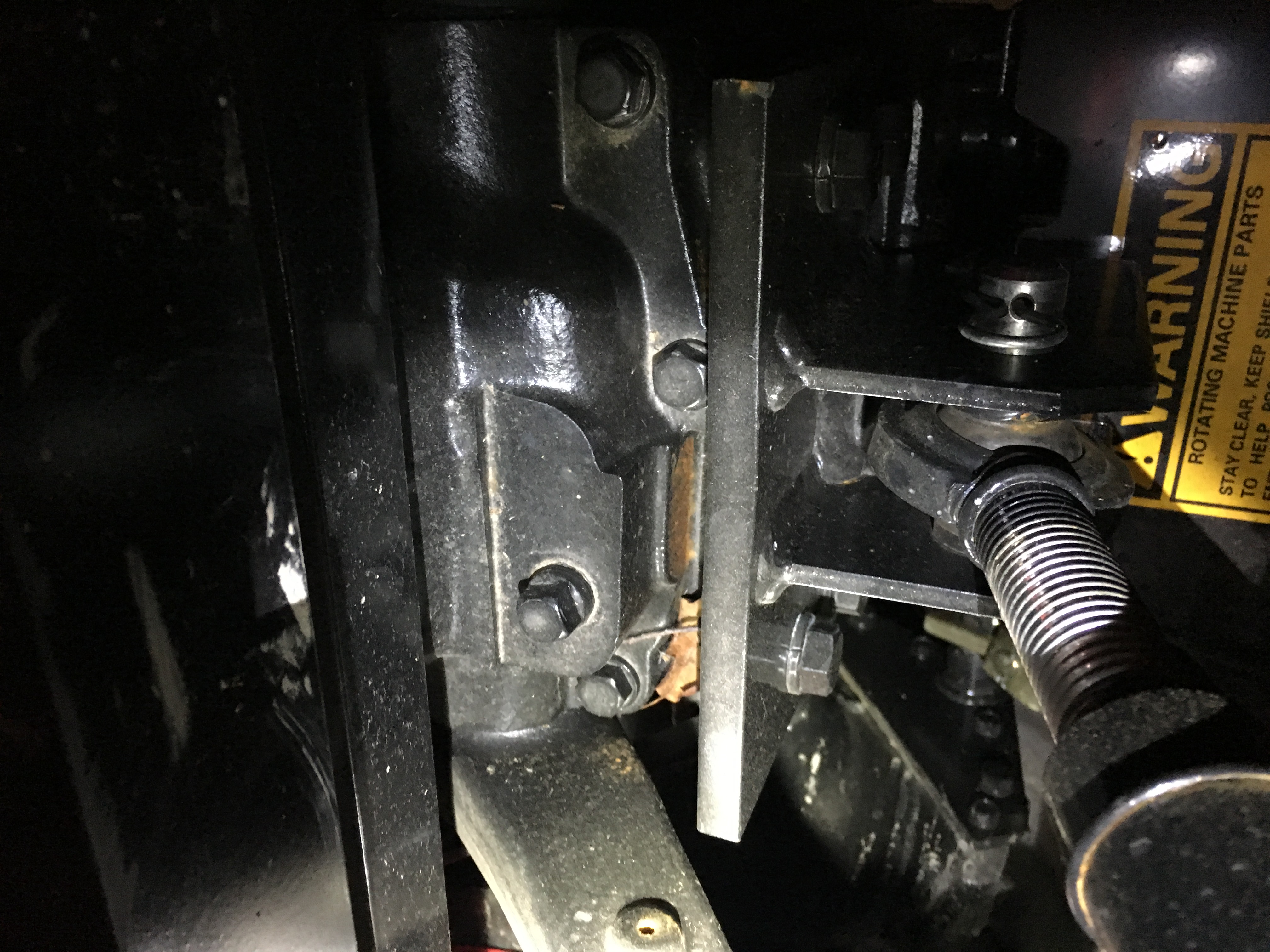

I have a 2017 Mahindra 1538 shuttle with FEL. About 30 hours so far and no problems. When I bought it I didn't want to spend the money on factory remotes. Now I built a grapple and need to install remotes to run it. I bought a Prince 5100 series valve with power beyond installed and fabricated a mounting bracket for the valve that clamps to the ROPS. I've identified the power beyond coming out of the loader valve block and am pretty sure I know how to plumb that. My question is what options are there for the tank line? The tank line that comes out of the loader valve block is hard plumbed to the rear case with a steel line with no easy way to tee into it and I don't want to cut that line. Is there an unused port somewhere on the rear casting that I can plumb the tank return port on my remote valve to?

Thanks Dickfoster. Yeah hopefully someone in the know will chime in. There are several ports on the rear case that are plugged and I'm assuming that one or more of them are extra drain ports. Just want to be sure before I plumb my return into one.

Well I forgot to look at mine (sorry- I know remember your original post) and I’m gone for a week or so. I’m about 90% sure their is a 1/2” or 3/4” NPT plug on top of the case, right under the seat, that will work for the return.

So I dug into things on the tractor today and I attached a few photos. I believe I've positively identified a port that is a drain to tank. It's on the hydraulic valve block for the loader valve. It's got a metric o ring plug in it which I removed and confirmed it's open to the hard line that goes from the loader valve back to the case. I also found the pipe plug in the top of the case about 4 inches in front of the top link pin. I also found two plugged ports on the case under the seat near the 3 point lowering speed adjustment valve. Attached are photos of each. Any thoughts would be appreciated. Thanks Andy. IMG_1358.JPGIMG_1362.JPGIMG_1363.JPG

I made a crude video that I will need to edit and post on YouTube. But in the mean time I can confirm the return line goes into the top of the gear case right under the seat. Their is a removable cover the the seat bolts to that will need to be removed. The cover comes off with 4 bolts and the seat pressure switch unplugged . The cover has the seatbelt and seat attached to it so everything will come off attached to this cover. Once that is off the return will be exposed.

It was pieced together. I found several different style fittings on the machine- o ring, pipe etc. Once you figure out the fitting coming out of the loader control and the one going into the top of the case you should be able to run everything with the fittings you want.

IMG_1389.JPGRNeumann I attached a photo of the ports under the seat. There's 3 of them. I assume one of these is what you connected your drain to tank into. Is that correct and if so which one? Thanks.
