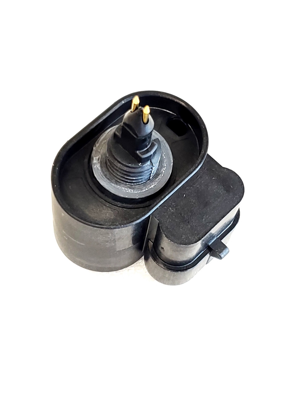

Running into the same issue, how did your second filter change work out. Also, can't figure out how to disconnect the water sensor at the bottom of the main filter.
   / Mahindra 1635 Fuel cutoff? #5
It looks like it must have a rotating sleeve that unscrews then the connector is pulled off--Similar to the old speedometer connections. I don't own a Mahindra so I could be dead wrong but, I just looked at the sensor. (shown below)
   / Mahindra 1635 Fuel cutoff? #6
Thank you. That looks similar to it, couldnt figure out how to disconnect the connector, I'll have to look again.
