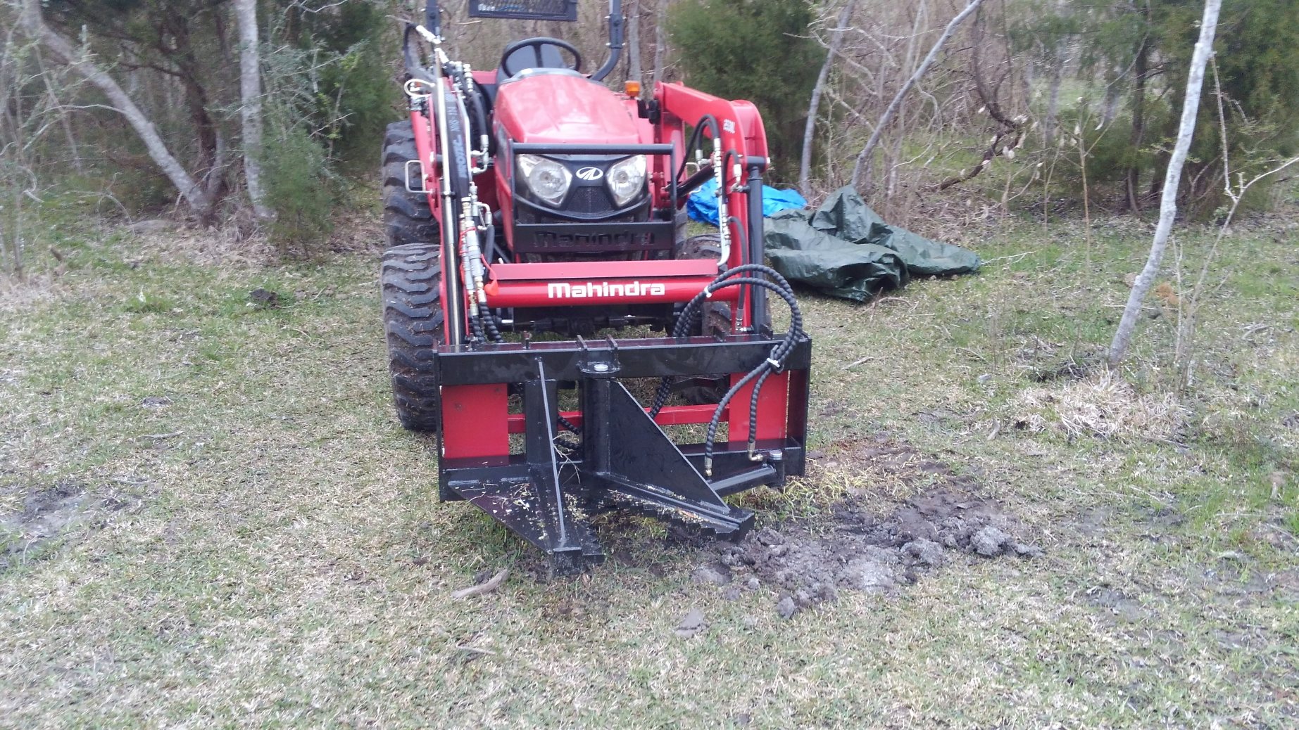

Hello,
I am adding a new joystick valve for the third function on my Mahindra 2538 for a tree puller and grapple.
Does anyone know what the power beyond and tank hose fittings are to the Besko FEL valve ? I thought they were JIC 10 but I think it may be a npsm.
I am going from the PB fitting on the Besko to the new valve power in (Chief p40a1a1). Hooking the original PB hose to the PB on the Chief valve.
Should have took the connections apart the last time I was at the property.
Any help greatly appreciated.
Pic of what I am doing attached (I think).
Thanks

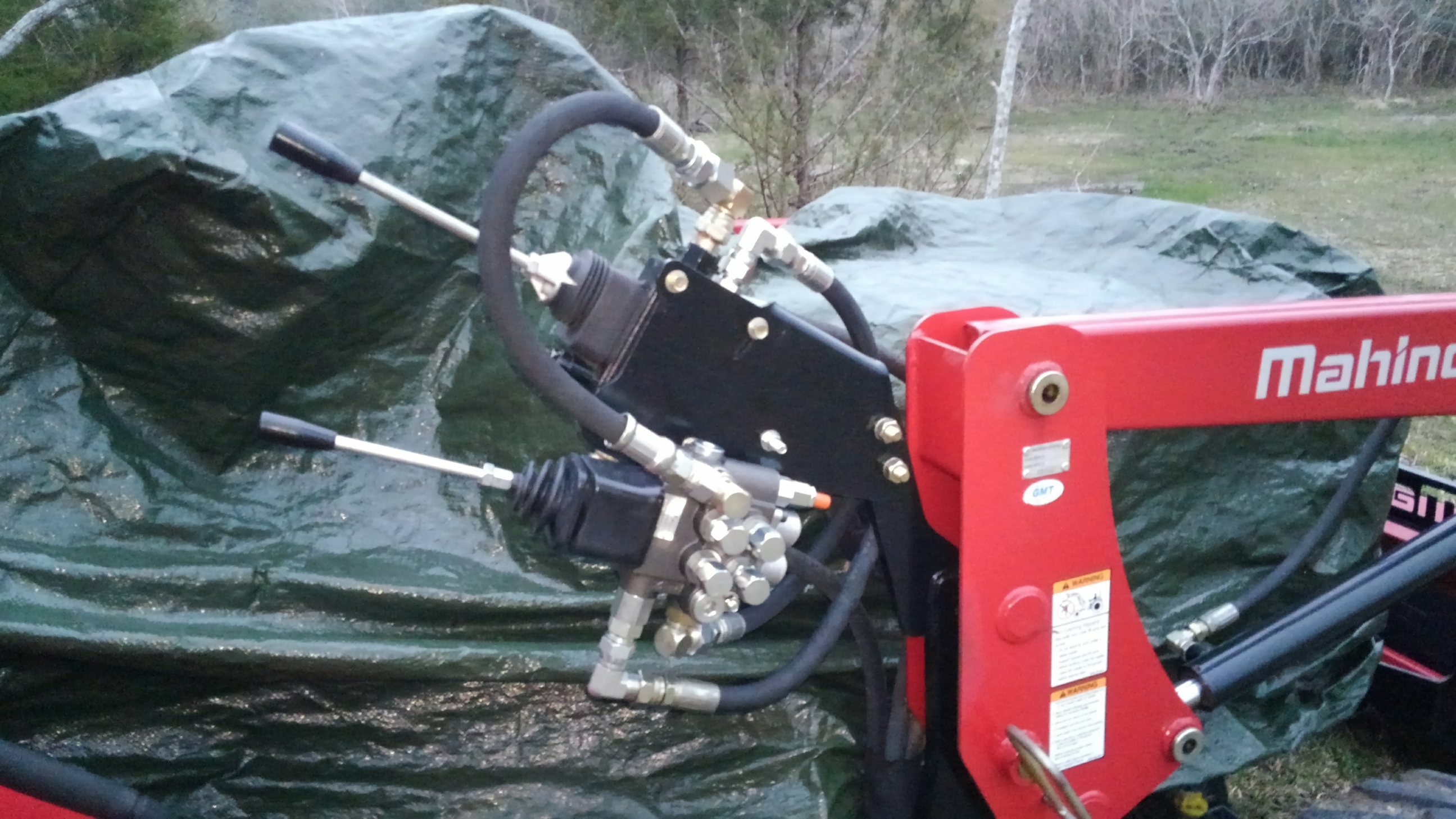

In case anyone was wondering it's all bspp stuff.

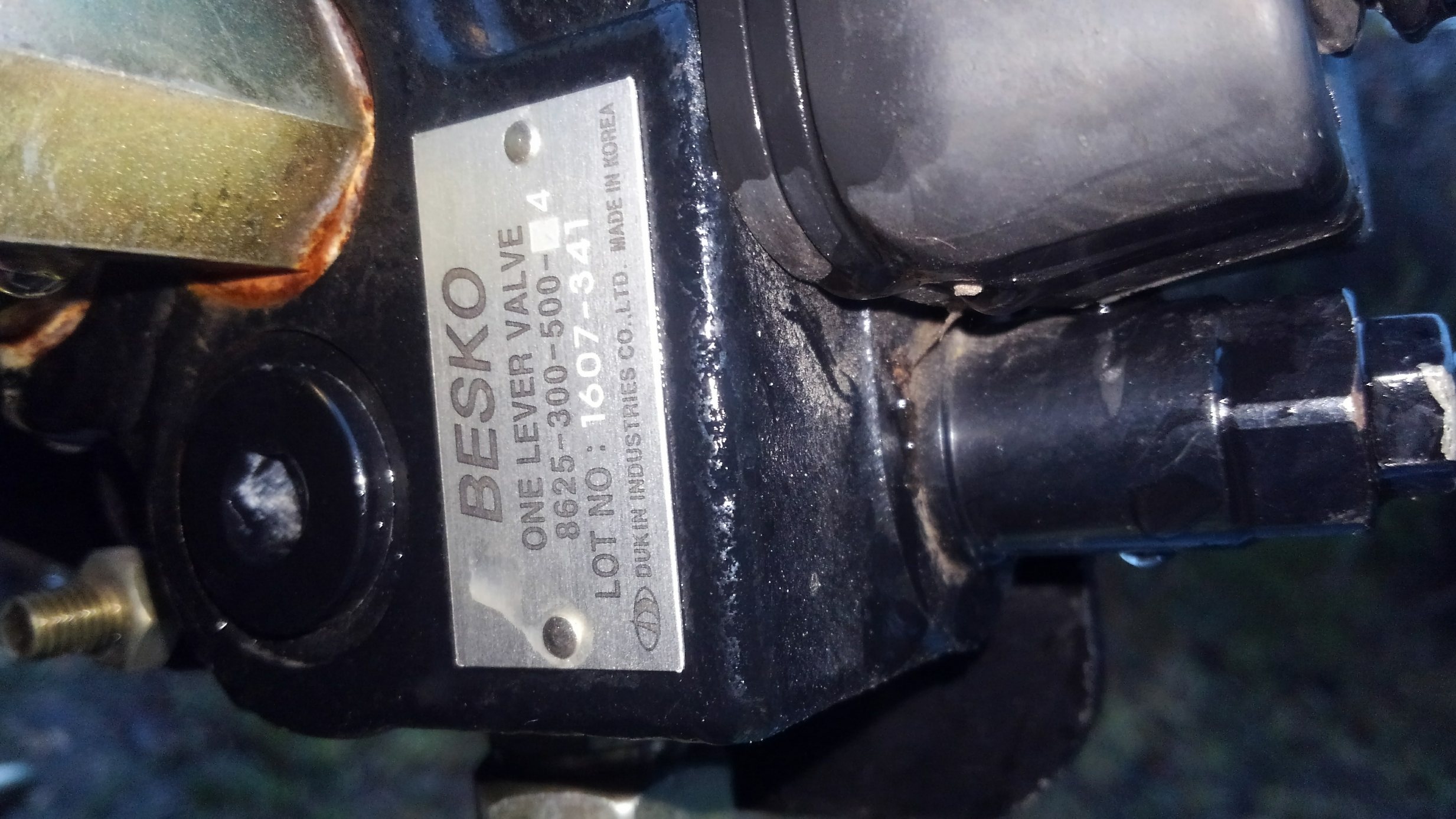

So the Besko FEL valve the power beyond and tank hose fittings orfices all bspp at the valve ... what are your #s on the loader valve....? Kubota 2501 I'm working on has a dasko and I'M curious as to what it is ....besides being a 1000 miles away... IDK?
   / Mahindra 2538 third function

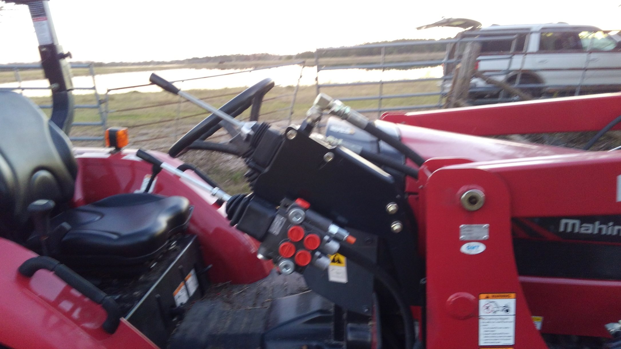

Besko valve numbers, third function works well. Also have a fourth function available. Hopefully pics attached.

I've got the same tractor, what port did you come of off on your besko valve to add the other valve?
