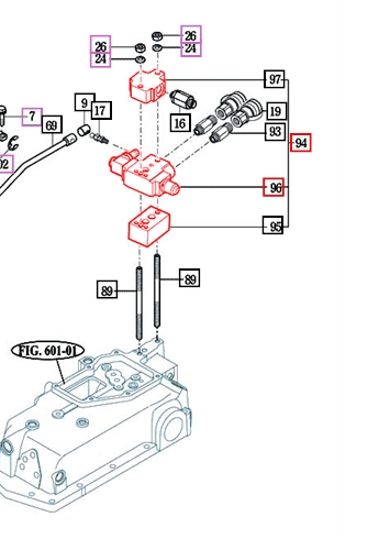

I have a small leak that looks like it is seeping out between the red parts in the pic. Before I take apart, does anyone know if there are gaskets that go between them?

It just uses simple O-rings. You can probably buy a pack of 50 for like $2. You'll need to pull them out to figure out the size though.
