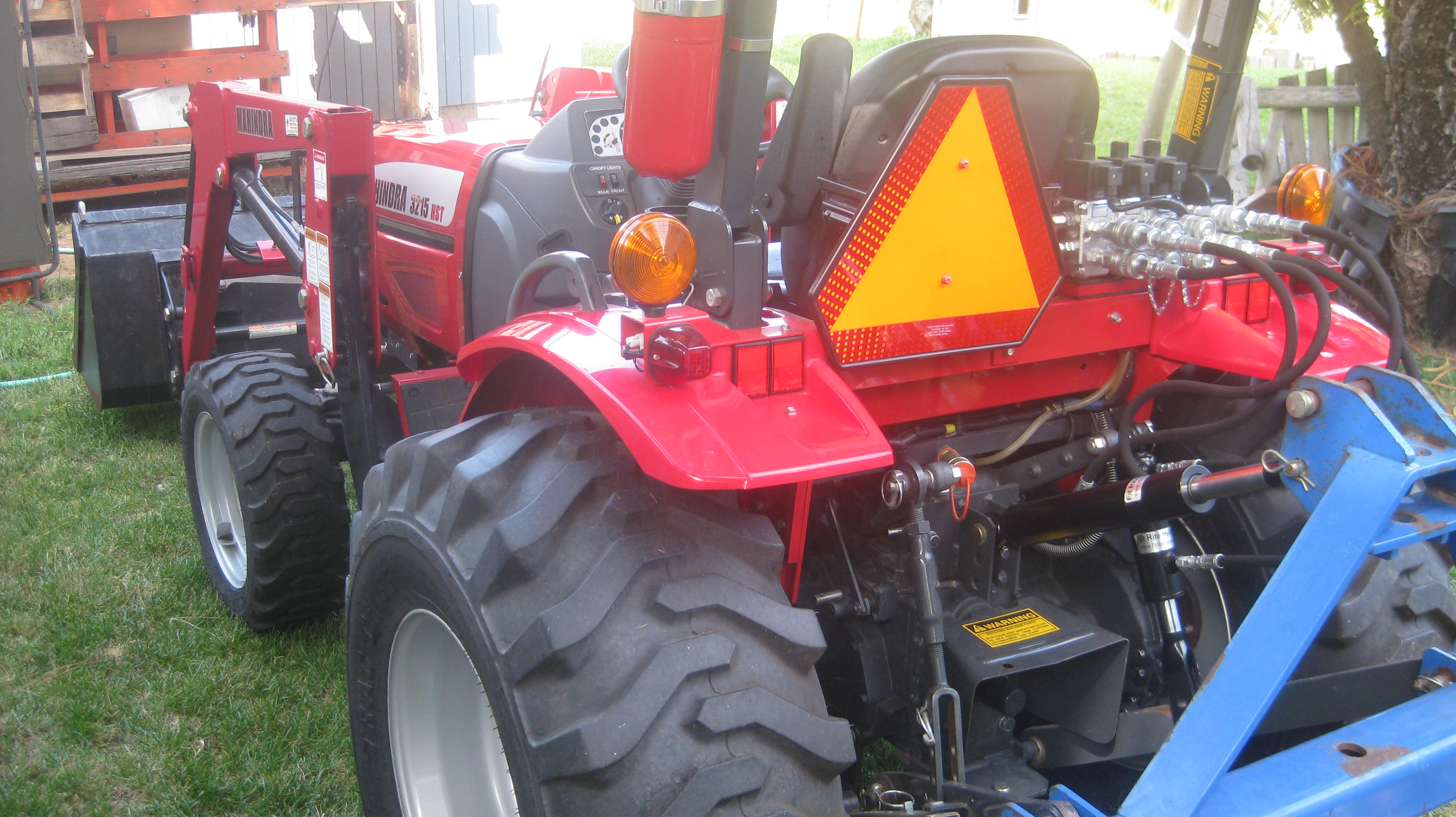

   / Mahindra 2555 HST Cab hydraulic setup options #2
This could give you a third spool in the rear. Uses a toggle to switch between the 2 sets.

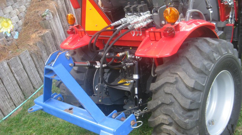

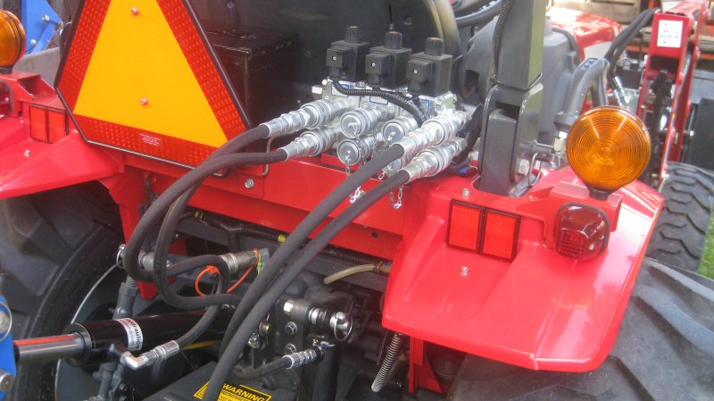

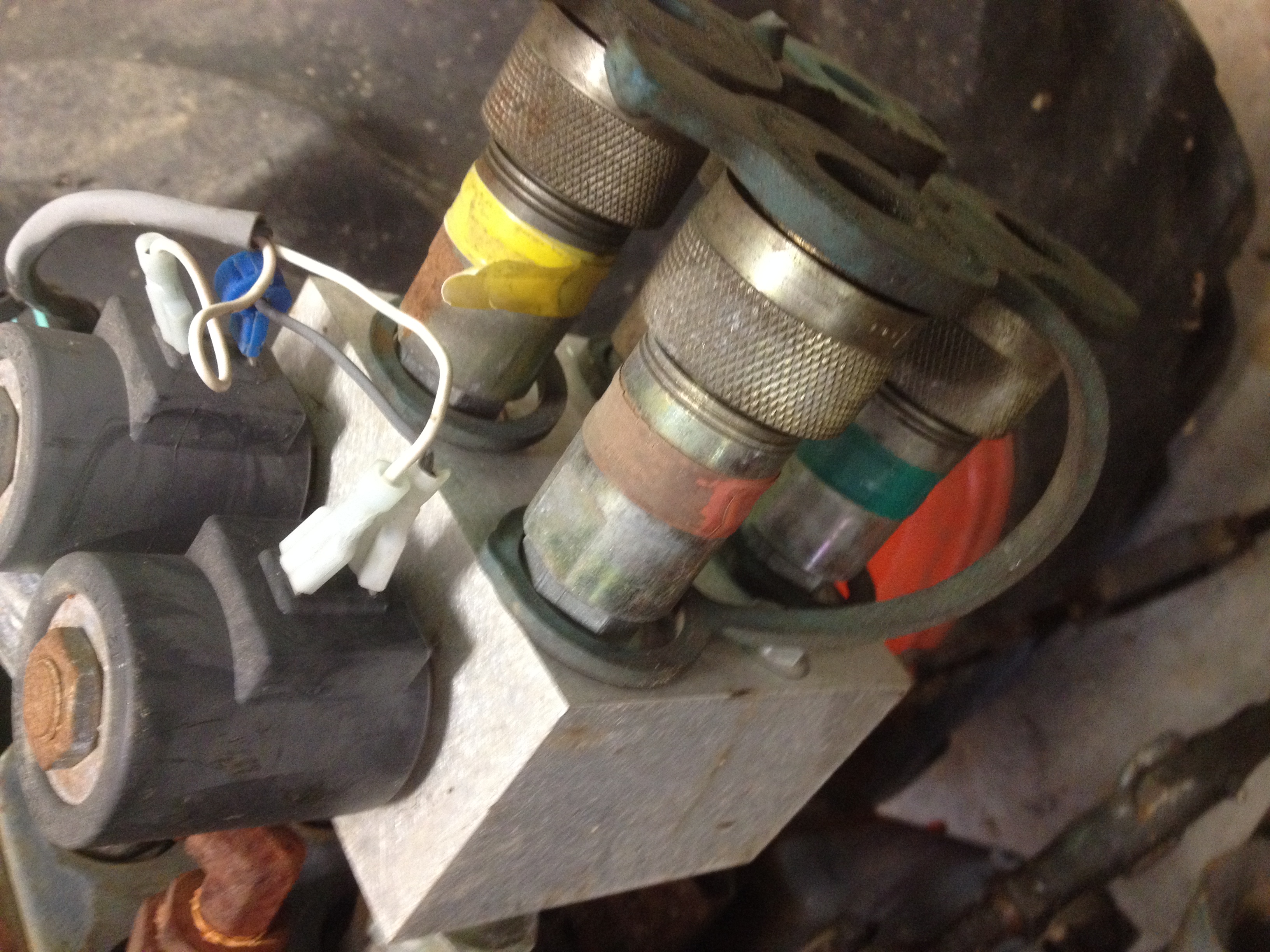

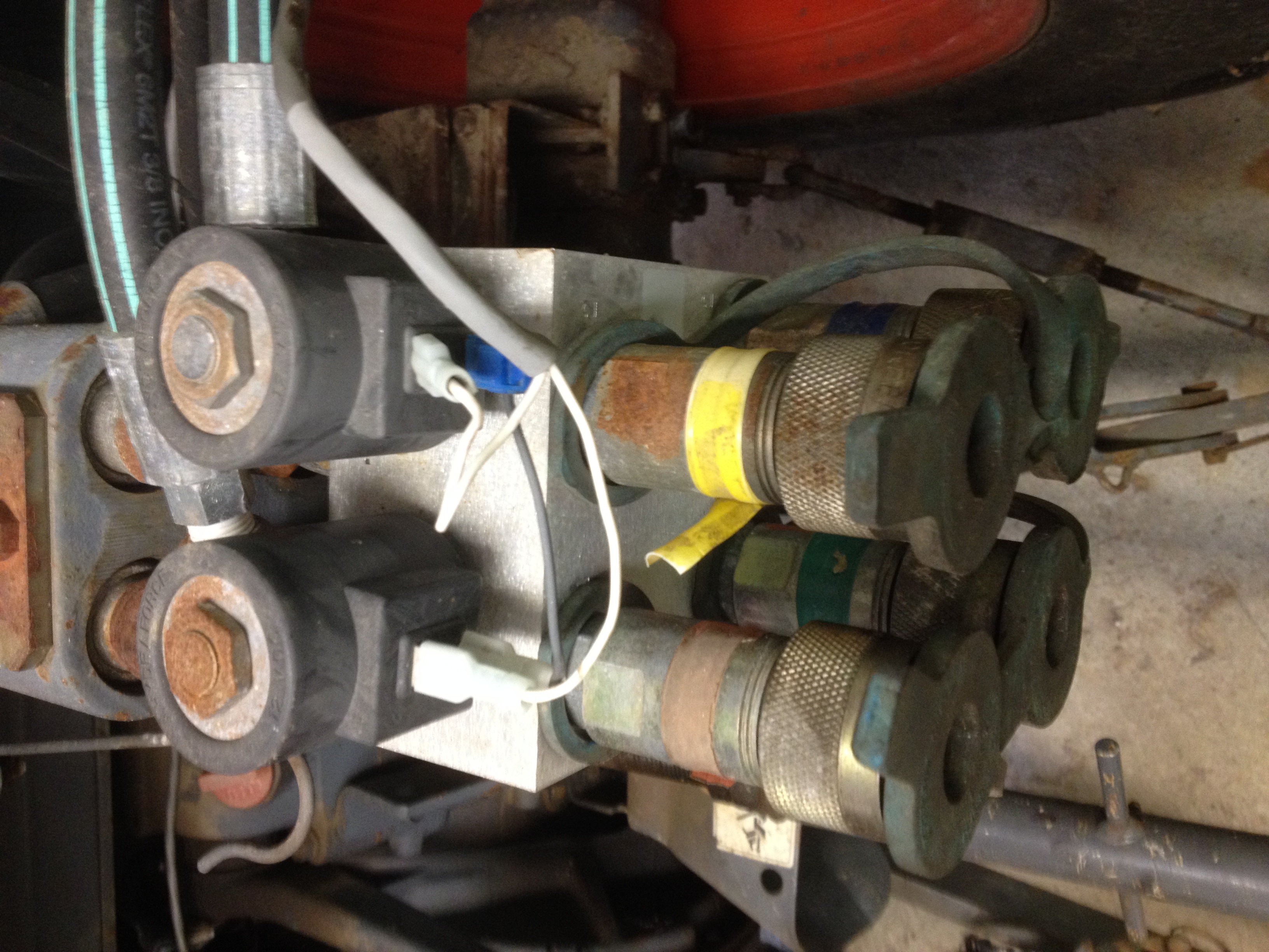

My tractor only has the factory capability of a single rear remote, I now have 4 sets.
The grey control grip has 3 separate switches for each of the 3 diverters.
My recommendation for you if you are going to be doing grading would be to get a top & tilt set and the triple diverter system. That will get you 5 rear remote sets, that should get most everything taken care of. I wouldn't be concerned about making multiple adjustments at the same time. Unless you are doing this for $$$ and one of the better operators that there are, you should only make singe function adjustments anyway.
In reality you only need 4 sets, no good reason IMO to have blade tilt when you have hitch tilt. ;)
Just my :2cents:
