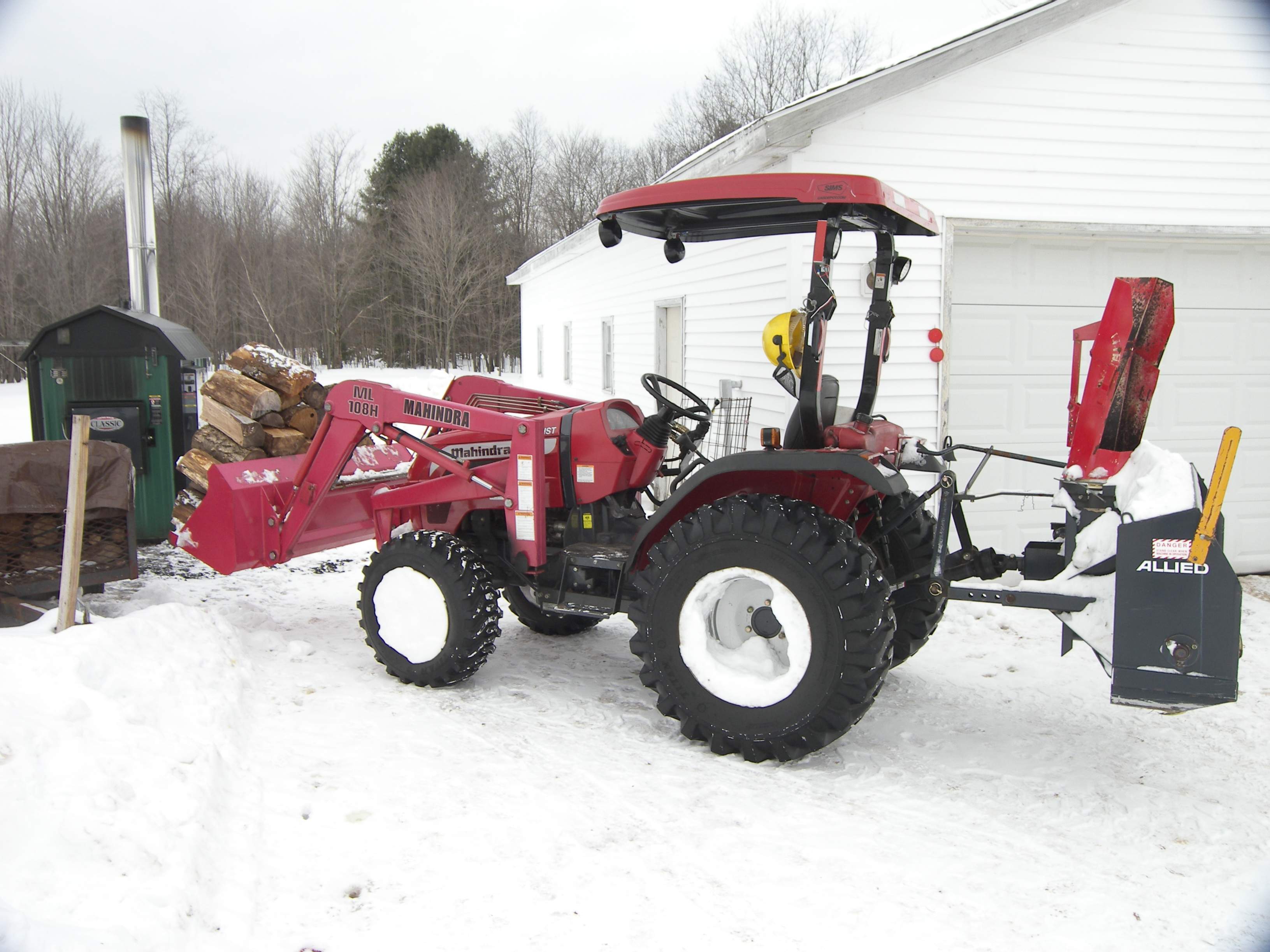

Hi Sarge 1956,
I am the proud and happy owner of a 2810, almost the same model as you
are looking at, and i found a ML106 loader and installed it myself. It was an easy job and I was very happy with Mahindra and KMW compatibility! My loader has a tie in to incorporate front and rear as one unit. I have owned several tractors with BIG loaders on the front and have never broke one in half! Reason being. . . a subframe which ties front and back together.
Please do your checkbook a favor and buy one the ties the whole machine together. its more expense to start but it will save you much aggravation in the long run. :thumbsup:
The ML106 is a light loader, but. . . it can lift stuff a whole lot easier than i can pick it up. good luck . . .John
P.S DON'T FORGET TO GET THE QUICKTACH "TOOL BAR" it's a "Got to have" item! You can take the bucket off in about 2 seconds with no effort :thumbsup: :thumbsup: :thumbsup:
