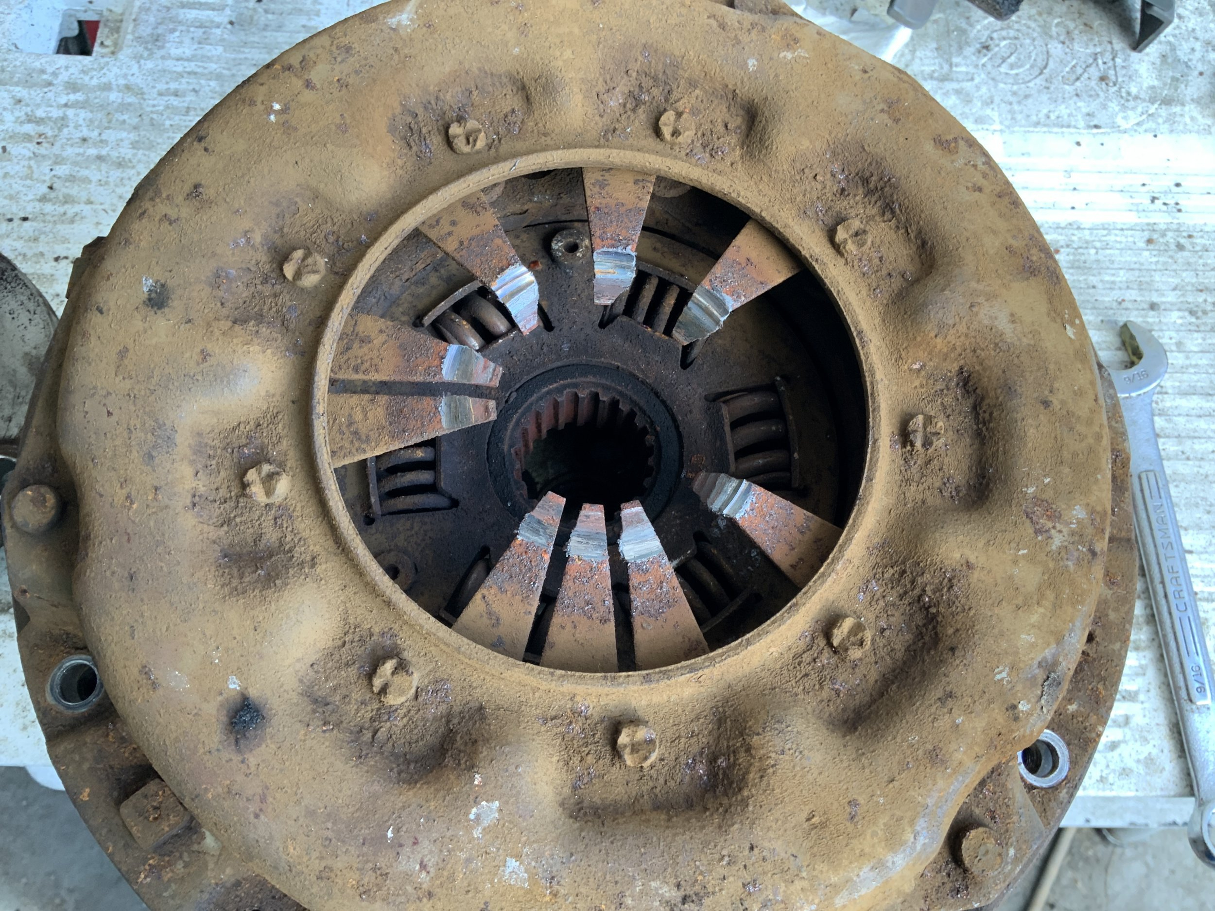

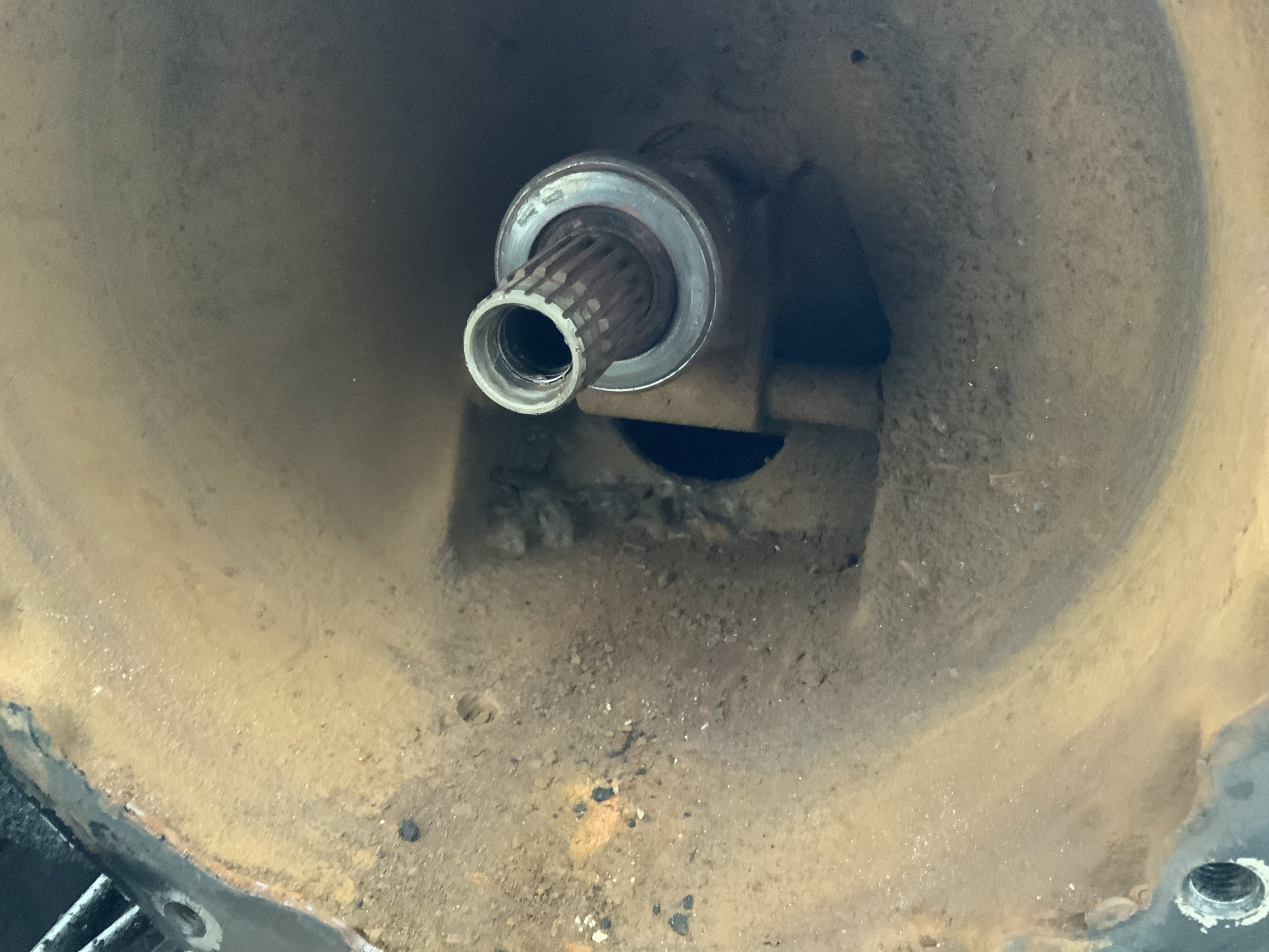

Thank you that is helpful. Does it also give the torque specs for the flywheel itself? I’m taking the flywheel to the machine shop tomorrow for resurfacing.
interestingly enough, the clutch itself still looked good, however the drain plu was still in the bell housing, and it retained a lot moisture. It was still wet and rusty when I cracked it open. The moisture got into the throw out bearing, and caused it to seize up. This caused it too eat all of the teeth off of the pressure plate. I was also considering some blue permeates for the mating surface between the engine and tranny, to help seal out the moisture. I would have to assume that it came in through the top of the bell housing, and couldn’t get out due the drain plug in place. I believe this should have been removed.

Another point of interest, is that when I took this apart, I found my loader bolts to be loose! I didn’t realize that this had happened. I would advise folks to check them. mine looked solid, but I never thought to put a wrench on the to check them. Lesson learned.
i still need to get the throw out bearing removed, and the linkage will need to be cleaned and greased, as it is stiff from corrosion/rust.
