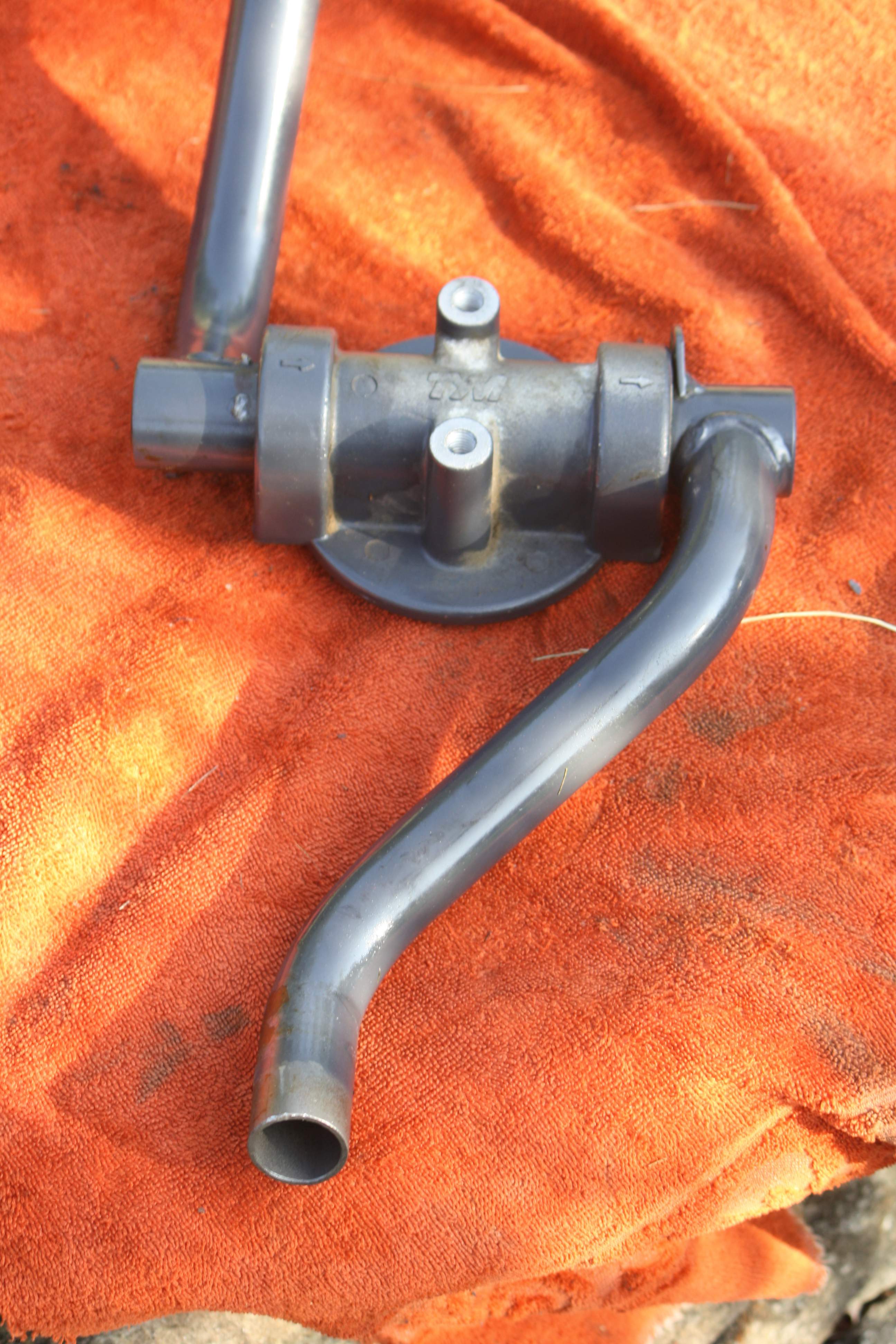

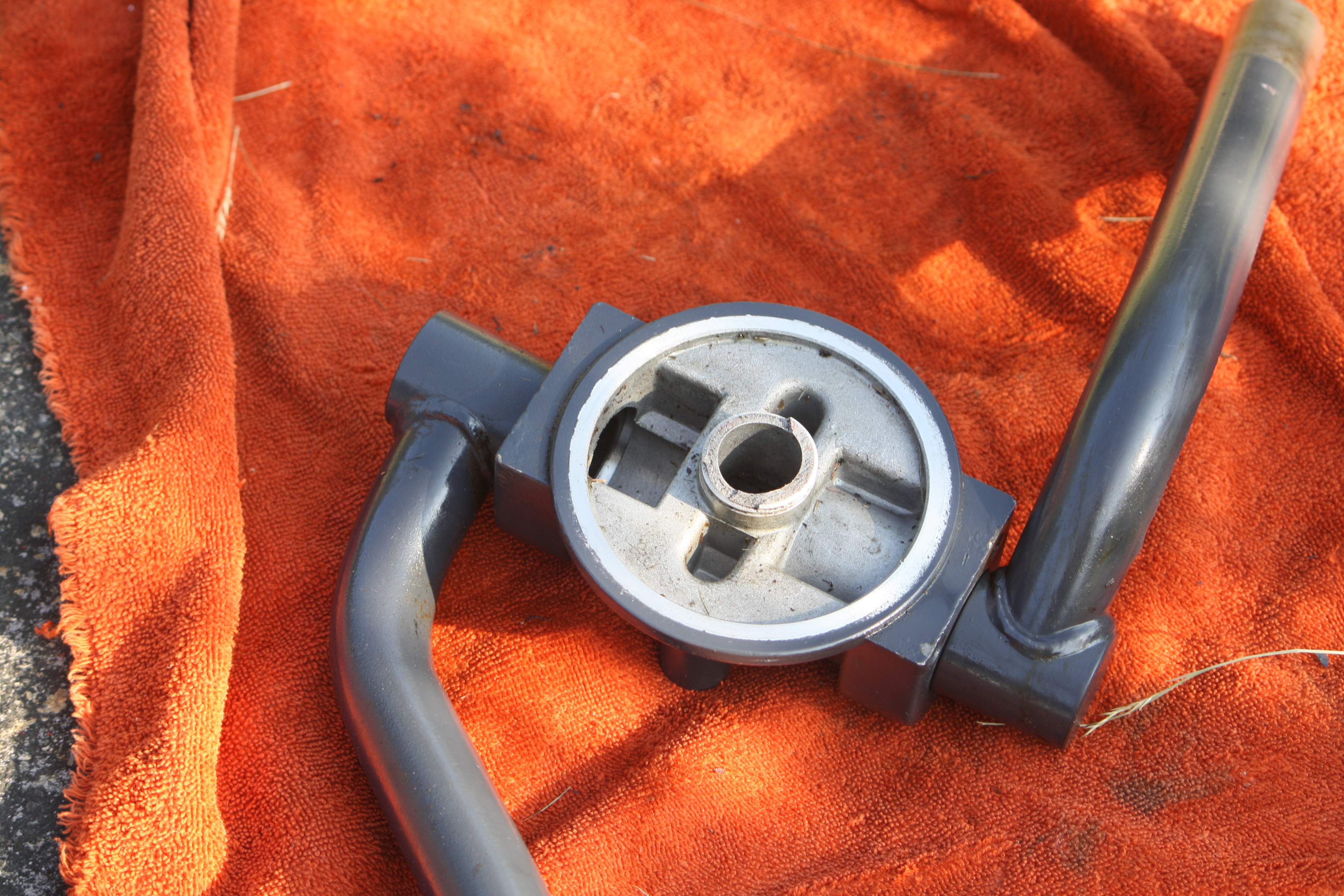

Hello all,
I'm a relative newcomer to the tractor world but already need help.
All I did was to hit a stump! The filter snapped off the part of the base that screws it screws into, and the inlet pipe attachment to the filter also broke. I'm having difficulty obtaining the part numbers and a place to order on-line. it is a TYM base and the TYM filter number is 12305152100. I've seen the bases advertised on e-bay and they don't look much like the one I have (photos included).I haven't been able to get even close to a number for that pipe.
Thanks

I don't know where your filter is mounted and am not familiar with your model tractor, but the folks at wixfilters.com may be able to help you. They have several models of remote spin on filter adapters. You may even be able to mount that filter in a less exposed place.

Here is the link( ignore the error just click it and it should work)to our online parts look up for what you looking for, the filter base im pretty sure I have instock the pipes i would have to get out of Mahindra's warehouse.

yeah i love Mahindra Parts Online parts look up!
In case someone comes searching along with the same problem ill include the part numbers..
#12305152000 HYD FILTER ASSY (Filter base and filter)
#12305152010M HEAD, FILTER HYD
#12305152100 FILTER (HYD SUCTION)

Thanks for the info and I will be using New England Tractor in the future. I ended up having my dealer get the parts (at a considerable cost) before I saw your post. One worthwhile tip from him though that made it worthwhile. Make sure to clean up all the oil from the pipe fittings, or the pressure will blow the hoses right off. So far it all seems to be holding together.
Thanks again to all who responded..
