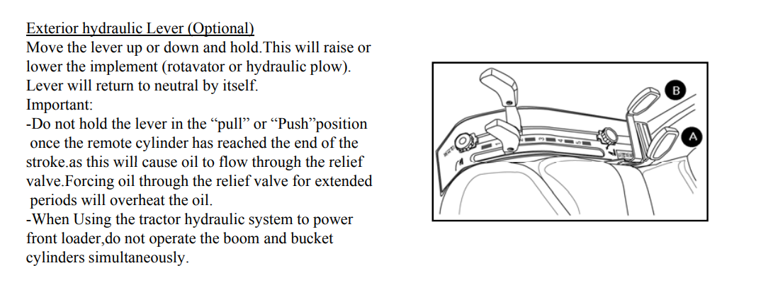

Are the levers shown as B and A in the photo used to drop the digger attachment (B) and spin the digger attachment(A)?
   / Mahindra 3510 maintenance #5
Those are the rear remote control levers to operate whatever implement you have attached to the hydraulic connectors above the 3 pt hitch. My 4110 came with only one set and uses the lever closest to the seat. I tried for YEARS to get the components from Mahindra for the second set and they could never source them for me so I could have 2 sets of remotes. If your tractor has both, feel extremely lucky !!
   / Mahindra 3510 maintenance #6
The pto shaft is what creates the spinning.
You should have two switches plus a lever to engage the pto.
Both of these switches need to be "on" or else the shaft will not turn.
