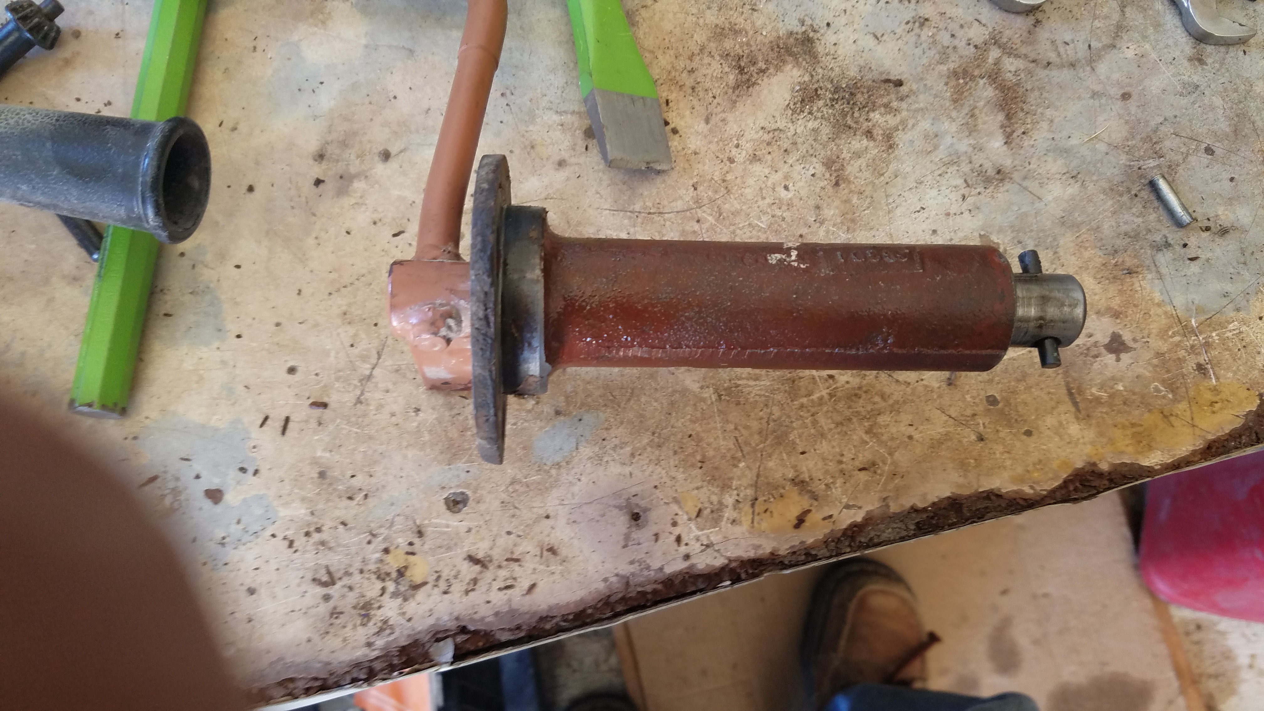

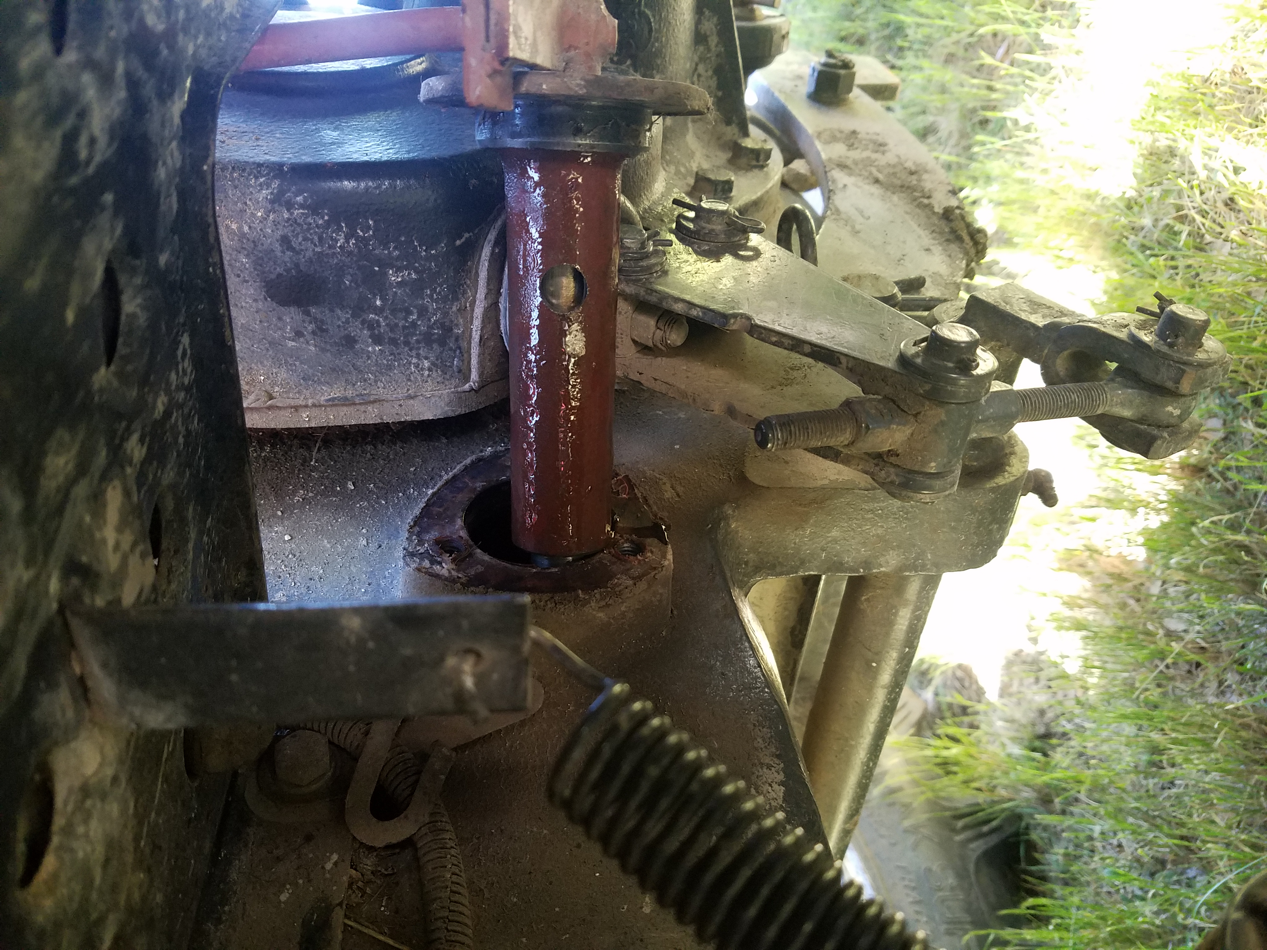

Hello, I have a Mahindra 3525 that I tried to engage the PTO lever and it went clunk and now the lever is loose. It was hard to engage and I read that you can remove the lever by removing the three bolts that hold the lever in housing. I did that yesterday and found the sheered roll pin that was broken. However I don't know it connects to the other type of shaft that engages the PTO and keeps it from going limp, I am just not sure what I need to do. I have added a photo of the the lever with the roll pin any help will be appreciated and thank you in advance.
