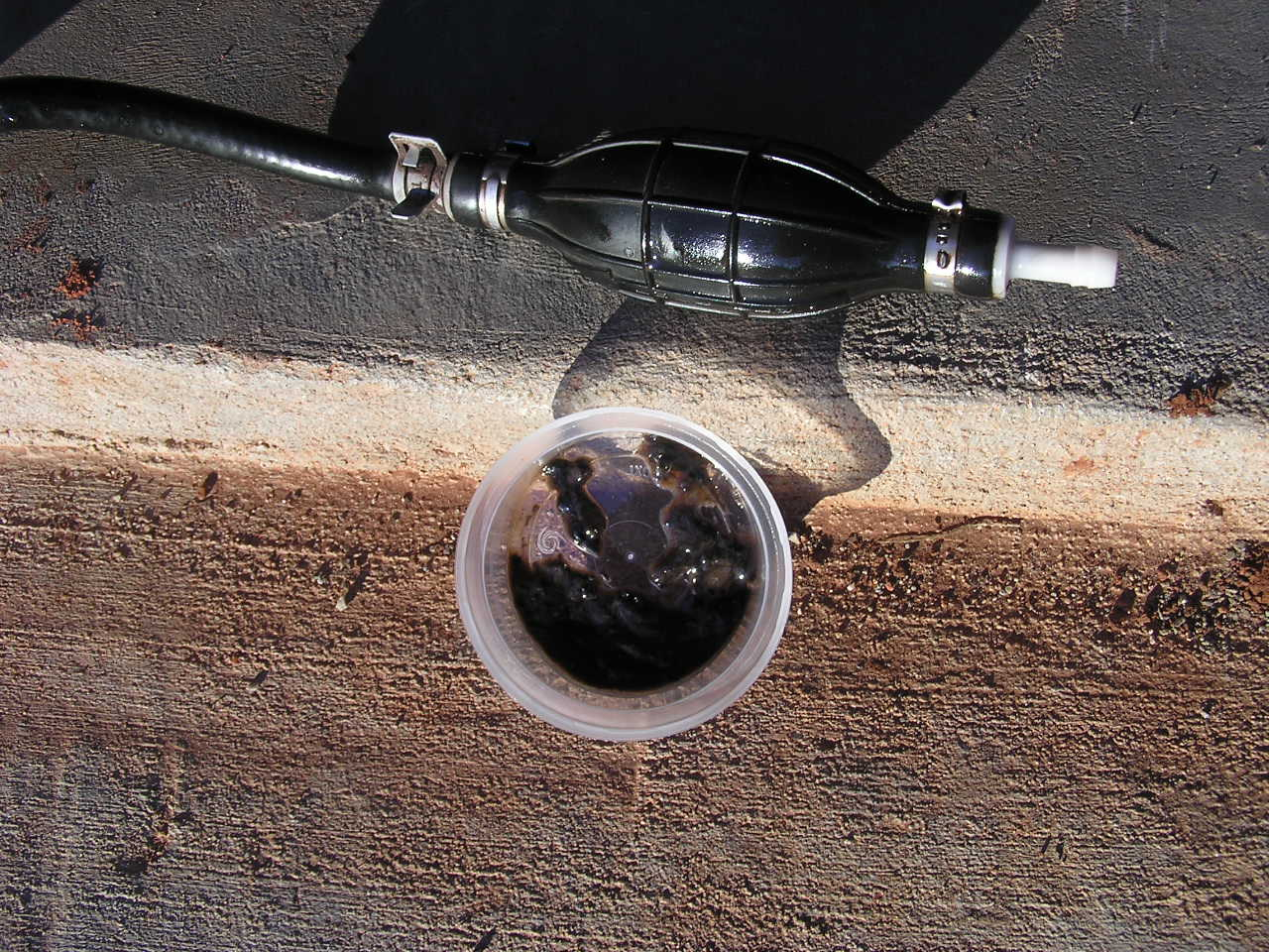

the black fuel sounds like contaminated black algae. Add a biocide to your tank
   / Mahindra 4110 lost power after topping fuel from can looked filter was black dirty #6
Biocide might kill the algae or ****** its growth. But it won't help an existing clog.
If the filter is clean you need to check the flow from the tank to the filter. There is likely a glob of algae plugging the fuel pickup in the tank or the fuel line or filter housing.
If you have algae in the tank I recommend draining the fuel, dropping the tank and washing it out with soap and water and a lot of shaking. The algae is resitant to petrochemicals including carb cleaner but soapy water lifts it right off. I'm not sure how to clear out the fuel line.
   / Mahindra 4110 lost power after topping fuel from can looked filter was black dirty #7
---------------------------------------------- I don't know if water would cause fuel to turn black. --------------------- All ideas are welcomed.
All Have a good weekend and be safe. ....Coffeeman
Did it look like this?: V417 Versahandler Quit Running. Look what came out of the primer.

My filter matched that picture, very black. We drained tank. Put in stuff for water and some kind of biocide for algae got from NAPA . Fired the Mahindra after put in 5 gal fuel and NAPA additives. Ran the whole day yesterday and nary a hiccup from my Mahindra.
