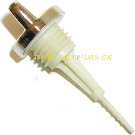

Sorry, I should have been more specific. The engine oil dipstick. I know where transmission and hydraulic dipstick are.
Its about 3/4 down the side of the engine block and is just a small tab that you thread out.... looks like these as far as shape but yellow plastic or black plastic
