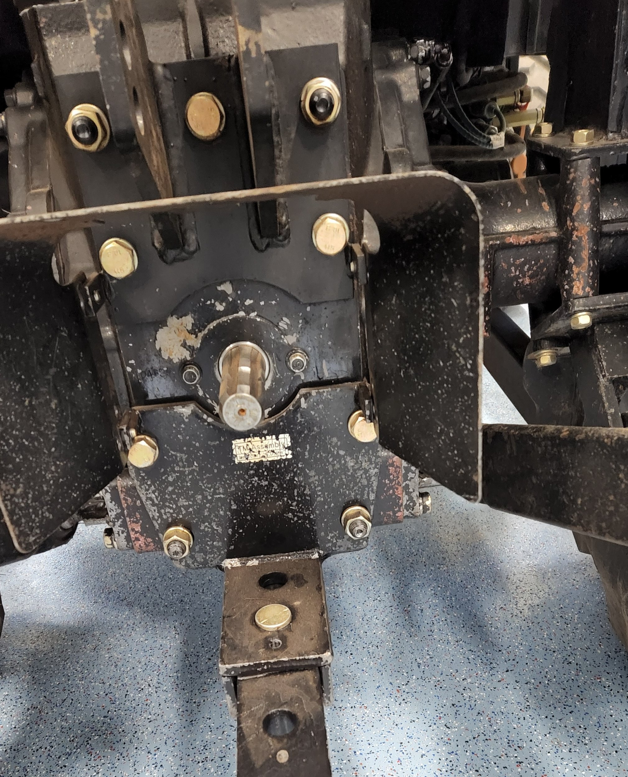

I have a big leak at the PTO shaft and am preparing to change the seal. Was wondering if anyone with specific experience with the 5010 can comment on any advice/pitfalls. I have a factory service manual but I cannot seem to locate the relevant section in it.
I believe I have found the right part# after a lot of searching, #16322732010. There is also located next to it on the parts diagrams a #14522200041, PTO shaft sleeve. Does this need to be changed as well? How would it be removed?

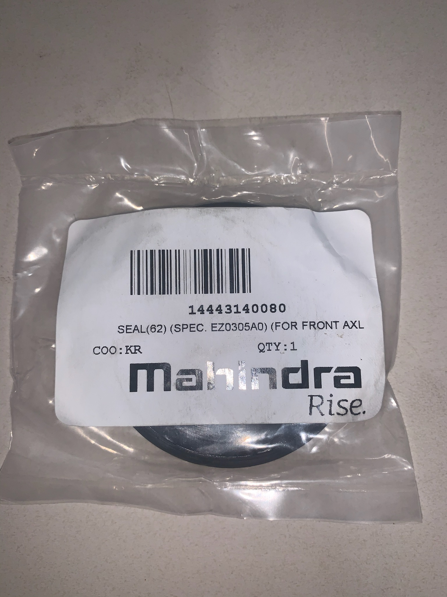

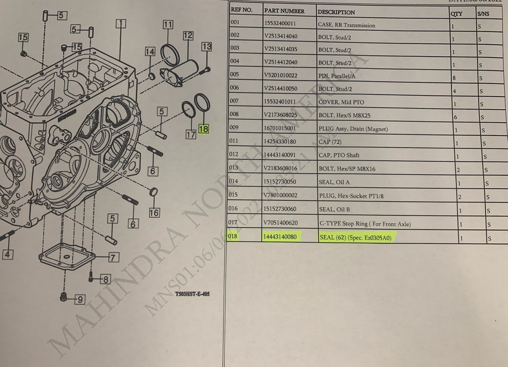

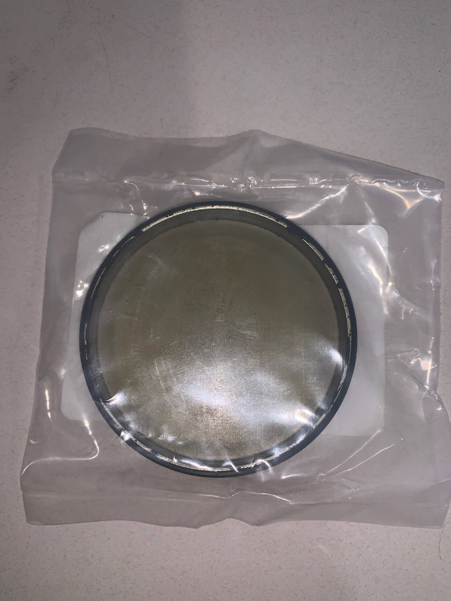

thanks for some suggestions. my tractor is a mahindra 2655 hst cab. i did know how to change the seal and it is a single seal. i even tried using one that was one mm smaller ID and still seeping. i contacted mahindra and found that a potential fix was to drain it down, take the plate directly below the pto shaft off (4 bolts) and there is a seal that has a steel rim and rubber middle that could be leaking and needing replace. it covers a port that is not used in my unit and many others. so it is covered with this flimsy rubber cap. since i had it at the dealer, they replaced that seal (cap/plug) and it totally fixed what appeared to be the pto seal leaking. they used the original pto seal. it has been over a week and not a drop. now they are contacting the other 3 mahindra customrs of theirs that had the same problem on how to fix it. the seal is 8 bucks. btw, the original pto seal (not this plug/cap one to fix this problem) is a mahindra
16322732010 - SEAL, Oil Tc6Y417211 it is a 41mm id, 72mm od and 11mm thick seal.​
hope this helps someone. i have seen there are a number of folks that have had a leaky pto seal that was not fixed with a new seal. i dont know the model range of tractors that this fix will work for.​
