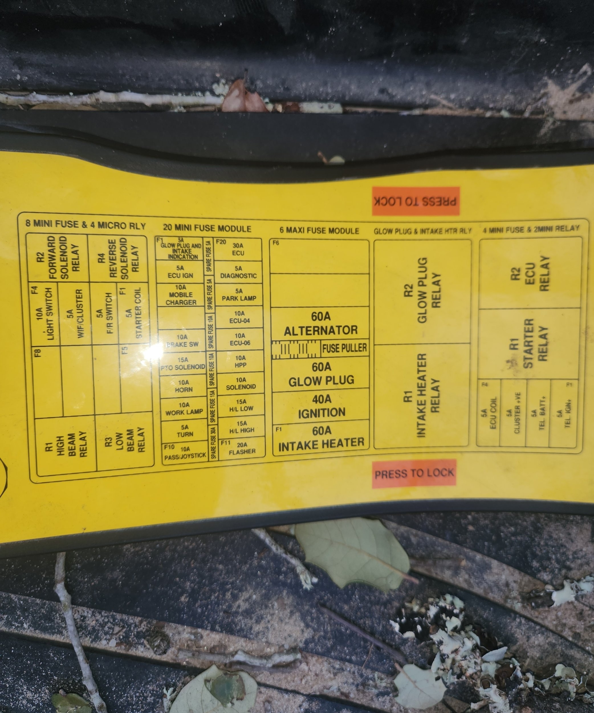

Does sound suspect.
You can check and discontinue the alarm to see if it would obey forward with a reset trying this:
1. Turn on ignition key but do not start. Leave ignition in ON position.
2. Verify the dashboard Oil Pressure and Battery indicator lights are on.
3. Remove the fuse labeled "reset" from the bottom fuse box. You can use the puller provided in the top fuse box.
4.Press and hold the Trip Button and keep holding it for the next few steps.
5. Turn ignition off for one second, the back on for two seconds, do that a total of 5 times.
(Left hand holding down trip reset button, right hand turns ignition switch: off, on (1), off, on (2), off, on (3), off, on (4), off, on (5).
Leave the ignition in the ON position.
6. The instrument panel will do a self check after 5 cycles of the ignition switch.
7. Release the trip reset button after panel self check is complete.
8. Replace the fuse.
9. Press and release the Trip reset button. The service minder light should go out.

There is no fuse labeled "reset"
