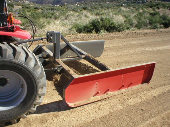

They do not have them on the website, so I would say no. Here is a picture of one.

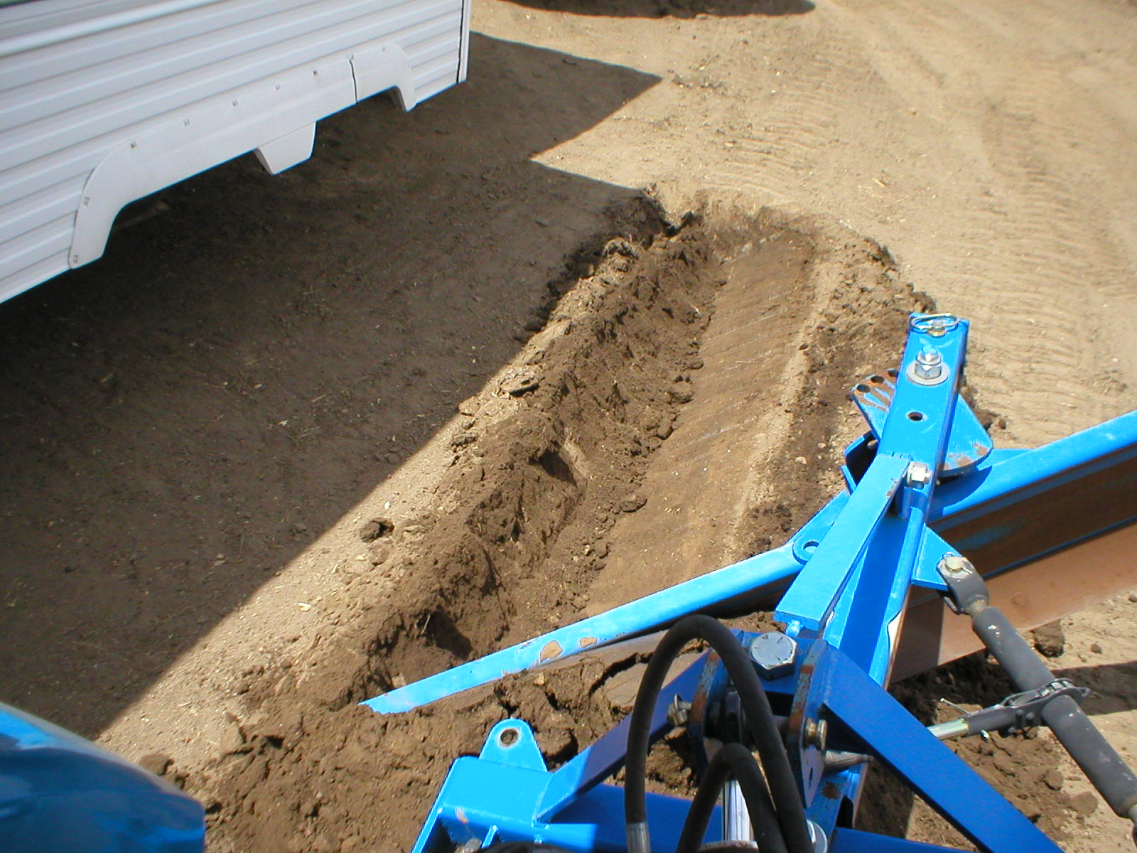

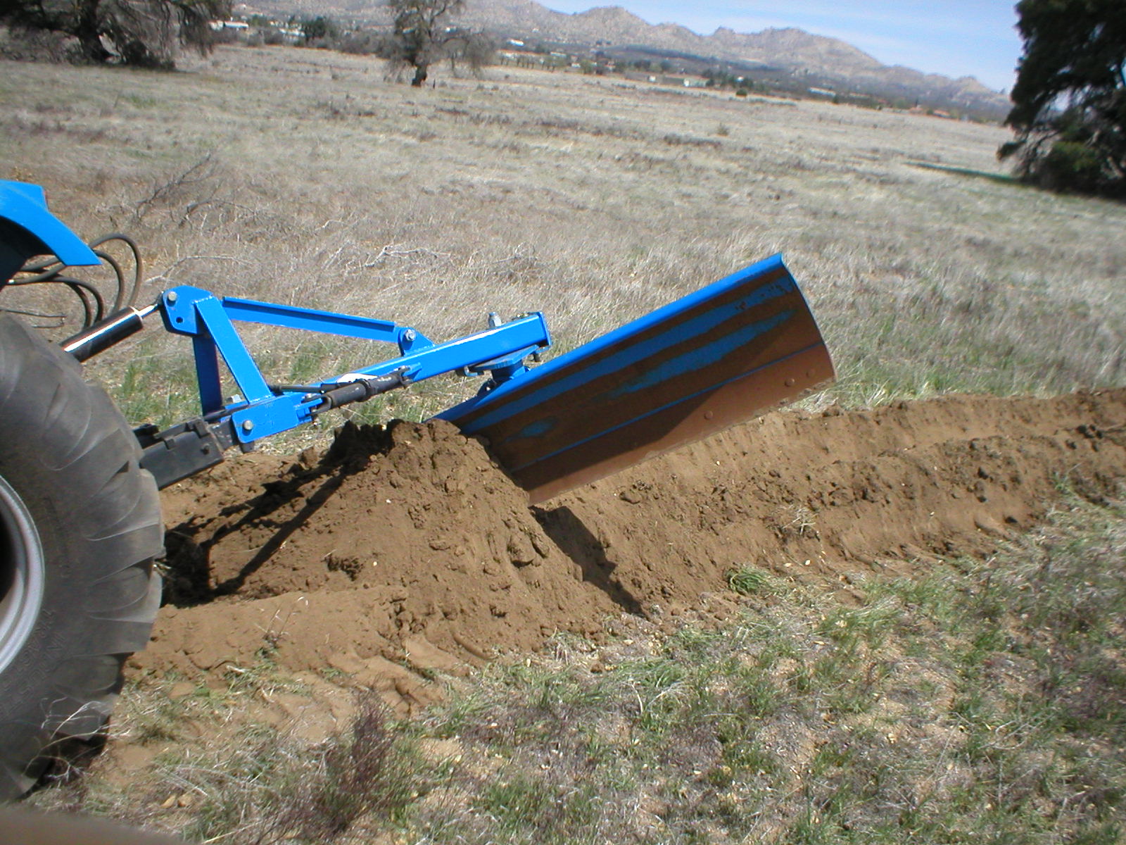

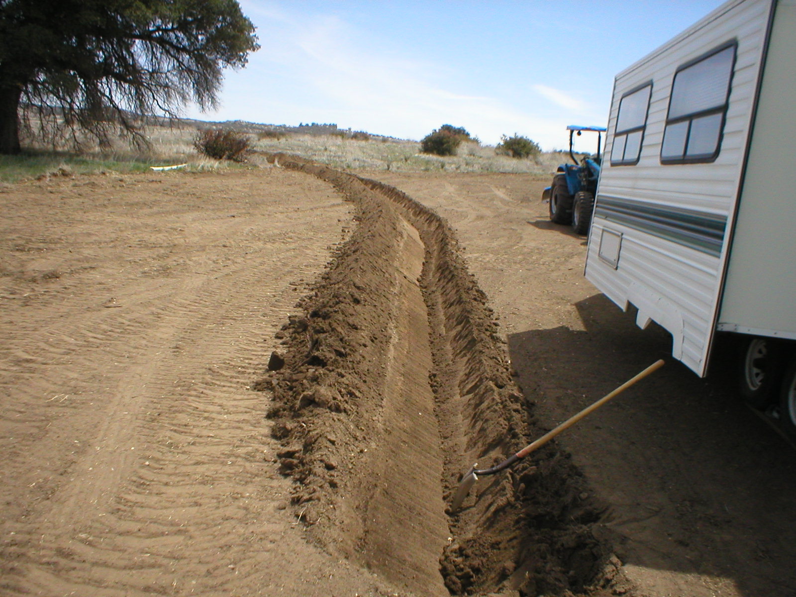

Video Looked interesting? I guess riding on runners keeps machine from digging or riding in air depending where front wheels of tractor are? Is there any kind of machine that could dig a ditch on side of road? Sort of like a cultivator that used to be used in corn field. Something that might over lap past rear wheels digging a crude ditch. Big enough to carry a strong spring that runs year round.

Search Google for landplanes. Also youtube has videos of them in use. Everthing Attatchments sells them also. You could check out their web site. A Higher end rake with gauge wheels will probably be comparable in price to a landplane. Hope this helps.

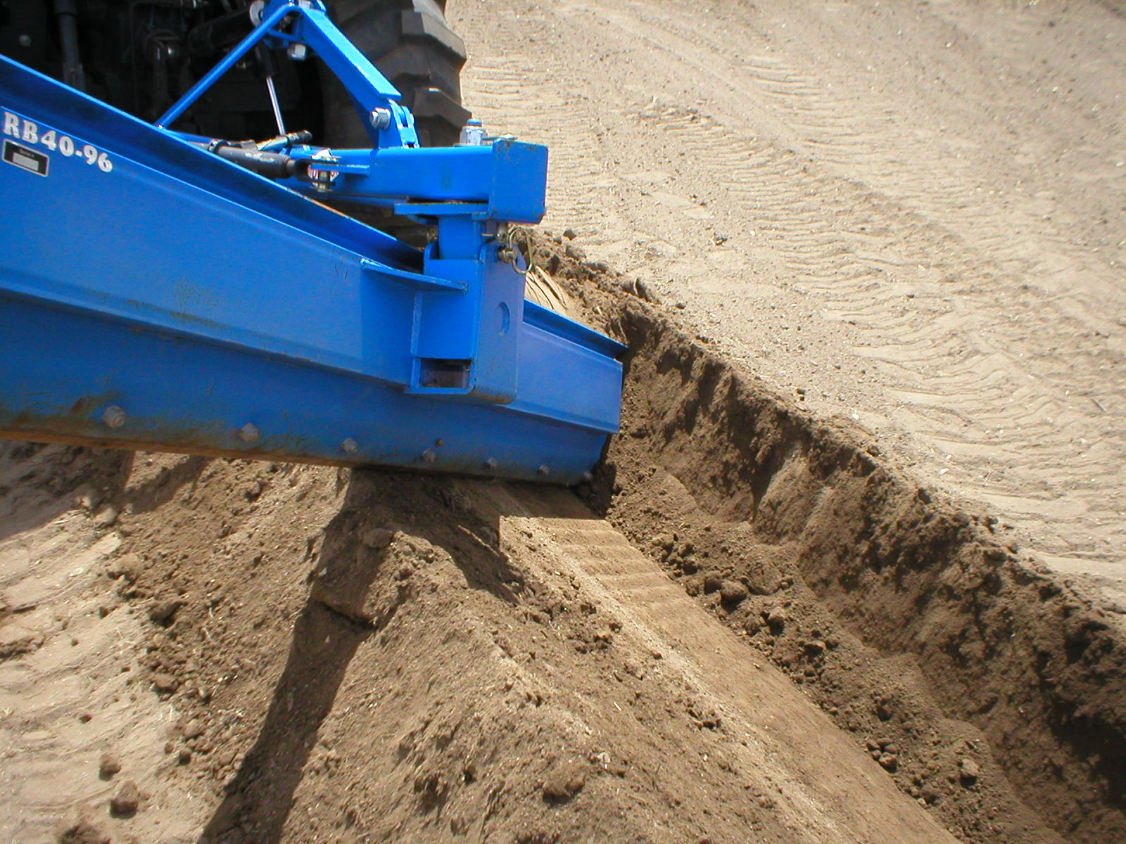

A tilting rear blade can used for what you are asking. Nicer when they can be offset also.
