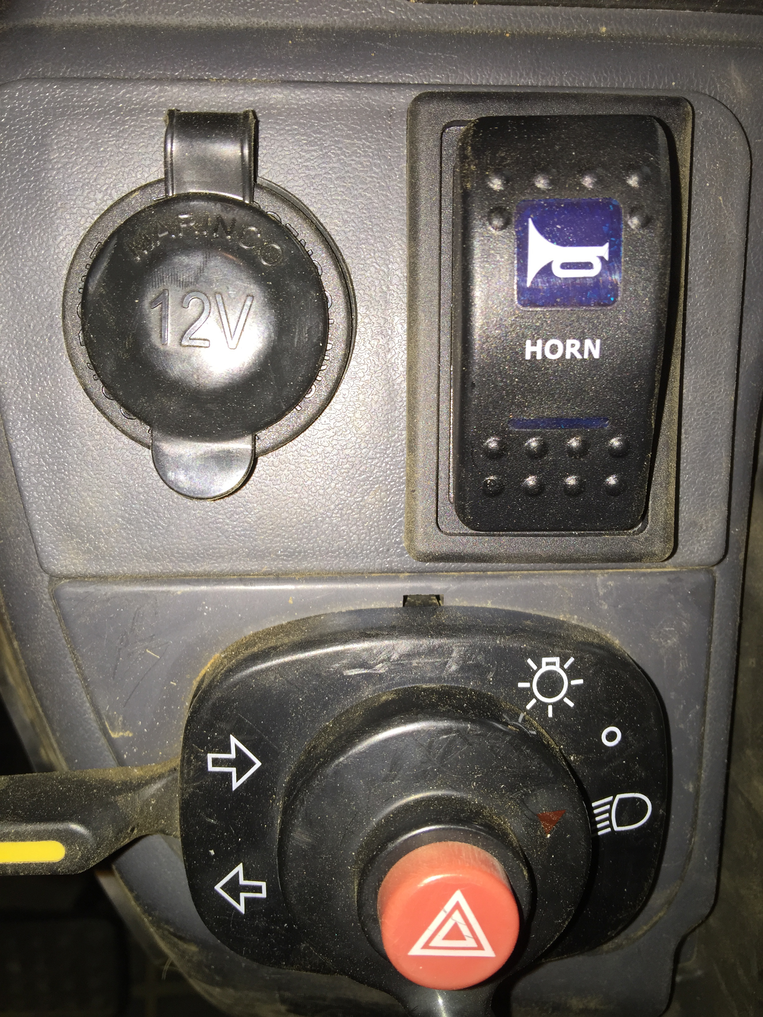

I recently add a 12 volt outlet to the dash of my tractor ( http://www.tractorbynet.com/forums/...ing/349764-12-volt-outlet-mahindra-max28.html ) and figured while I was at it and had everything apart, I might as well add a horn.
IMG_6101b.jpgI ran a dedicated line from the battery to the dash (using the same wire loom I used for the 12 volt outlet), and installed a Carling Contura (SPST momentary) horn switch right next to the previously installed 12 volt outlet. The best place I could find space for the horn was right under the loader arm on the left side, by the leading edge of the floor.
IMG_6105b.jpg This view is the left side of the tractor facing rearward. It would have been nice to find a more protected place for the horn but there just isn't enough room anywhere else. I figure as inexpensive as a replacement horn would be and the ease of access of this spot, I wouldn't worry too much about it breaking.
It works well and is very loud, about 110 db.
