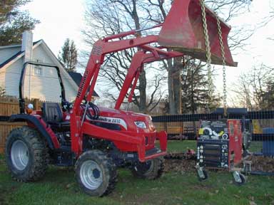

Apr 11, 2003 / Mahindra meets Lincoln #1 C cjw Bronze Member Joined Mar 23, 2003 Messages 72 Location Winchester, VA Tractor MAHINDRA 3510 Well this is the first chance I’ve had to put hooks on my bucket. It turned out nice, and I put them right to work. Attachments 254403-bucket holding welder.jpg 46.3 KB · Views: 439

Apr 11, 2003 / Mahindra meets Lincoln Thread Starter #2 OP C cjw Bronze Member Joined Mar 23, 2003 Messages 72 Location Winchester, VA Tractor MAHINDRA 3510 Here is a close up picture of the hooks. Attachments 254404-hooks holding chain-close up.jpg 36 KB · Views: 453
Apr 13, 2003 / Mahindra meets Lincoln #3 A Anonymous Poster Epic Contributor Joined Sep 27, 2005 Messages 29,678 Thats how I put mine on also. Works like a champ especially to pick up things that are off balance, like a sickle bar mower.

Apr 14, 2003 / Mahindra meets Lincoln #4 M Makers_Mark Silver Member Joined Jan 16, 2003 Messages 155 Location NJ Tractor Mahindra 2810 Looks great! Did you notice if the plate metal of bucket bent at all when you lifted? I was going to weld directly to the bucket but didn't feel there was enough steel. I will weld a 3/8" plate onto the bucket, then weld the hooks onto that.

Apr 14, 2003 / Mahindra meets Lincoln Thread Starter #5 OP C cjw Bronze Member Joined Mar 23, 2003 Messages 72 Location Winchester, VA Tractor MAHINDRA 3510 I havent noticed it bowing, but I try not to lift off the center eye.Ill pay more attention and see.
Apr 15, 2003 / Mahindra meets Lincoln #6 A Anonymous Poster Epic Contributor Joined Sep 27, 2005 Messages 29,678 I was going to bolt a steel plate to the top of the bucket for extra strength and weld the hooks to the plate. I like the idea of the 3 hooks!
