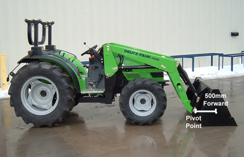

   / Mahindra VS Deutz Fahr #3
I think this is a really cool looking machine even though I have two red tractors.
Brian
