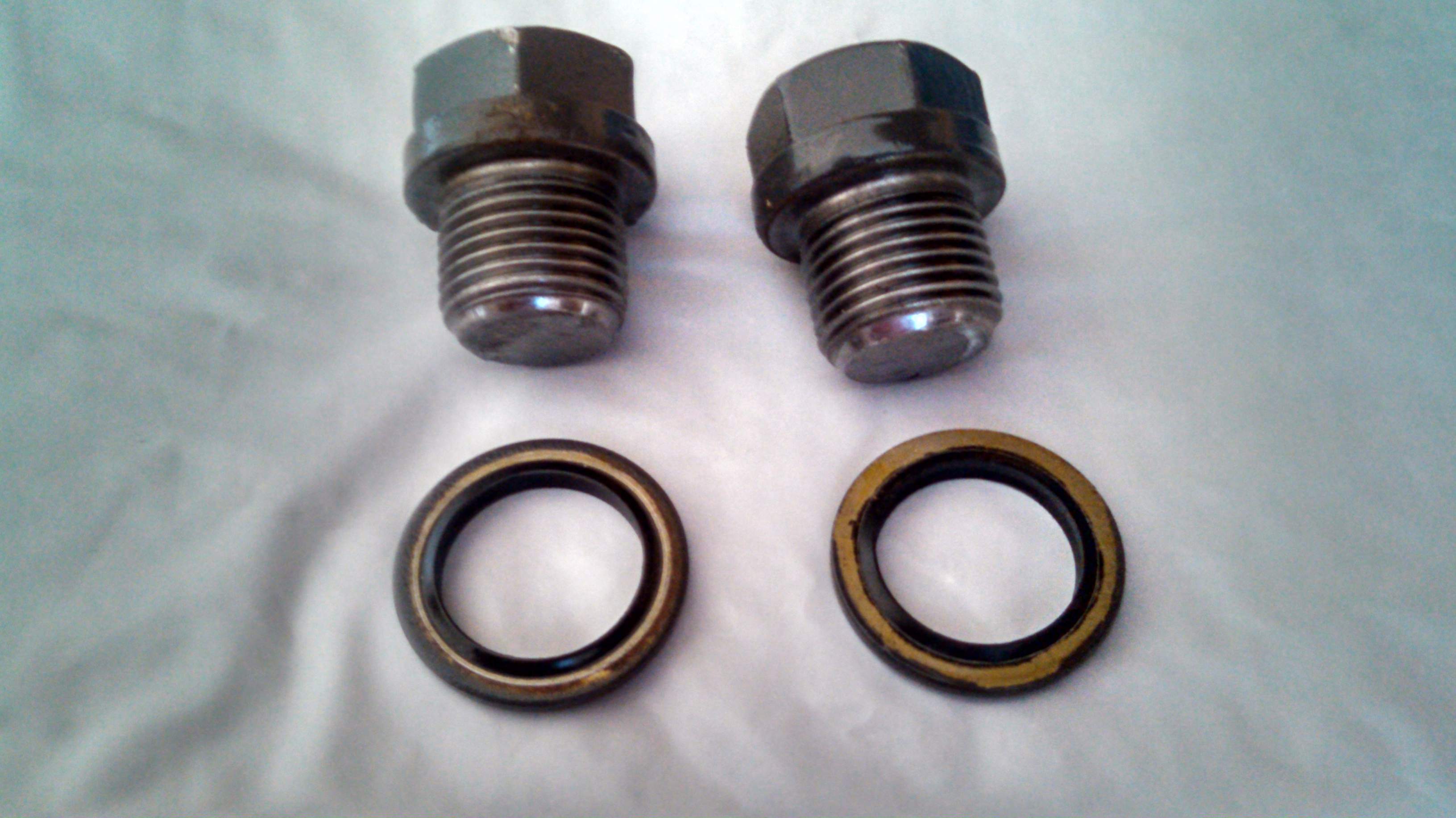

Remove the filler plug. It unscrews and is located behind the seat about the PTO shaft. Mine was red in color. Start with the upper 24mm fluid drain plug. About 5 gallons of fluid will come out - probably enough to overtop your 5-gallon bucket so be prepared to put the plug back in the hole until you can switch out the 5 gallon bucket and get your oil drain pan underneath to drain the remainder of the fluid out of that hole. After that you can remove the other 24mm fluid drain plug and drain that fluid. The 24mm fluid plugs and gaskets look like this:
The metal washers have an internal rubber gasket. They are probably not available from your local Autozone. I will probably try to replace them the next time I change the fluid because I always worry about leaks.

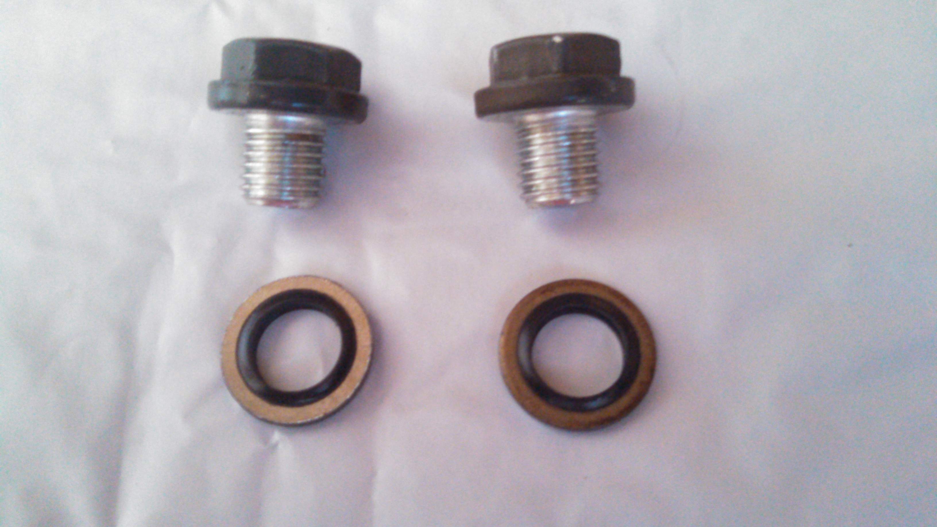

You are then ready to move to the two lower differential gear plugs. You can remove the 14mm plugs. The fluid will shoot out a pretty good stream so be ready with your pan. The 14mm fluid plugs and gaskets look like this:
Similar to the larger plugs, the metal washers have an internal rubber gasket. Again, I will probably try to replace them the next time I change the fluid because I always worry about leaks.

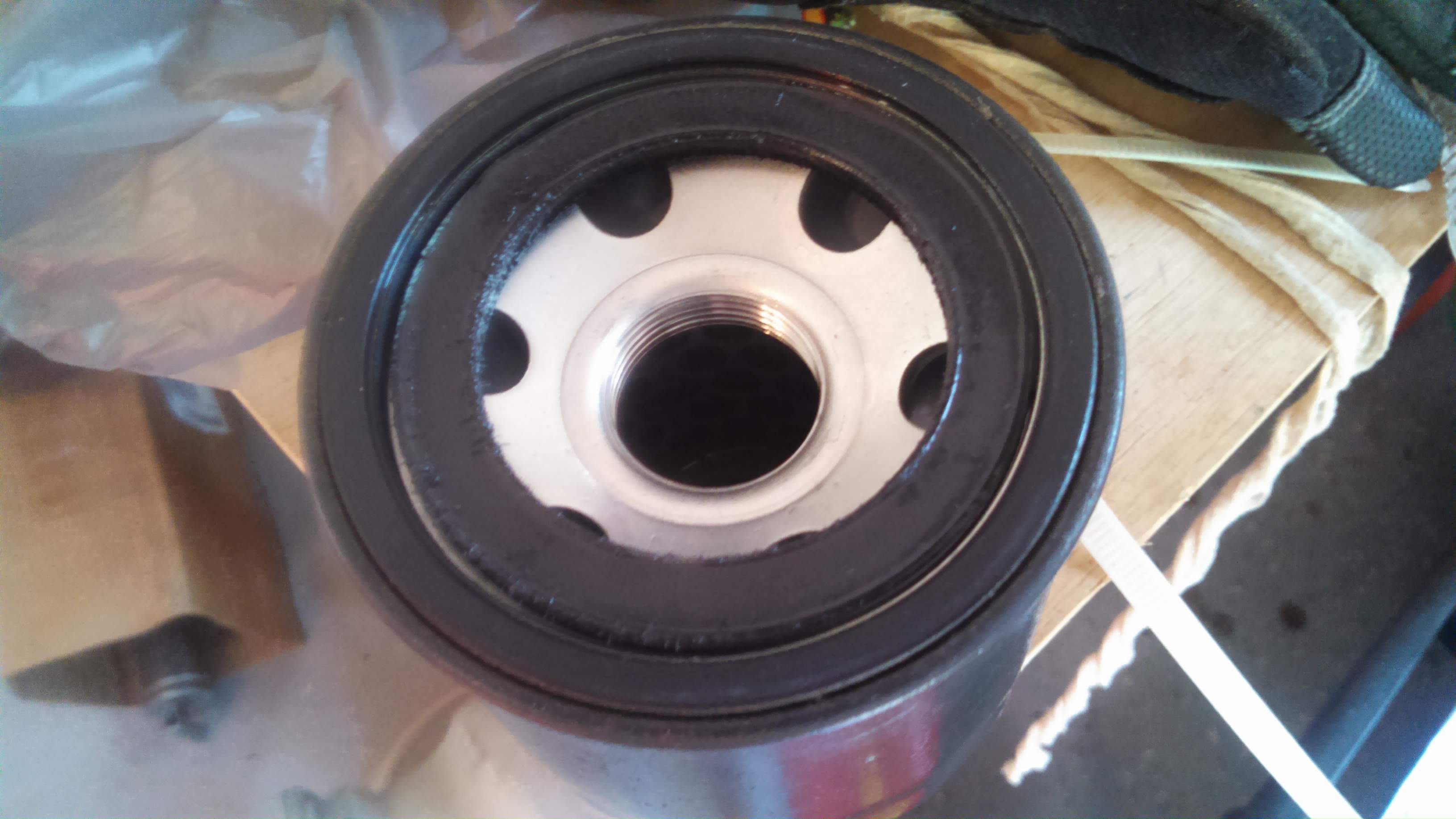

Now that you've got most of the fluid drained it's time to remove the filters. The smaller Return filter is by the step and can be removed with your Oil Filter Wrench. Once the fluid quits draining from the filter boss mount, you are ready to put the new filter on. Put a little fresh fluid on the rubber gasket on the filter to make the next filter change uncomplicated. Tighten the filter until it contacts the mount and then give it another full turn with your filter wrench. One last thing with your filter; take a permanent marker and write on the bottom of the new filter the date and the number of hours on your tractor so you can see it easily. That way you never forget when you changed the filter last. Repeat the process with the larger Suction Filter on the other side of the tractor except this one only gets an additional half turn after it contacts the mount. Note that this filter has a round magnet to trap any metal shavings, etc. It looks like this:
Mine had just a little fuzz on it when I took the filter off at the 50 hour mark. One nice thing is that you can take that magnet off your old filter and use it. I stuck mine on the end of my engine oil filter to help trap any crap that gets into the oil. Replace the four oil plugs. You're now ready to put in the new hydraulic fluid.
