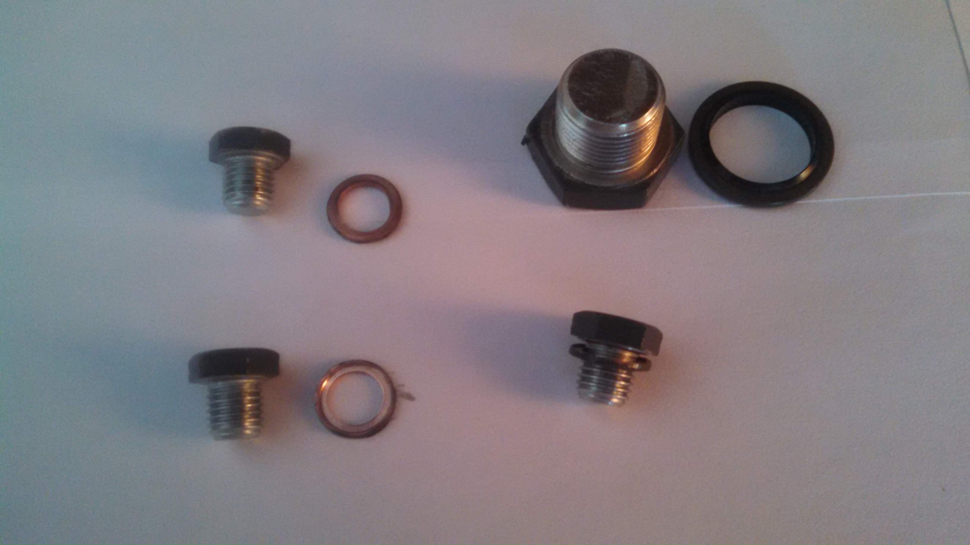

The three 14mm fluid plugs and gaskets and the 27mm filler plug look like this:
The 27mm metal washer has an internal rubber gasket. They are probably not available from your local Autozone. I will probably try to replace that washer the next time I change the fluid because I always worry about leaks. I did replace the three copper gaskets for the two 14mm drain plugs and the 14mm check plug.
