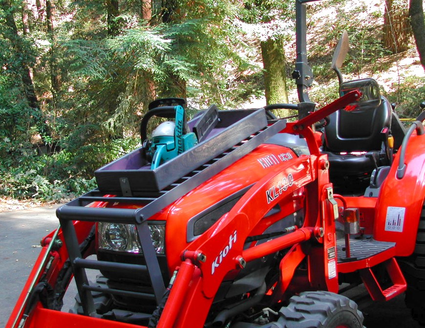

Are there any better grill guards available for these tractors? It has to be able to tilt for hood access. Maybe I will build my own but I will have to get some good ideas so it is practical and good looking.
Here is what I do to protect my hood and grille, as well as provide a
place for a large tool tray. It hinges up to open the hood for fueling.
JD sells a serious hood and grille protector for my JD4300....you can
see it in my 4300 rebuild thread.

Good idea on the grille/hood protector!
