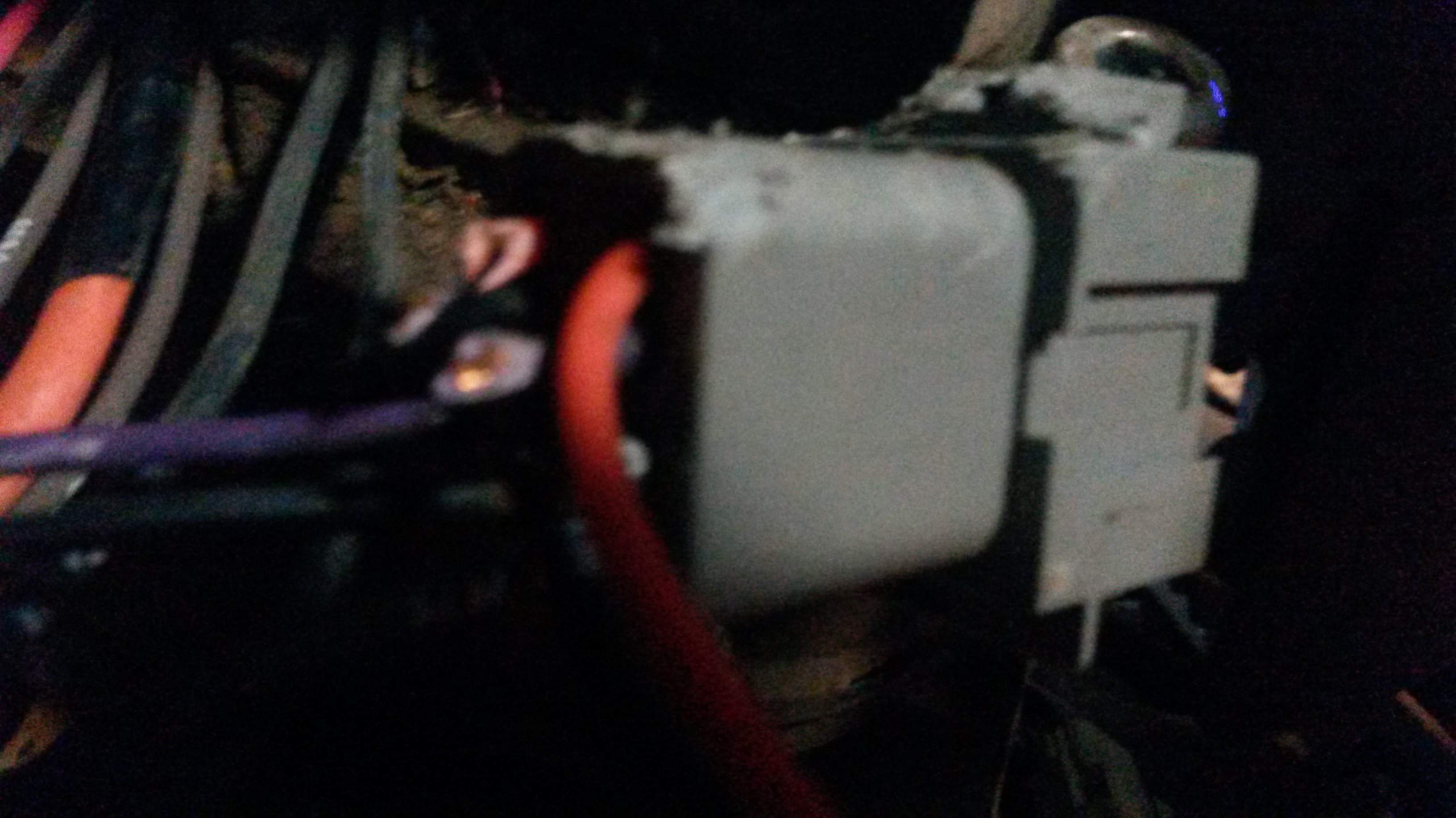

I have a NH TC35D with under 300 hours. Over the years it has not been uncommon to get on the tractor and find that a mouse has lunched on a wire or two. I would trace it down and splice in a piece. This time it's different. There was a major party on my wiring harness and it is SHREDDED. I can't believe the amount of damage. A replacement harness is around $800 and that is just for 1. And just splicing in a section of red wire isn't going to do the trick this time, either. I have gone so far as to order a kit of colored wire to color match the damaged wire. New Holland does a decent job of labeling the wires, so I should be able to identify both ends of the same wire at some point.
The biggest issue is that a number of wires are chewed right down to the termination point. The relay or gang connector is there with a small nub of wire exposed. On most I can identify the color of the wire, but that is all. I am no expert at reading wiring schematics. Most of these parts no longer have the P/N visible on them, but they may have 2 or 3 of the wires identifiable. How do I identify the parts that these are, and how do I connect to them once I do? Is it possible to remove a single wire from a gang type connector and replace it?

I have posted photos of the component that has me the most stumped. Note that there are 3 wires chewed too close to identify. From the other wires that I can see the markings, I think that this has something to do with the High/Low speed selection, but I cannot find any component in the schematic that shows all of the wires that I can see going to the same device.
It is a 2 part piece with the plug in side having 3 wires jumped to other ports. I show it both connected and disconnected.
What is it and how can I identify the damaged wires?
Any help is appreciated.

   / Major Mouse Wiring Harness DamageTC35D #9
At first glance it looks like a deustch connector. Here is there web site which will help you match up and figure how it comes apart.
https://laddinc.com/ It may say amp also they copied/reverse engineered deustch,s stuff, however duestch pins and sockets should work. If it is in fact a duestch/amp life is good. I need better pics of the plug and socket end. looking directly at the wires and where it plugs in on both sides. there should also be some markings on it.
Now there are different ways at going at this, first off do we really need to know what those wires do if you repair them? Also those plugs for the most case are just for assembly, so you could just butt splice/replace the plug all together.
These are the brand butt splics I use
Perma-Seal? Terminals - Molex
They shrink at a lower temp and seal around the wire and are a perfectly acceptable repair. I use a heat gun, don't use a lighter Soldering wire where you are is not the way to go, they will work harden and break. Next when you replace your wire you must use a good automotive rated wire, sae j1128 specs. Looking at your wire that looks like 14 or 18 awg. If it was mine even though I have the plug and connectors, if it was not going to something I was going to be replacing soon. I would butt splice everything around it in a heartbeat.
   / Major Mouse Wiring Harness DamageTC35D #10
There is a fairly good chance there is insulation clamped by each terminal. If you get the terminal released, you will see how the crimp is usually two crimps. One on the wire and one on the wire and insulation. Prize open the insulation and wire and you may deduce the wire color. Take pictures as you go.
