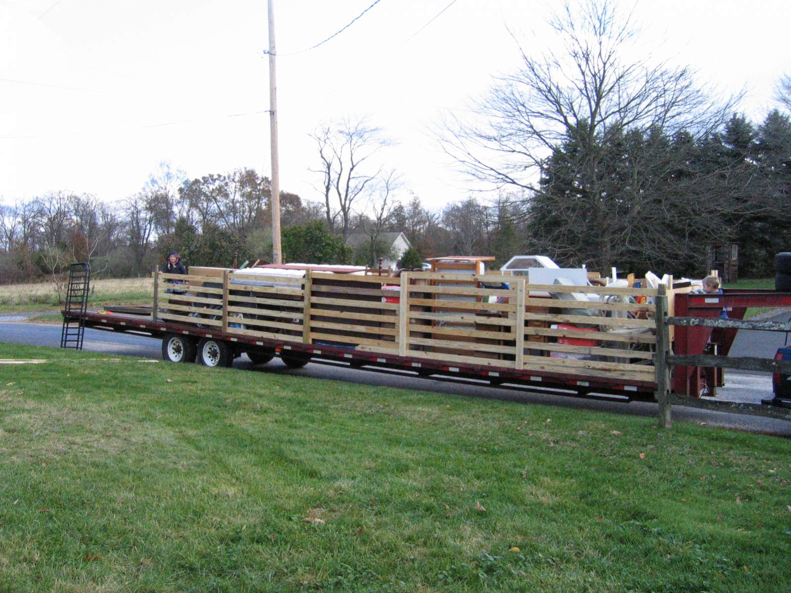

I am in need of a heavier duty trailer that I can: haul my tractor when needed, logs, lumber, cars, hay, other equipment, etc. None of these needs are for a regular basis, but I find myself needing one too often to keep borrowing from others.
I have a good friend that lives about 2 hrs away that also needs a trailer, mostly for car and equipment hauling.
This same friend is currently storing a 40' gooseneck/5th wheel deckover trailer out at our farm. Its a tandem axle, single wheel set up. He got the trailer along with other equipment in a package deal. Neither of us really want to use a trailer that big. I used it twice, and don't care to again.
I have heard that trailers this size don't hold their value as well given their limiting factors. So selling or trading it may not be the best option. With both of us needing trailers about 1/2 this size, is it crazy to consider making 2 trailers out of it? I have a 5th wheel hitch and he does not. So I could make use of the front half, and he could make use of the back half.
I'm going to make some calls to see what might be offered for it by a dealer and then go from there to see if we think its worth our time to move forward. Just wanted to throw it out there to see if anyone has looked into something like this before.
I guess one way of looking at it would be:
How much would a 20' deck be worth by itself? Because that's all we'd be left with minus the front metal.

do you have the equipment and skill to do this mod?
Its going to take significant welders and cutting tools, plus more than just hobby welding skill to make those 2 trailers.
5200lb axles are about $400 a piece. Figure alxes, springs, hangers etc for the GN (front half) is ~$1000
Id likely add a 4' dove to the back of the 20' GN... (thus 24'GN)
that leaves the other half to make into a bumper bull. Likely go with a 4' dove on that one also, plus tongue/hitch etc.
If i had to balkpark the expense Id guess you'd have $4000 in cost to make to trailers (if you could do the work yourself)
SO ya in the end i see the finished product being worth $2k each...

Id say go for it, I did one like that for some friends. . In fact it was I denticle to that one almost. He had gotten it from a furniture factory. I started by cutting the deck off a where the third upright to the right is. and removed 3 feet of decking from the rails in that area. I notched the frame and brought the main rails down for a dove tail The way the suspension was we had to unbolt the axles and suspension and turn them around to face the former rear end. Then took the ramp mounts off and welded in a new Pintle hitch and tongue. On the other end we left the GN and measured from the rear and put in a set of tandem dual axles and suspension. You never could tell that anything was ever changed.
