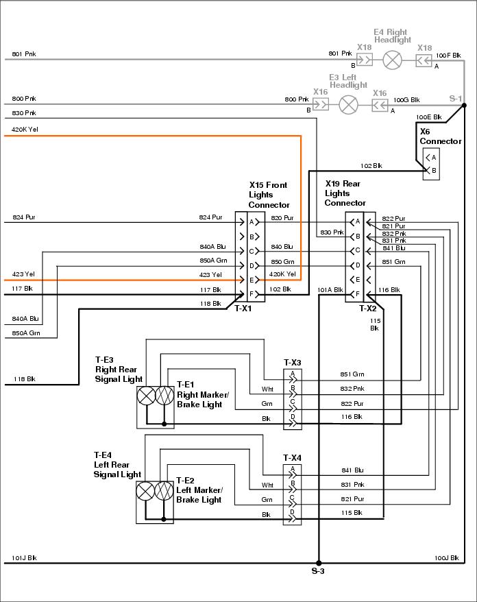

I just installed the deluxe light kit on my HPX and noticed that only the rear tailights come on with the first switch setting and not the front clearance lights. I noticed that the front clearance lights have a dual fillament bulb and thought something was wrong since they weren't working until I called Deere. How dumb is that? So has anybody made the front clearance lights work? They have three wires going to them and am sure it could be done if I knew what wire to tap on the switch and light. Any help would be AWESOME!

The deluxe light kit adds orange clearance lights up front in the place of the yellow reflectors. I noticed that they have a 2-way bulb in them, but only one fillament is used for the hazards and turn signals. The kit also has you install a new headlight switch that is a 3-way. The first setting is off, second setting is like a parking light feature but only the tailights come on. The third setting is the headlights. So I'm wanting to make the front clearance lights work on the second setting with the tailights, the way it should have been. Hope this helps clarify. I've noticed a couple others have made the same comment about this on other posts, but was wondering if anyone has figured it out yet. Thanks.

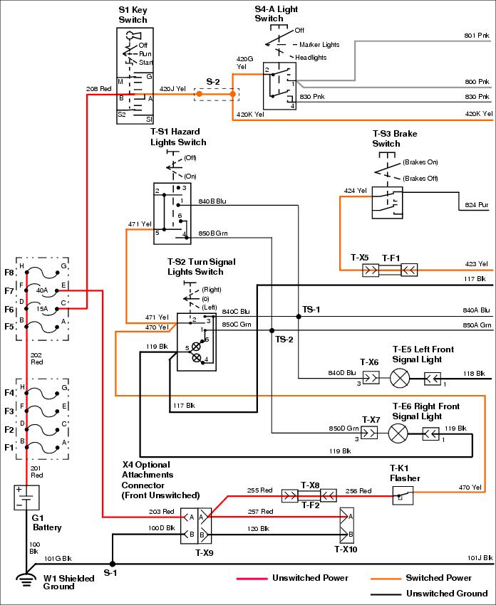

I'm going to try to attach the diagram. The lights in question are only used for turn signals right now. I never looked to see it they would support being a running light also. If it does have a dual element and three wire harness it could be possible. The wiring diagram doesn't show any extra wires.

830 pink circuit is the marker circuit from the light switch. You need to find if it comes out to the X15 light connector. If it does than connect your wire there if not then get it from the rear connector. Hint print he pages out so you can see them.
