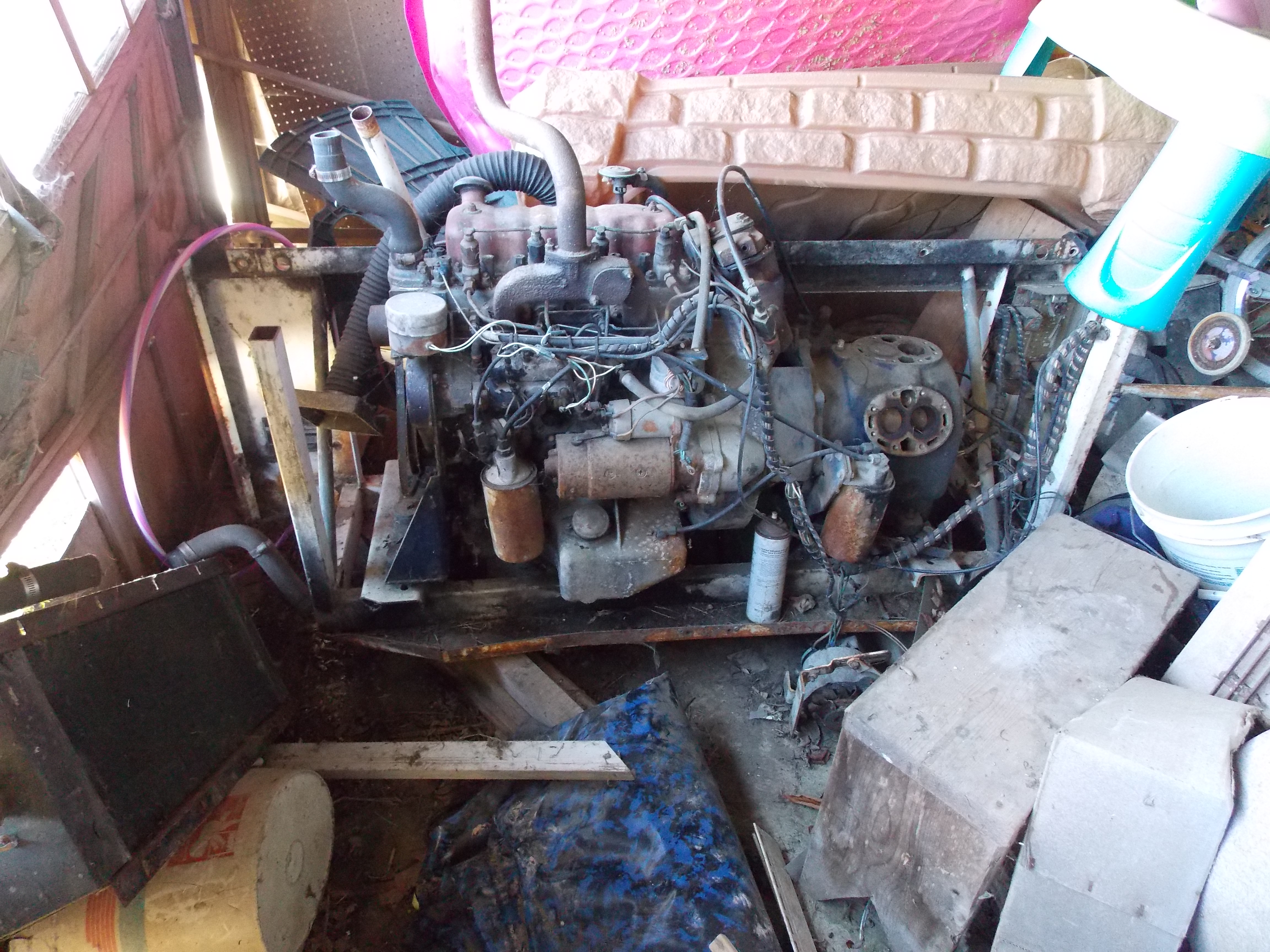

Here, is a photo of the Reefer Engine as I found it as a barn-find.
I know the history behind it, and know it has been sitting for years and years, but thankfully it is in really good shape.
You can also see from the photo that it was the chiller that was disassembled, which is pretty common with these reefers; the chiller break long before the engines do. That appears to be the case here.

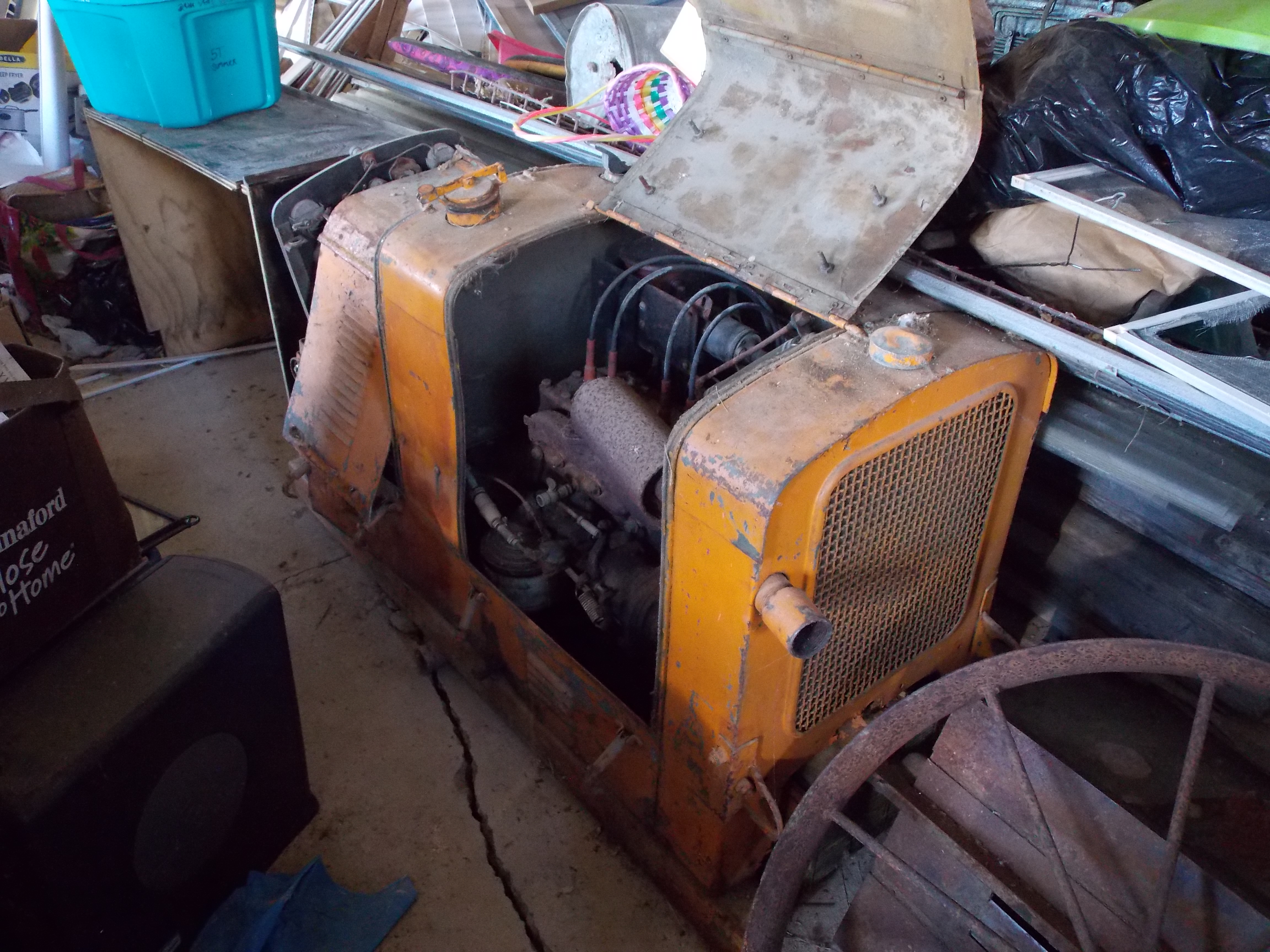

This is the 1942 3 phase/1 phase generator in which I am borrowing parts, in order to get it to work.

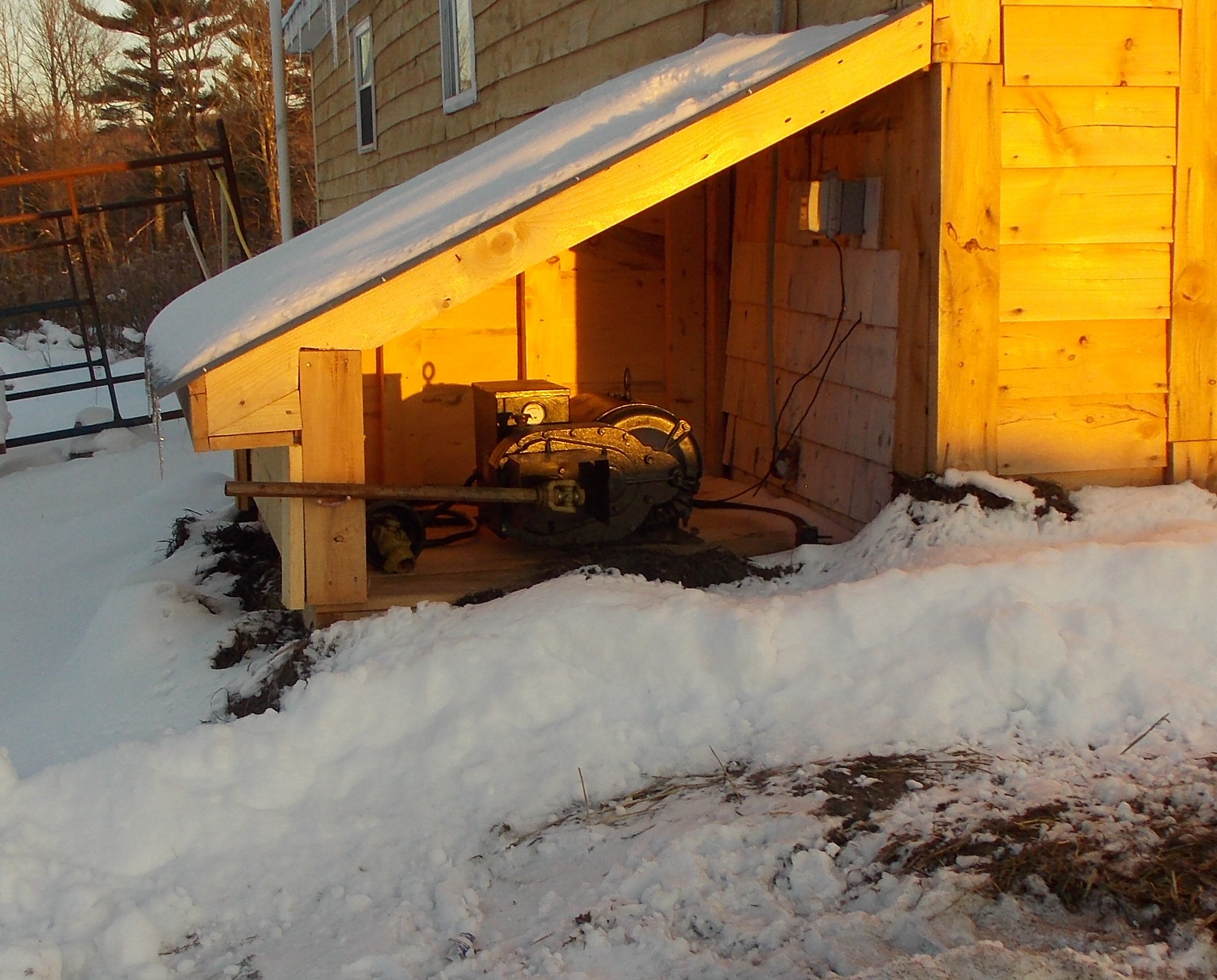

This is the 20 KW Pto generator I have to spin behind the Perkins Engine...

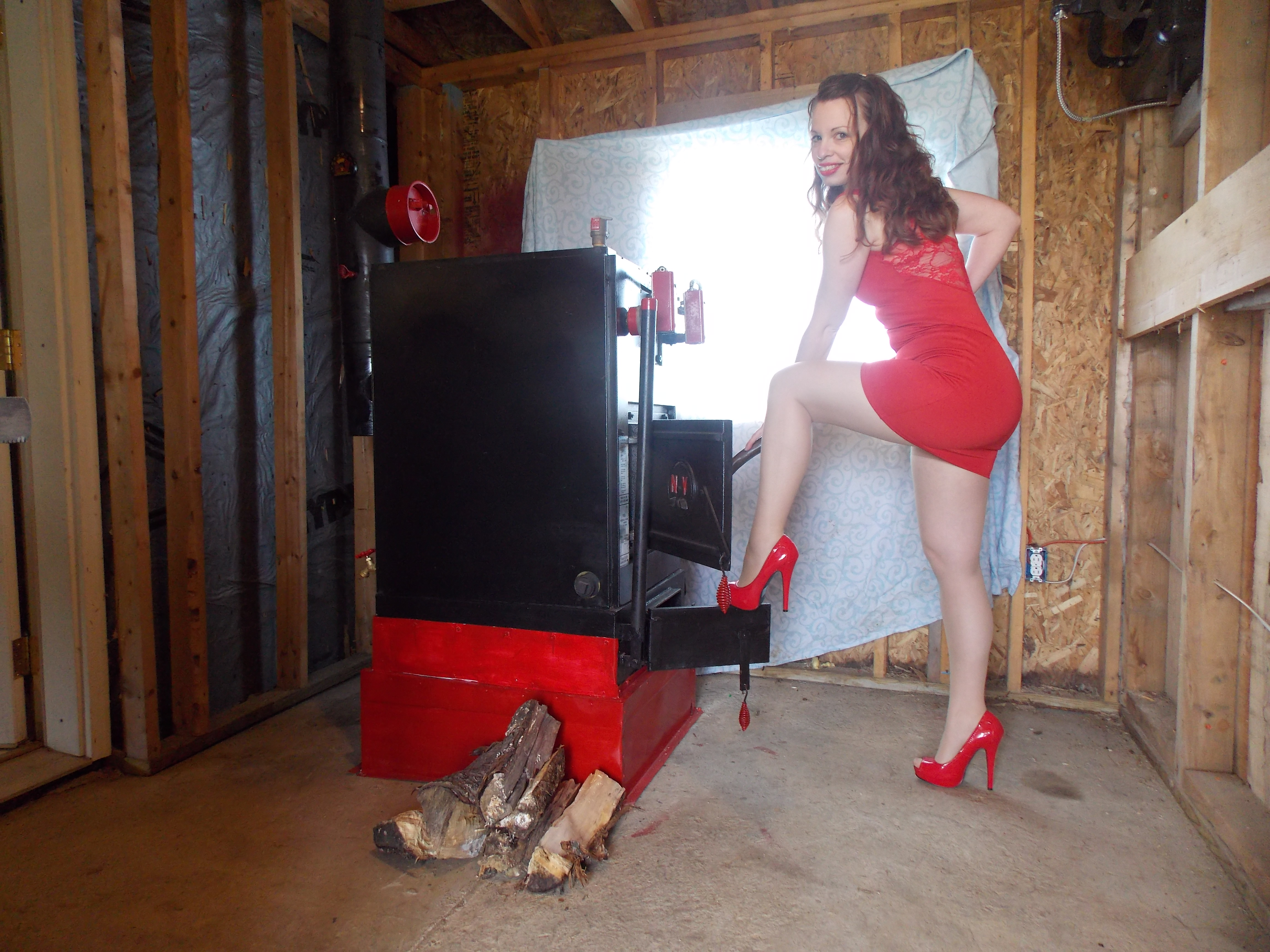

And finally, this is the Firewood/Coal boiler that is sitting next to the genset.
The good thing about the way this whole thing will be set up is; if the engine is down, or the firewood/coal boiler is not being used, the propane boiler in my house will come on, and circulate warm water back through the boiler and engine, and keep them always at 100-150 degrees. That will make the engine easy to start anyway. (Naturally, being a reefer engine, it has exceptionally powerful glow plugs).
