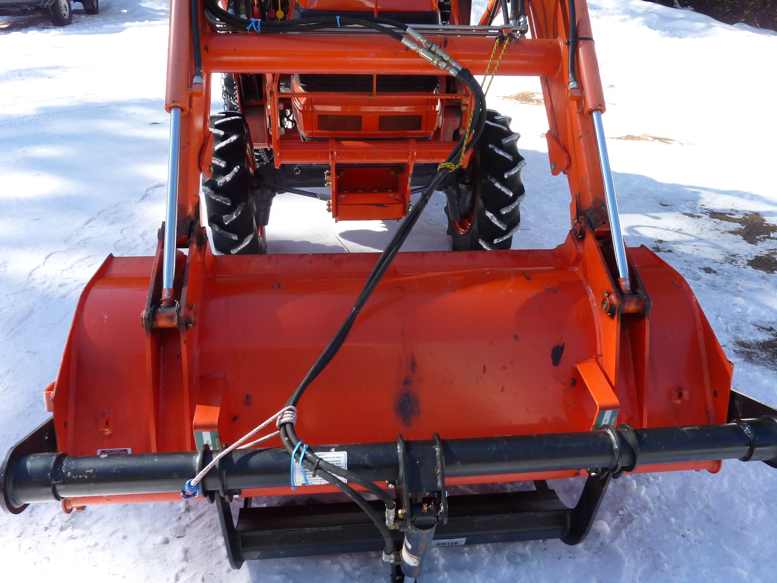

I also posted this question as part of the Grapple Rake thread but wanted to get this question to the larger audience. Attached is a pic of the hose section in front of my tractor that connects to the grapple. It turns out that the hose section is too short to allow the full motion of the grapple (ie. roll down) so I have made up longer hoses but have not put them on yet. How do you manage long hoses like this? When the grapple is rolled all the way back, there will be 5 feet of hose that needs to stay out of the way of pinch points or loader quick attach handles etc. I need to set up some kind of spring tension system to pull the hose safely out of the way when the full length of the hose is not needed. If you have done this kind of thing please comment and remember pics, pics, pics. Where do you get those long very loose springs that I have seen on other hydraulic equipment to help with slack hoses?

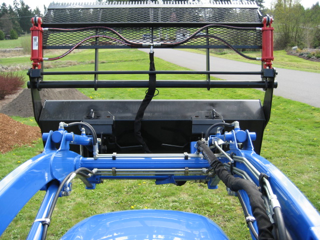

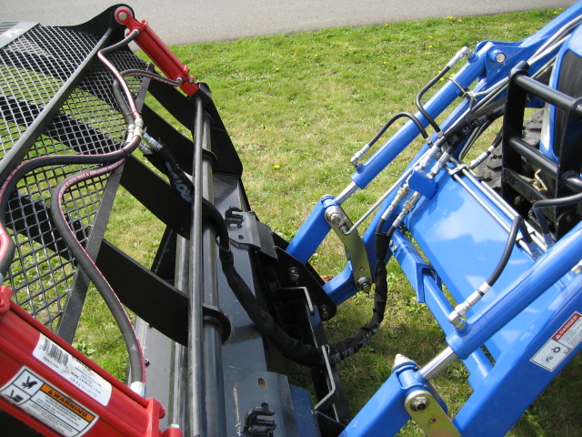

Bungee(s) can be used but even they can be problematic if too tight or too loose. I would suggest routing your hose to the side of your loader rather than hanging it over the middle support. You can then keep the hoses running to your grapple horizontal to the grapple and the grapple will provide protection to the hoses.
Here is a pic of how mine are routed

Chuck,
1bush2hog shows a pretty ideal routing of your grapple hoses to minimize problems. I wish mine were routed in a similar fashion. I have a screen and a couple of routing loops that keep the hoses centered over the center spar. Good Luck so far, but I try to keep my eye on them when grabbing brush.

Thanks for the pics guys.
If I run my hoses like 1bush2hog it would solve alot of the problem - at least not require such a long piece of hose between the grapple and the quick connects. I also like the idea of a bracket to hold the quick connects. This would protect the quick connects and eliminate paint scratching from dragging the QC's across the loader parts.

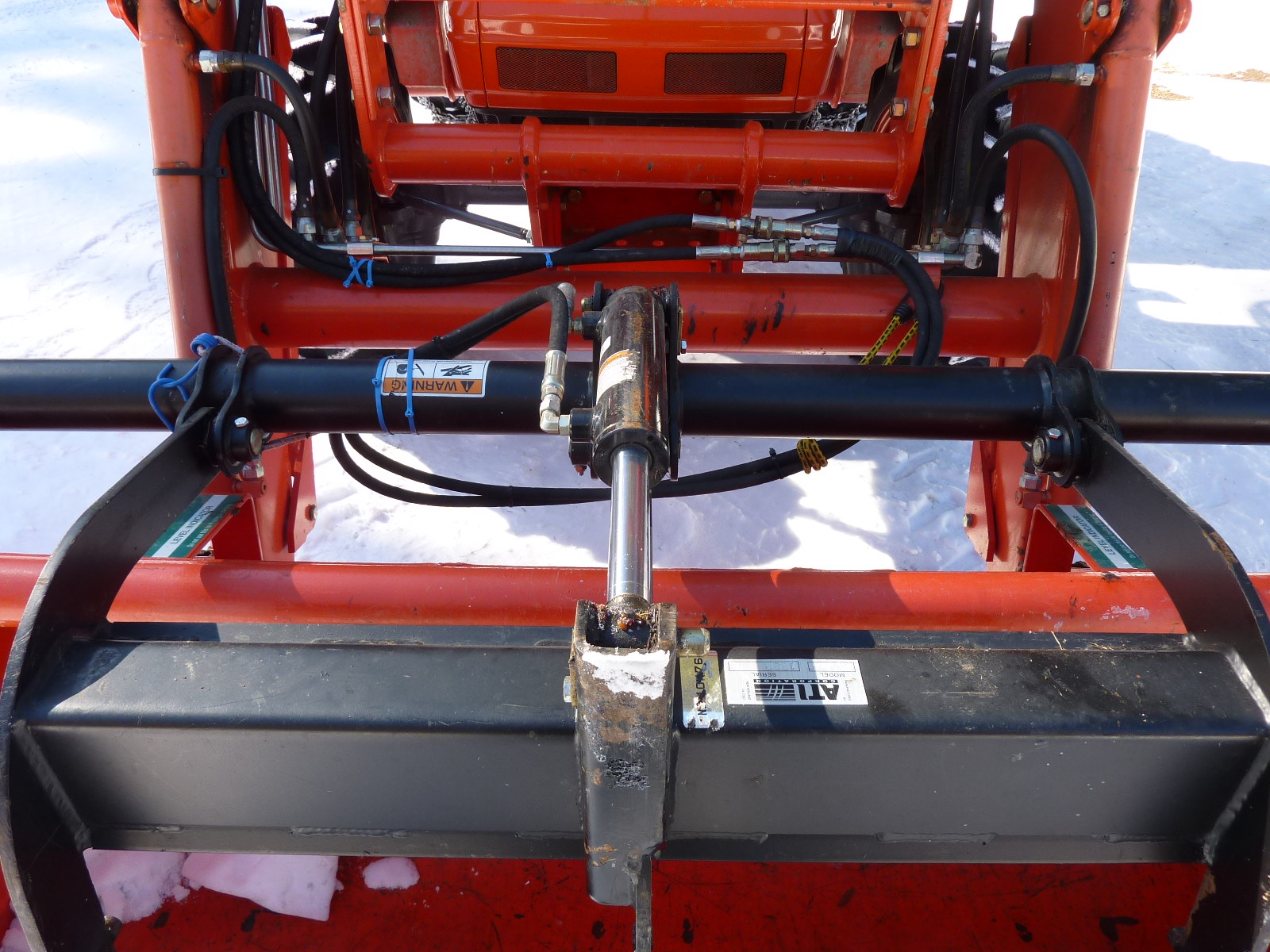

Your springs will probably be better than my bungies. But they work and the idea is the same.

I use bungies too...even if the thread is 7 yrs old... I wrap one long one around the middle of the hoses and secure one end on each side of the cross tube.
