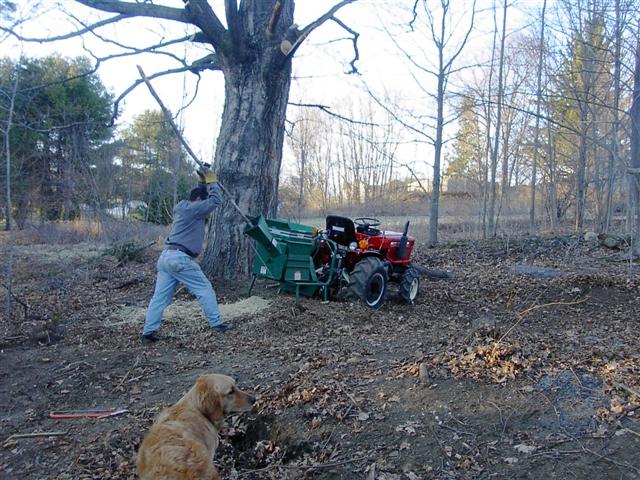

I'm with Tom here. I bought a nice used chipper/shredded a few weeks ago with manual feed. It has far exceeded my expectations. He is right, old dry oak can really rattle your bones when you are feeding it. Really i guess it all comes down to A: money , and B: how many hours you will be using it. I suppose if money were no object..... i'd have auto feed. Sure must be effortless. However.... my manual feed chipper works great. If you feel the used one you are looking at is a fair deal... buy it !! I made a car sized pile of brush a small mound of mulch in an afternoon !!
Scott
