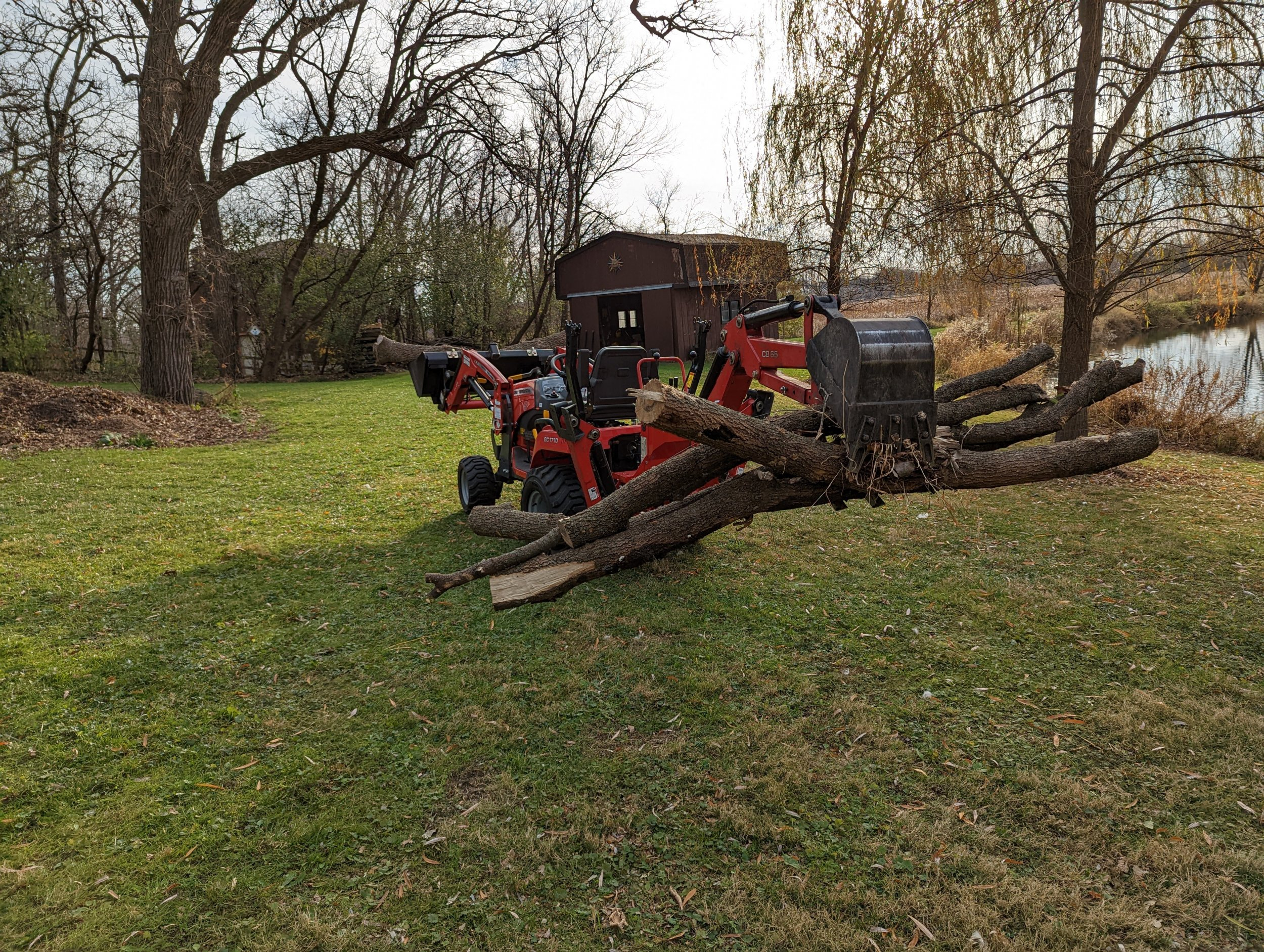

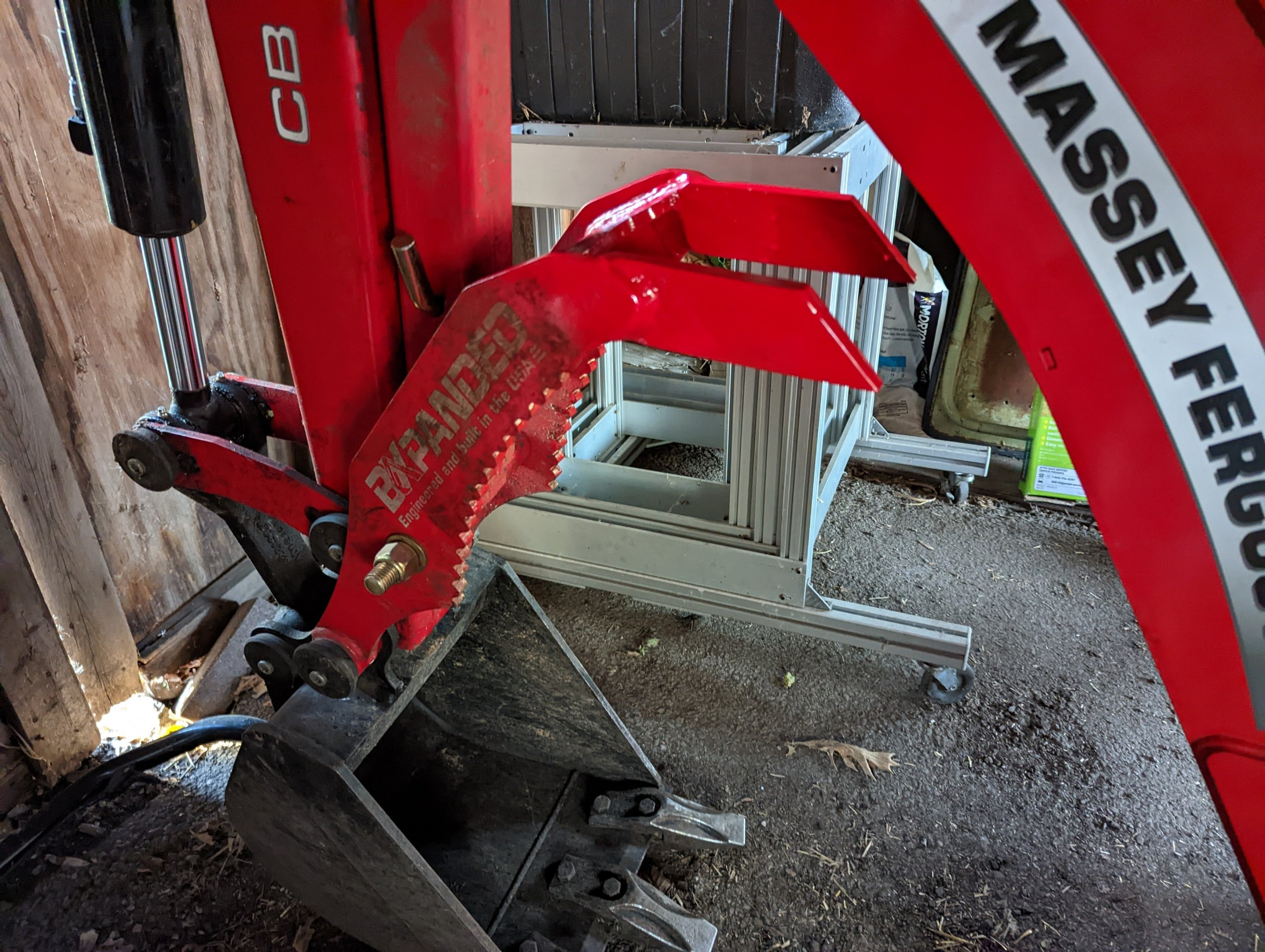

Does anyone sharpen the teeth on their manual thumb? My thumb seems to drop half the logs I try to pick up. The logs just slip right out.
   / Manual Thumb #2
Welding tusks on my thumb solved all that for me.
   / Manual Thumb #3
The curl should have enough psi applied to keep the log pinched in between the thumb and bucket of the backhoe.
I have seen where somone drilled an extra hole in the manual thumb bracket to have the thumb spaced for smaller objects.
No, I haven't and wouldn't sharpen the teeth as the hydraulics have enough force to grip objects.
Must be something going on here that is out of the ordinary?
@GeneV solution looks like a good fix.
   / Manual Thumb #4
I have no problem with my LS grabbing big or small logs.
   / Manual Thumb #5
No problem with my Kubota BH92 picking up logs or rocks. Have you tried a different setting?
Andy
   / Manual Thumb
OK, it sounds like an operator error. I will get me a couple logs of different sizes and practice picking them up with different settings. Thanks!
